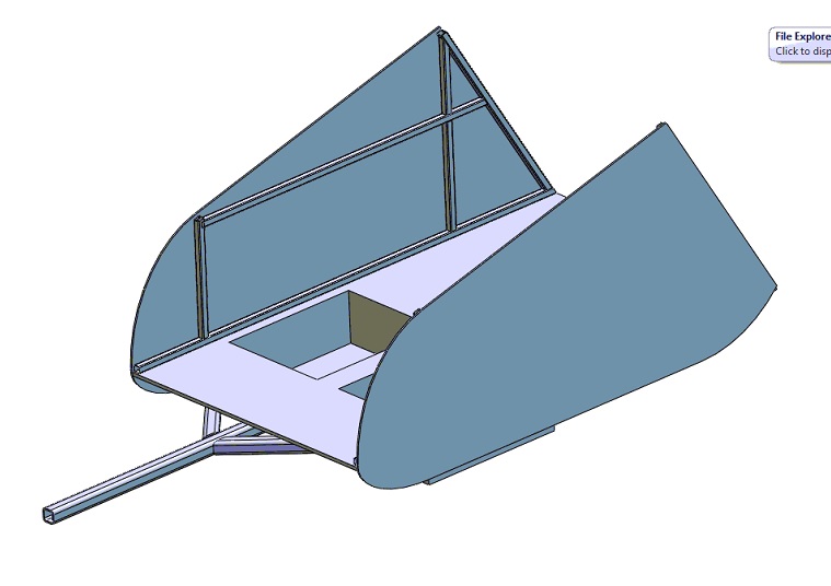

This is why I'm reading around a lot on here before I get into any actual construction. I'm afraid that as a mechanical engineer by trade I'm conditioned to overbuild things at first glance and then go in and figure out how to save weight by subtraction.
My biggest concern is wind load on the side of the trailer, catching it like a sail and tearing the top off. I'll keep reading about what the foam guys have done though, as their tears are much larger in surface area than what I'm looking at.
BTW, with the very early model I had built, it looked like I could likely get away with a single 12' 2x4 to cover all the framing I was looking at (minus the roof/hatch, which would've used much smaller beams).

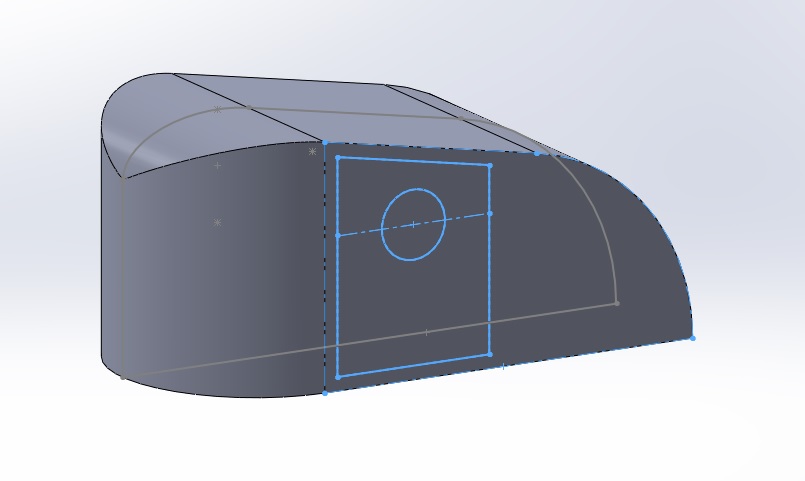

of course, now that I read about how easily the foam is bent, I'm thinking I could do all kinds of fun stuff with the shape of the front end that would add usable head room (when lying down)...
edit: now that I'm considering actual construction, it might be more practical to do the front at an angle rather than as a radius.
