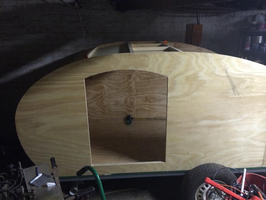

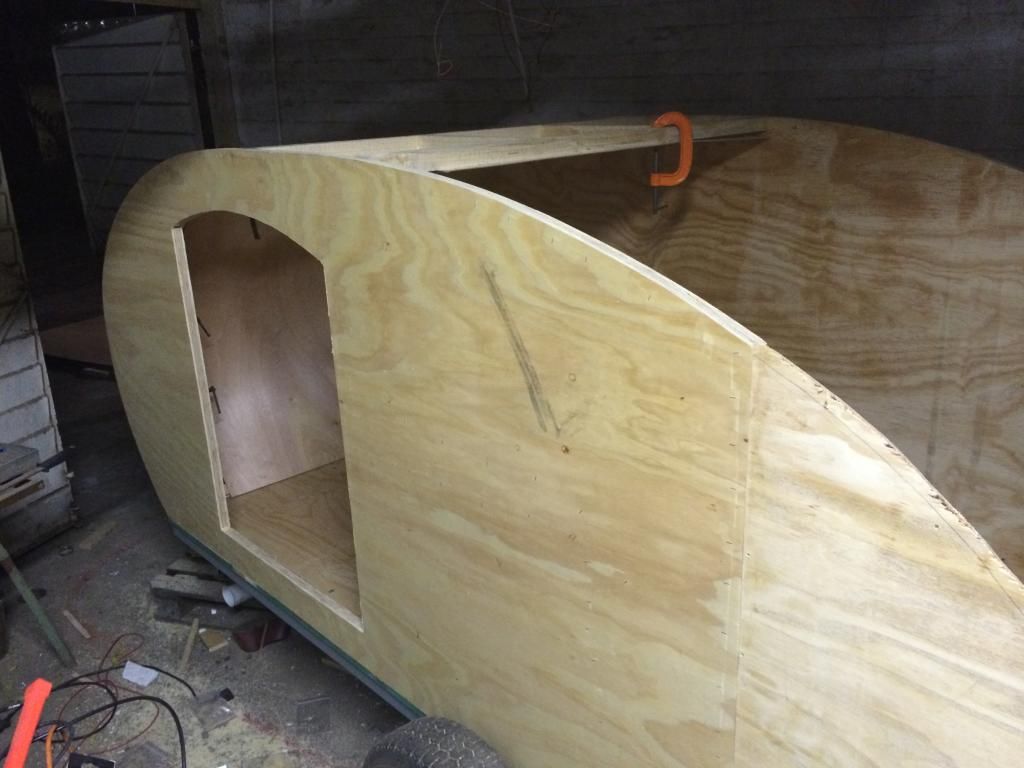

Some progress on the frame has been made and the side profiles cut, I ran out of wood for the ends of the tear, will pop in tomorrow and finish it, most of this is prep and the boring stuff :D

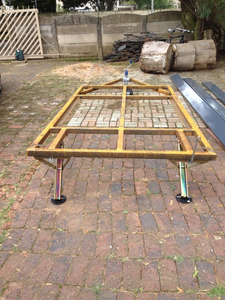

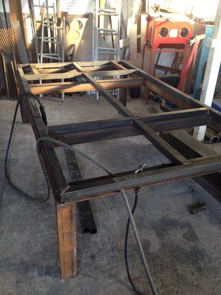

Frame from 50 x 50 x 3 mm square tubing, nice and strong
Stabilizer jacks and jokey wheel, for some reason I don't have a pic with the axle on it, there is a rub ax on there, 750 kg max load is I think I should be ok. The frame as it is there with the axle and floor comes in at 197 kg's.
1st cut of the side walls, I'm cutting all 4 walls at once from 6 mm ply, going to have the walls from 6 mm sides and 18 mm plywood core skeleton and insulated, we don't get cold here so much, but I'd like to keep it as cool as possible.
Planing to skin it in 1.6 mm brushed aluminum, was hoping for stainless but can't spare the additional 100 kg

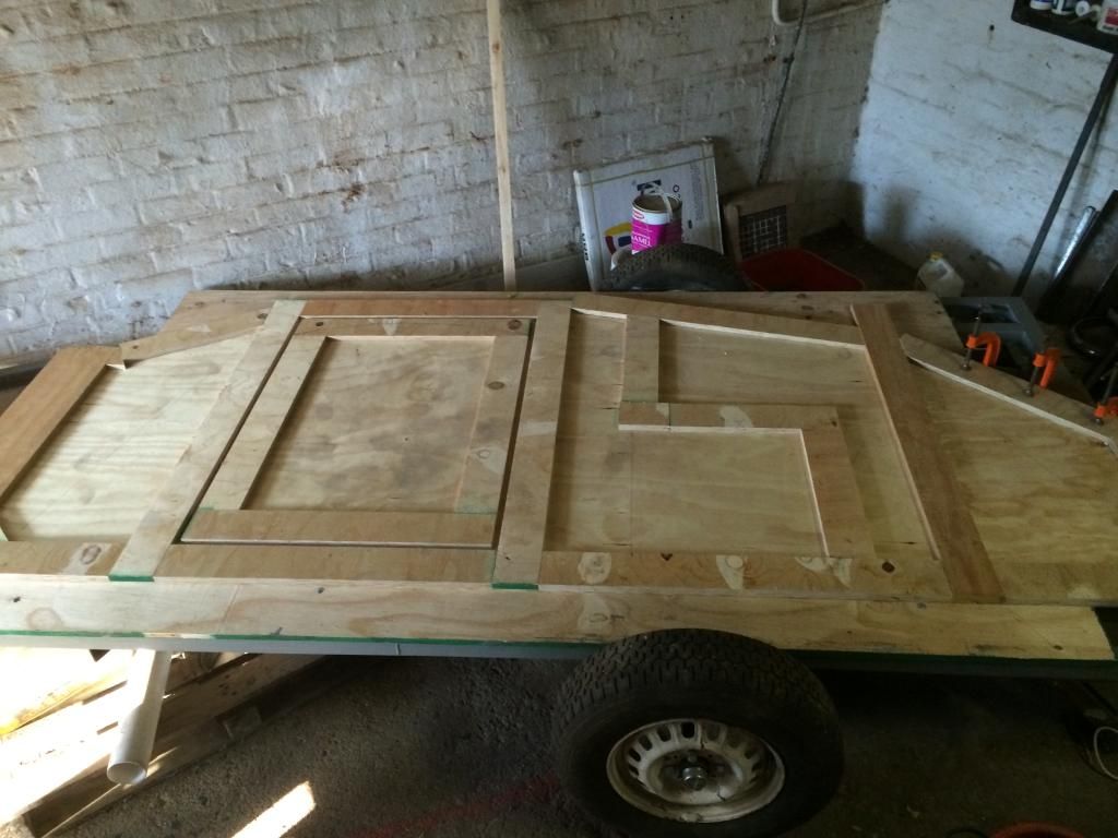

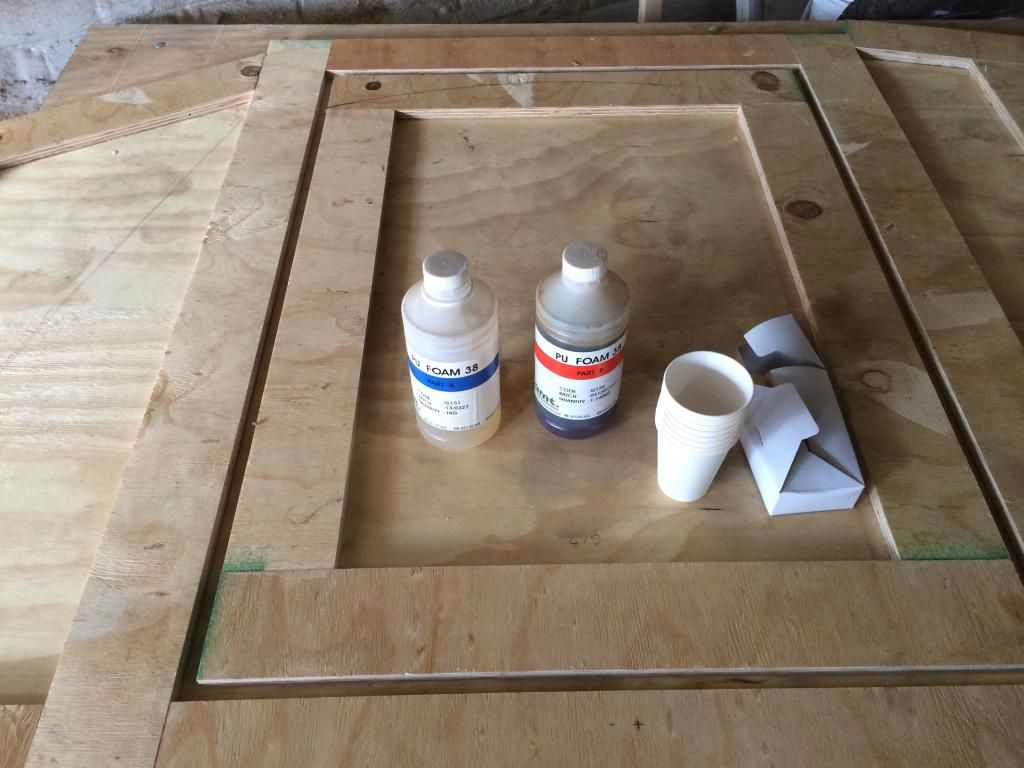

Did the skeleton out of 18 mm ply, I tried to make sure the the back wall, storage and all have bracing in so they don't attach to a hollow part
Apocalypse Boy
Posts: 5
Joined: Sun Mar 02, 2014 8:42 am
Re: Grumman 2 from sunny South Africa
Postby Apocalypse Boy » Sun Jun 08, 2014 1:54 am
The initial plan was to use pu foam and fill the voids
Apocalypse Boy
Posts: 5
Postby Apocalypse Boy » Sun Jun 08, 2014 1:59 am

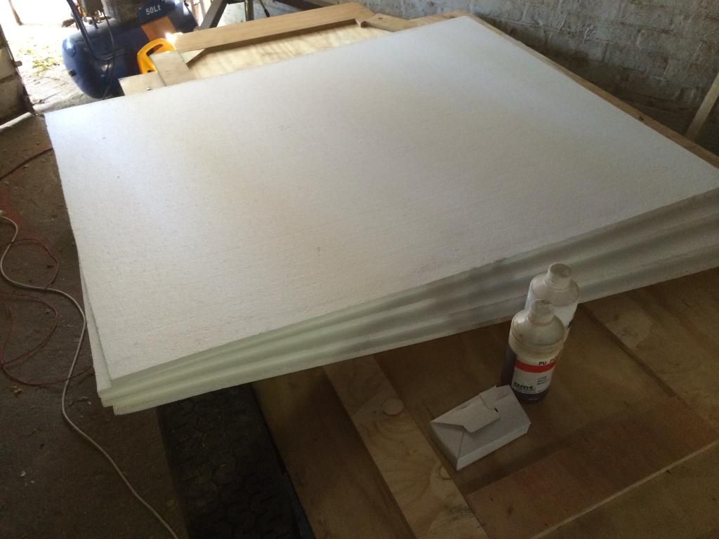

But after the 1st trail run, the foam is nice and rigid, but it doesn't expand even, so off to plan B and good old styrene

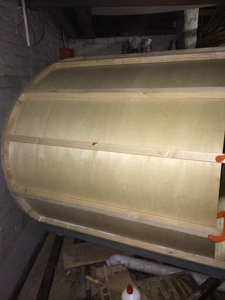

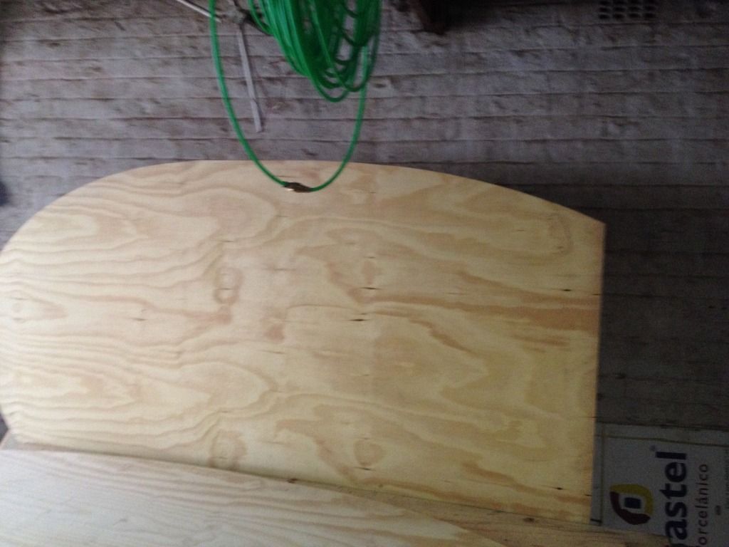

Started with plywood inner skin, it went a lot easier than I thought 8)
What do you guys do other than paint/varnish ? I'm thinking vinyl ala 50 chevy ?
