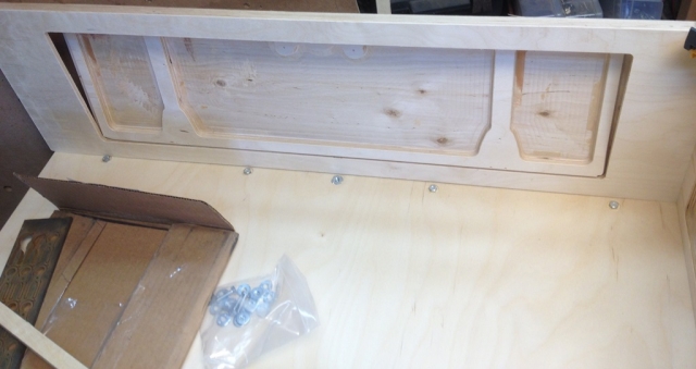

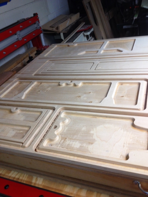

I was able to get the floor almost completely done I just have to cnc the top side for the T-nut pockets.
The plan right now is to make the box from 3/4 Baltic birch plywood. It will be pocketed out as shown to reduce weight. My calculations for the floor was that I saved 15 lbs by pocketing the floor as shown. The floor ended up weighing 19lbs. If I were to to it over I think I could get it closer to 15 lbs but I would have to be careful to not punch holes in the floor.
118465
118464
118463

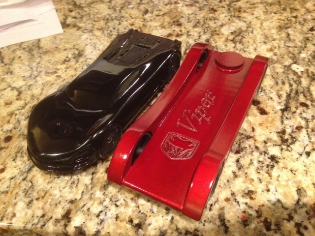

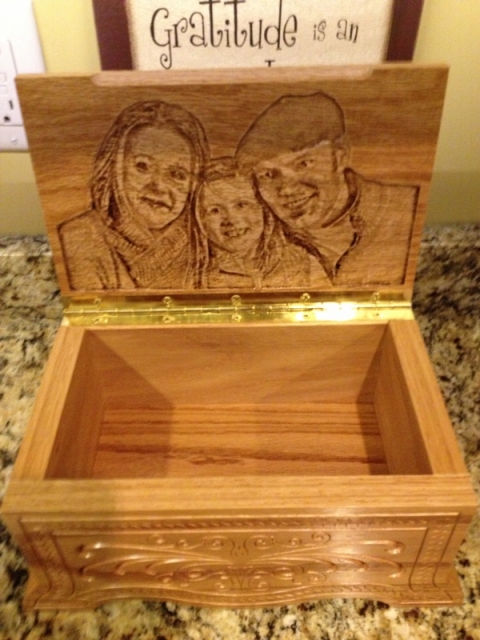

My CNC router is a CNC Router Parts standard 48x48 with their Nema 23 package. If your serious about getting into it I would suggest starting with a small router (something like a microcarve) But purchase a decent controller and stepper package (like the Nema 23/gecko 540 package that CNC router parts sells) That way if you ever decide to build a bigger machine some day you have parts you can directly swap over. Starting small gets you into it cheaper and a good learning platform that you can take with you when going big. Like anything Cars, bikes, trailers sky is the limit to what you can spend it gets expensive in either time or $ but most times both. Its pretty frustrating when you trash a $40 cutter inside of a minute. I tent to use my router more that anything else except for maybe a cordless drill. Sometimes I'm sure I could do it quicker by not using the router but what fun would that be :twisted:
Here's some stuff I've made...

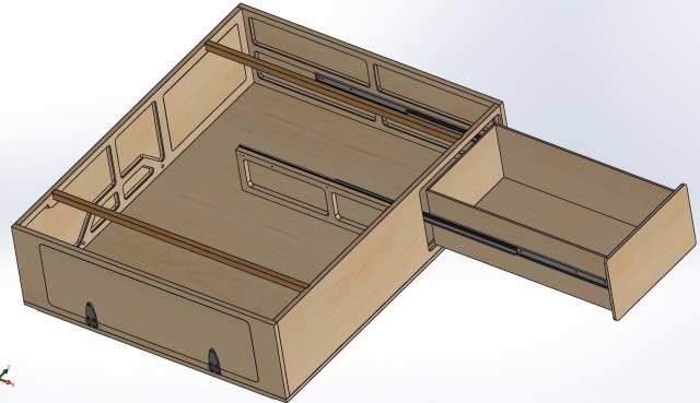

I built most of the trailer in solidworks. Not that I needed to but more to brush up on my skills in that program. I'd say its looking pretty good.
I also ordered my wood sealer, primer and paint from the boat supply house. It should turn out real nice because a friend is going to help me spray it. Hoping it turns out looking like auto paint when I'm done.

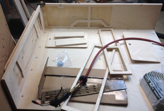

Got my tent unit yesterday. This thing is pretty nice. I'm pleased with the quality of construction.
Got the front and the other side cut out. Just need to do the door cut-outs on the sides and I'm ready to dovetail the box together.

Postby vtx1029 » Mon Apr 14, 2014 6:42 am
Made some decent progress this weekend. Got the box dovetailed and glued up, then cut biscuts for box to join the base.
Mini Me got put to work attaching the floor to the frame
All glued up no turning back now...
Top strut bars and gussets glued in place.
Filler pieces cut and fitted to the tent support bars. (I really wasn't planning on this step but that's what I get for building things before I have everything. My plan was to just use the cross bars I had in place but I found that because it didn't support the tent out to the edges it seemed to flex too much so I decided to use the bars that came with the tent. Oh well)
