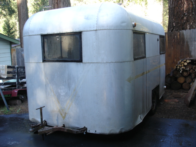

I had posted some info on this project on the Canned ham/bread loaf forum, but this will be my "official" journal on it. This is a MobilGlide Globetrotter from '47. They only made the MobilGlides for 3 years '46-'48. It was post war construction so used a lot of technology from the aircraft industry in WW2 and probably some laid off aircraft workers. It's 12' x 7' x 6'4" interior height, steel frame, aluminum body with aluminum structure and interior. Windows are the older Marvel type with copper screens...can't wait to buy that screen...ugg.
Fully complete, they only weighed 1300#. It has individual torsion stub axles with a shock. Both sides are trashed. The tongue is also cracked and has been repaired in the past. The exterior corners are spun aluminum. They turned a large bowl of flat material with a tool then cut it into quarters. The corners are much thicker than the rest of the skin and the tool marks are left in the corners.

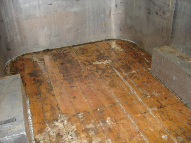

This trailer was used as a tool storage and probably a mobile work shop at one time. Extra 110 wiring was run across the ceiling, and the floor was pretty dirty from spilled oil hydraulic fluid etc. I removed the last remaining floor mount cabinet today and stripped out all the existing flooring. I was surprised as it has a solid clear fir sub floor, minor rot at some of the edges to replace. On top of the fir which was varnished, was tar paper and an overlay of masonite with older style linoleum over that.
I got dimensions for a new flexiride axle on it, will get some new artillery wheels ordered, and have a plan on welding up a new tongue on it. This will certainly be a keeper for me. Thanks for watching. Doug

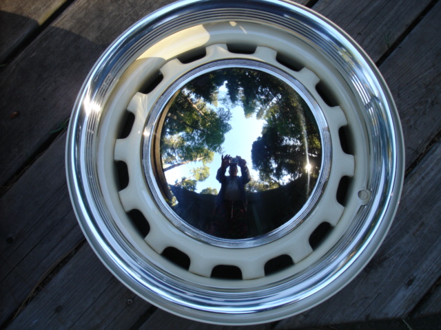

They are being made by The Wheelsmith in Corona Ca. They will set you up with width, backset, powdercoated or raw steel. I bought 5x15's with a 5 on 4.5 bolt pattern, powdercoated in the color I wanted. They aren't inexpensive, but it's worth it for me to get the look I want. I'm a believer that a wheel really helps make the build appearance. The trailer had one on it, however, it's really rough, not made for tubeless tires and in a 6 bolt pattern. By the time I found another to match and did all the work on it, I'd have as much as a pair of new ones and it wouldn't have the 5 on 4.5 pattern which matches all the other trailers I have so I have a spare. Here's the link. Doug

Parts are starting to dribble in. Today I got the front jack and dolly wheel and the artillery wheels with the stainless caps and trim rings. Steel is being bent for the new frame. I think that will be a great vintage look on this build, especially when it gets paired up with some wide whites. Trailer name will be in script across the cap. Doug
