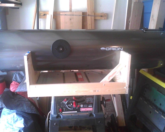

This is a pic of the telescope in a cradle that I made to keep it from rolling around in the bed of my truck

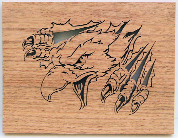

Eagle

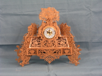

Queen Victorian Clock

Welcome, and cool scroll work. Are those examples of your work, or just examples? Pretty cool either way.

Yes the scroll work is my work however the designs were not mine.
My current telescope design will not fit in a TD. Also all together the telescope weighs in a 180 lbs which is way to heavy for me to move around much because I just had surgery on my back and my heart. That was no fun at all.
When I rebuild it I plan on using a ZipDob design or some other design that will allow the telescope to break down to something of a manageable size.

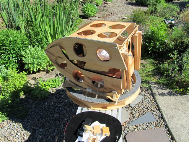

Here is a 13 inch scope close to the size of mine folded up using the ZipDob design
Here is the same telescope set up and ready to use.
With a design like this it would be far easier to modify the galley to put it in or to put it in a tongue box. It will also be much lighter.
