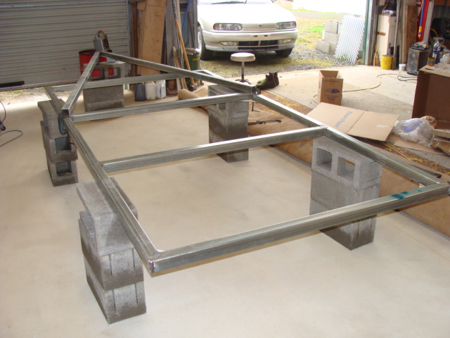

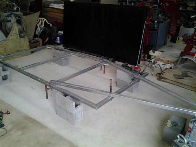

Day One: 19th July 2012. I picked up the steel for the chassis frame, and a drop saw from the hire centre. The axle had arrived, it is a Dexter that a guy in New Plymouth is importing, it was about half the price of the local equivalent.
That night I started by cutting the steel and laying out the frame. I was using 50x50x3mm (2x2x 1/8in) Galtube. Ready Galvanised box section.
Day Two: 20 July 2012. That afternoon I welded the main part of the frame, added gussets to the corners, which I also used to bolt to the TD floor, then ground off the welds to tidy things up.

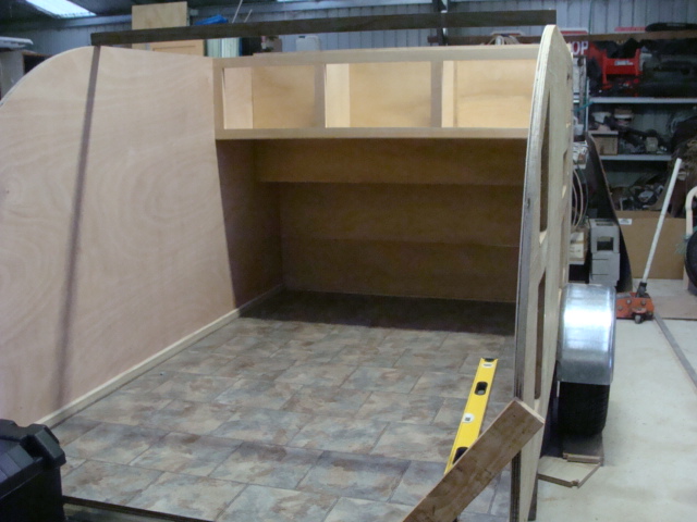

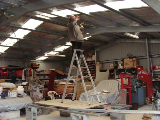

Day Three: 21st July 2012, Saturday morning, down to Demolition Supermarket to see what ply they had. Picked up 4 sheets of 2440x1220x18mm (8x4ft) construction ply for the floor and sides and 3 of 2440x1220x4mm, some sort of Indonesian hard wood, for interior trim. They also had 50x20 treated pine batons, 3m long. cut in half these were perfect for the roof beams. I could have got a 10x5 sheet to do the floor in one piece through a timber merchant, but as they don't carry them in stock the price plus freight was going to be a bit over the top. We also had some Kauri ply and a stack of Kauri timber, left over from building a boat many years ago.
When we got home I decided, if I was going to be working nights, we needed more light over the work area, so I moved one of the double fluro units from the other side of the shed. The trailer frame was the ideal place to work from. That night we spent the evening with a large sheet of heavy cardboard on the floor in the lounge drawing the profile and working out the layout of the cabinets.

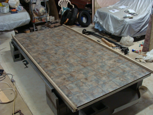

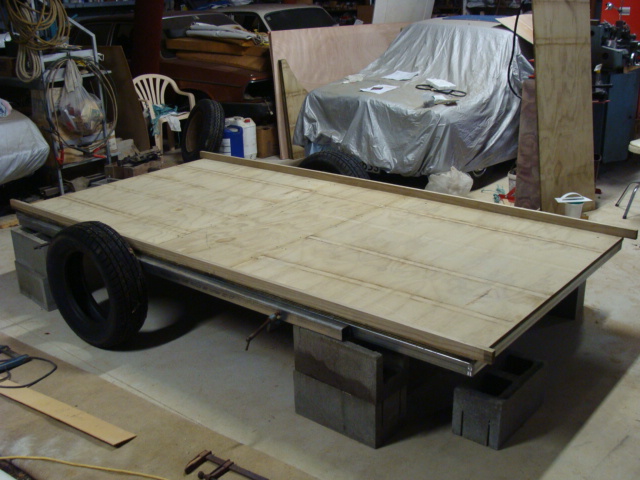

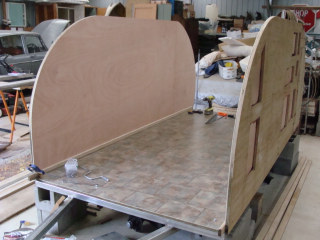

Day Four: 22nd July 2012. By tonight the floor was done. The ply for the floor was laid cross wise, with an off cut to fill the gap across the middle, with other off cuts underneath to back block the joins, glued and screwed. The remaining off cuts were used to extend the sheets for the walls.
We had also cut out the sides and tried them for size.
And an hour later we had the vinyl laid and glued on the floor.

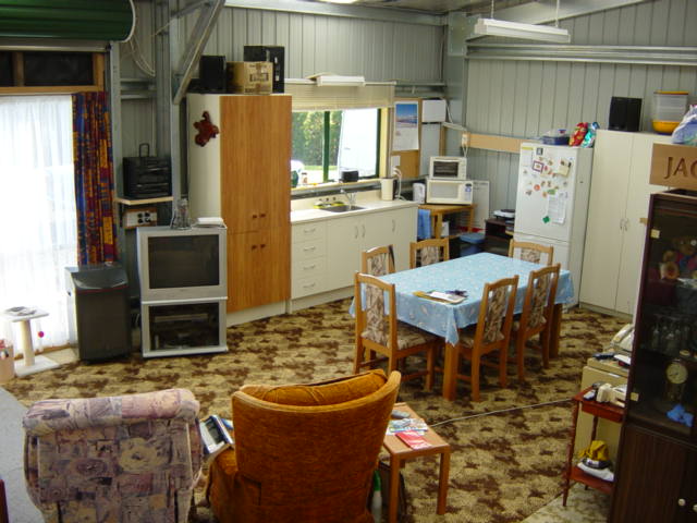

Thanks guys, for your comments. It's not a bad wee shed, but even my wife thinks it should be half as big again. That is where the "Sheddie" handle came from as we lived in half of it for 3 and a half years while we were waiting to move into our new built house. Then came the big move, into a couple of small rooms in the basement while we finished the living area up stairs. How we thought we could fit a teardrop build around finishing the house and going to work to pay for it all is a mystery. We moved to the property 12 years ago, and finally moved into the master bedroom late last year. PS the house still isn't quite done yet.....
Picture is of the shed when set up as living accommodation (lounge & kitchen). We also had a small garden shed inside the main shed for a bedroom (aka: the bed shed), an office and open plan ensuite at the rear. Other than cold in winter and hot in summer (no insulation) it was great.

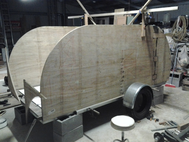

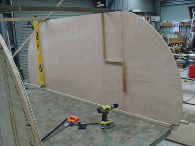

Day 9: 27 July 2012. Sides joined together and sitting up for test fit.

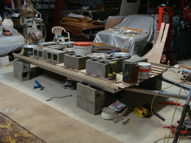

Day 10: 28 July 2012. Floor off and painted the under side with a tar based sealer. At the same time welded the "A" frame on to the chassis.

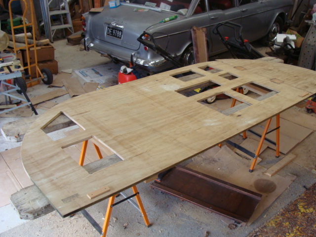

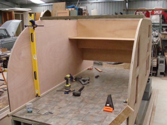

Finishing ply laminated to insides. Loaded everything heavy that we find to get them well stuck down.

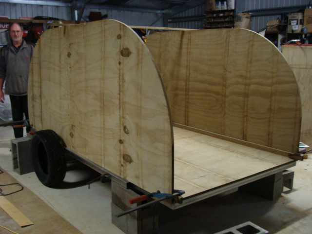

Day 12: 30 July 2012. Sides attached to floor.

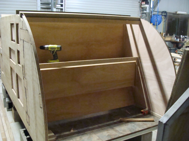

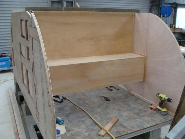

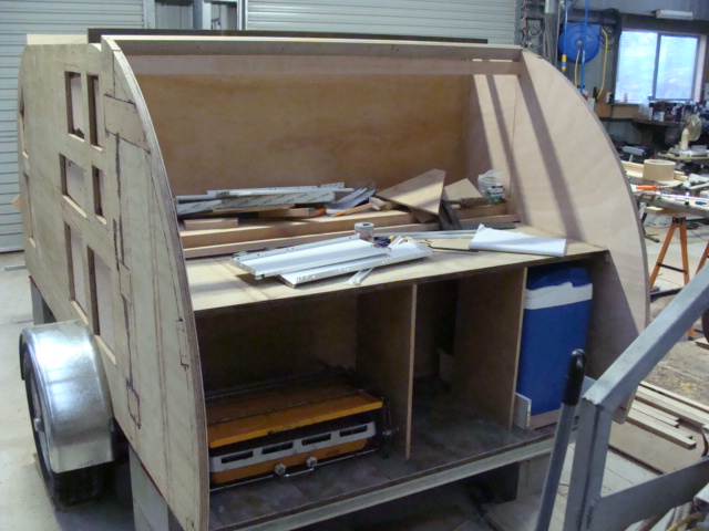

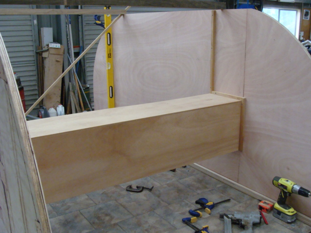

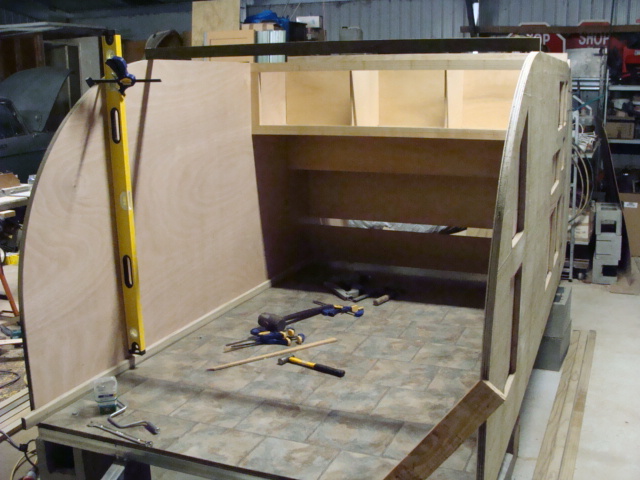

Day 13: 31st July 2012. Started building in rear storage areas.
The ply used here is Kauri, left over from a boat we built quite a few years ago
The gap at the bottom of the galley wall will have a removable panel to be able to get a proper inner sprung mattress in and out.
The framing around the cabinets is New Zealand Kauri
A good days work. It is progressing well. :)

My wife sent me down to the flooring shop to get a piece of vinyl for the floor. The only instruction she gave me was, "I could pick anything I liked, as long as it wasn't black and white checker".
