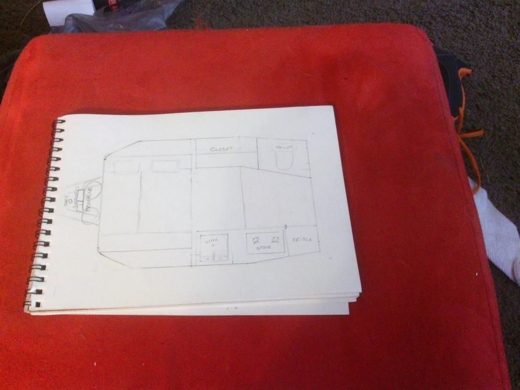

I am in the planing stages of building a Ttt, i have some sketches for layout and dimensions, and I have an idea on construction methods. Only things I am having trouble sourcing is grey water/fresh water and sewage tanks and the sizes needed. I have a history in termite repair so wood working is not a problem, my father inlaw welds, so that won't be a problem. I am thinking about using 1\8" plywood on the inside framed with 2x2's 24" on center with 1 1\2" foam board as insulation covered with fabric and titebond 2. I want to keep it about 2000lbs loaded. Oh we plan to live in it. So maximize space and storage while keeping it fairly roomy.
Going for a modified weekender style with some aero treatment on the aft 4ft and front 2ft. Overall inside height @6'1" and 96" overall height, floor is 18" on the utility trailer i am using, and 96" wide fender to fender. 12' long not including the tongue. My wife wants a toilet and a sink in it, not to worried about a shower, a removable stove so we can cook outside when we want, and a refrigerator/freezer, and fold up queen mattress over a table /bench's.

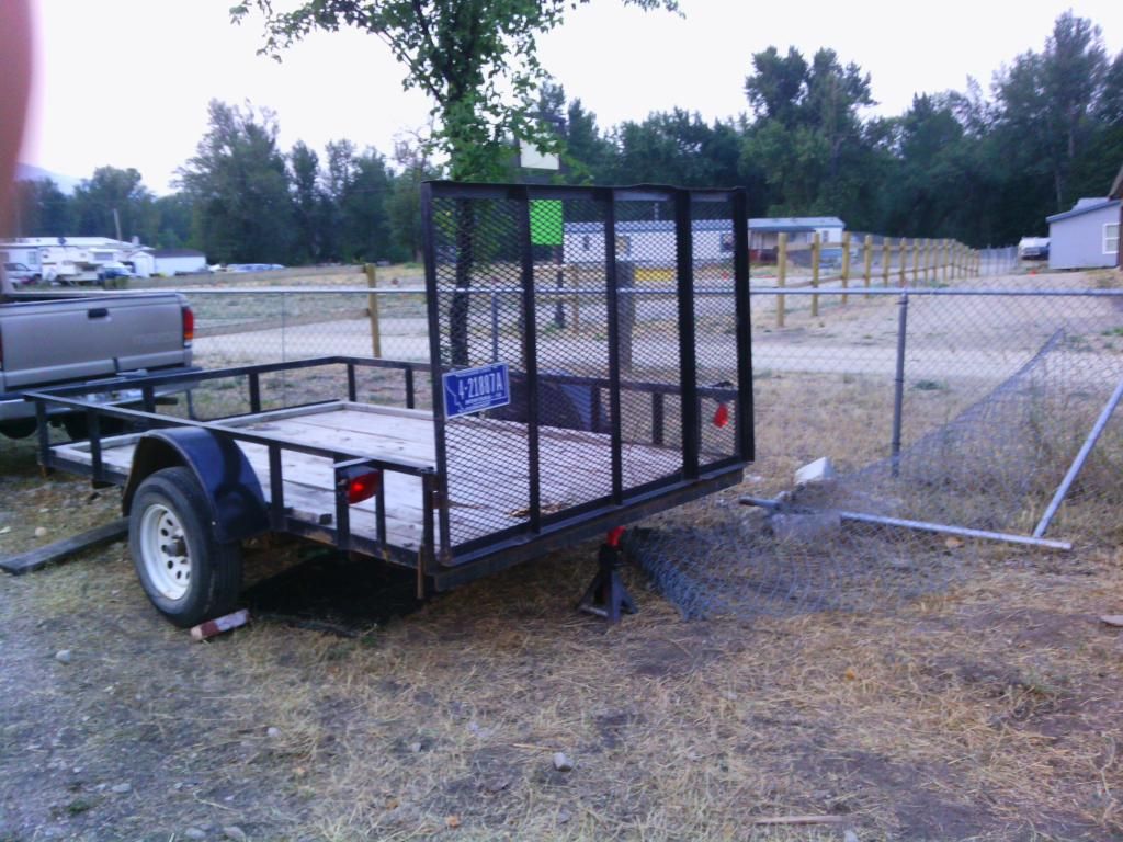

Postby Sporty Modder » Mon Aug 11, 2014 7:27 am
Here is the truck and trailer. Truck is a 96 4x4 B4000, with a 5spd mt. Trailer is 8' outside fenders and 10 ' inside the box. ImageImage

Postby BuildingForFun » Mon Aug 11, 2014 9:00 am
I am assuming that you are using the utility trailer for your build, Are you going to work around the top rail? Or take them off?

Postby Sporty Modder » Sun Aug 17, 2014 10:18 pm
BuildingForFun wrote:I am assuming that you are using the utility trailer for your build, Are you going to work around the top rail? Or take them off?
Yes that is the plan. The rail will be coming off, as will the tailgate. My budget is really tight right now, cannot even afford a pack of cutoff wheels for my grinder, lol.
