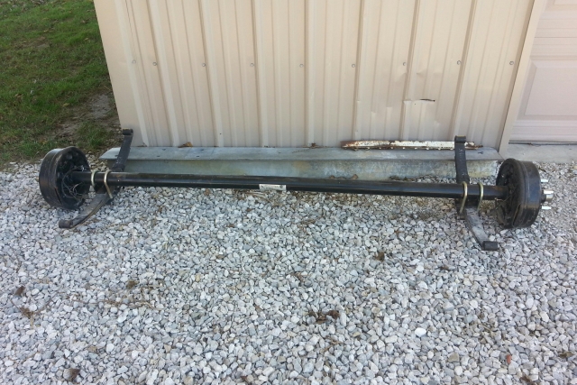

Ok... so we scrapped the original TD plan and decided on the Standie. This greatly complicates things. Our original trailer of 5' wide by 8' long is significantly too small for our project. Therefore our options were to get a new trailer or work with what we've got. Since we've already got plates and title, we decided to go ahead and continue on with the old Palomino frame. We purchased 3" C channel to extend the length of the frame and the width of the frame to accommodate our new design. We purchased a new 3500# axle and leaf springs with electric brakes from an RV supplier. The new frame is now 7 1/2' wide by 10 1/2' long. Not counting the tongue. We have now ditched the 8"wheels in favor of some new 14 " Aluminum Wheels and some new tires. Notice the picture with the tire in the frame. The new cross member sits right where the old wheel used to. You can get a feel for how much this frame has grown! All that welding really screws up a nice paint job!
