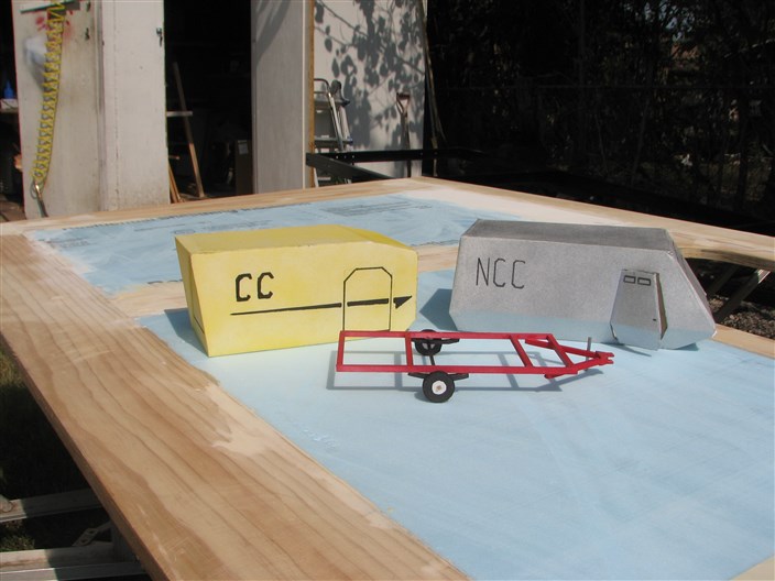

Decision already made. Sorry it's not the shuttle. However I am experimenting with something new to me.

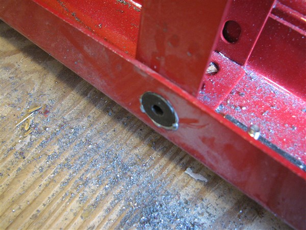

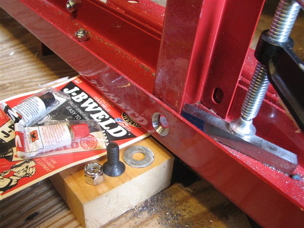

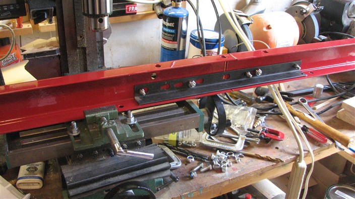

I made a few mods to the trailer. I didn't like the bolt head above the frame. thanks for the comment. Benny
001 (600 x 450).jpg (91.32 KiB) Viewed 1494 times

Postby KCStudly » Wed Oct 01, 2014 7:26 am
Nice solution using the FH bolts. I like it, even though it is not as thrifty as some of the other methods that are typically used.
Just a couple of concerns to share: the little piece of angle with all of those extra holes in it looks a little weak to be used as a main frame rail splice. Most people use the provided xmbrs nested inside to fix the main rails, then build their floor or wooden subframe to compensate for the missing xmbrs.
You probably have already checked for this, but for the benefit of others, something to watch for with flat heads is to make sure that the thickness of the gripped material accommodates the depth of the bolt head. If the start of the bolt head cone runs into the top of the threaded hole before it develops proper pretension while clamping the countersunk member, then the joint won't be tight or might loosen later under stress. Using a few more slightly smaller fasteners is one way to reduce the depth of the fastener head required for a given material thickness.

Postby bensgreentrain » Wed Oct 01, 2014 9:44 am
Thanks for the info. I did look at the post using cross member, and that is very good way to do it. It is not shown but I did add bolts to the spring support that joins the two side rails.

Postby SLUG36 » Wed Oct 01, 2014 3:36 pm
it looks like you used some bed frame for your splice. I used some on my build. and it was a pain in the butt to drill through. I think I broke several brand new 1/8" drill bits trying to drill into that stuff. I believe the angle iron they use for those bed frames is tempered.

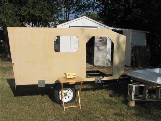

Postby bensgreentrain » Thu Oct 02, 2014 11:39 am
Thanks for the reply. I live in Burleson TX, just south of FW. My plan is to use the CC to go to Crockett Natl. Forest in November. I had problems with the drilling to, it's tougher than I thought.
sept 1 002 (528 x 396).jpg (61.39 KiB) Viewed 1315 times
sept 1 006 (528 x 396).jpg (56.55 KiB) Viewed 1357 times
door (704 x 396).jpg (73.77 KiB) Viewed 1357 times

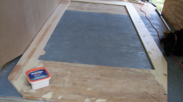

Postby bensgreentrain » Wed Oct 08, 2014 2:00 pm
IMG_3003wall (640x360).jpg (125.77 KiB) Viewed 1261 times

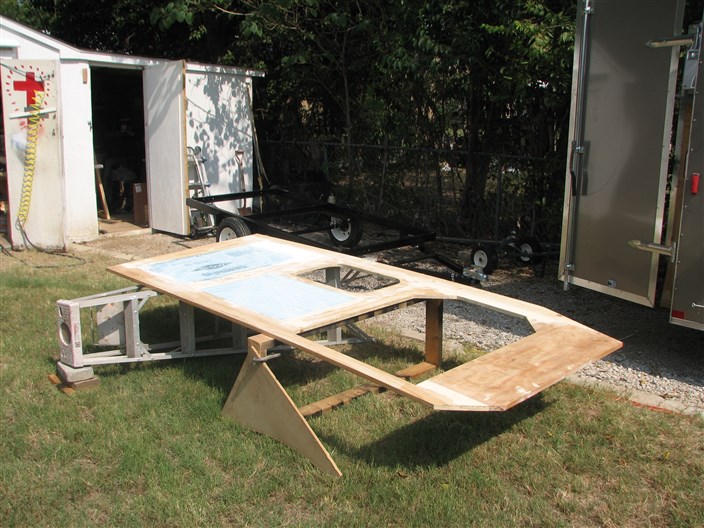

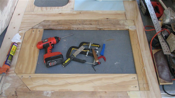

I went and got the floor today. Next week the walls will start going up.
002 (704 x 528).jpg (127.58 KiB) Viewed 1255 times

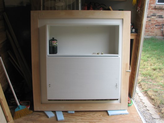

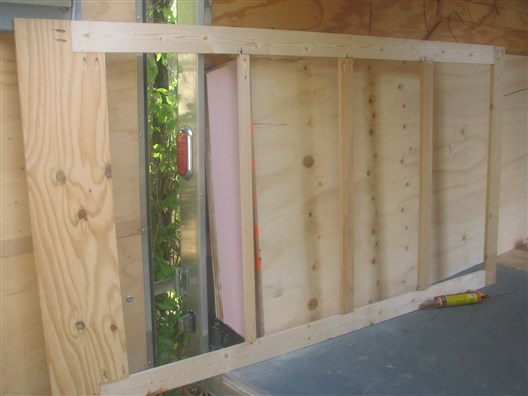

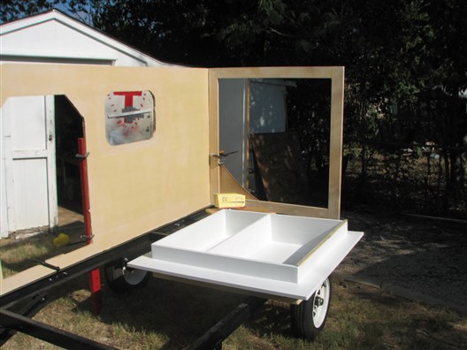

I am still working on the galley/back door but here are some pics. This is the door siting in the door frame. also one pic of the roof frame.
This is the galley door with the counter top in the down position which can be used, door open or closed. This will allow me have that first cup of coffee getting up.
galley 006 (528 x 396).jpg (47.02 KiB) Viewed 1196 times
this is the back door/galley sitting in the door frame.
galley 007 (528 x 396).jpg (46.9 KiB) Viewed 1196 times

This is the roof frame. I plan to attach a 1/8 Masonite white face panel for the inside.
