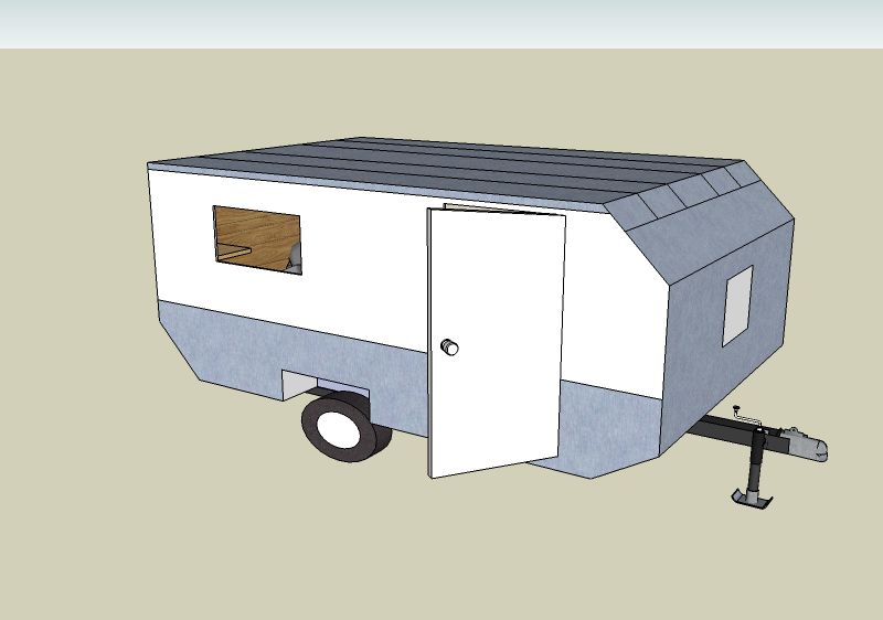

Thanks to member Starleen2 for the original Weekender II design. Mine will be about 5ft tall and almost a foot longer- it's an XL model!-
My trailer is the 1195lb HF model. I'm ditching the folding feature.

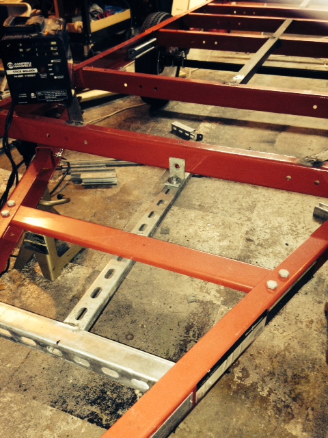

I spent this weekend working on my HF frame- I moved the front half forward 6"- to the last bolt on the spring hanger channel. I then welded in the gap with angle and plate. I have 42" from the rear to the center of the axle and 60" from the center to the front. Pretty close to a 40/60 ratio. I still need to beef up the front hitch. I have a better distribution of cross members, since I did away with the folding feature and welded it up solid. The trailer is quite a bit stronger. It's now 102" long, which I think will help me fit everything in and give me a better door placement.
Next task is to weld some side channel pieces on the sides to better support the plywood overhang. I have a nice pile of junior super strut scrap pieces I saved from electrical jobs. I'll weld 4 to a side- once I determine how wide my floor is going to be- :thinking:

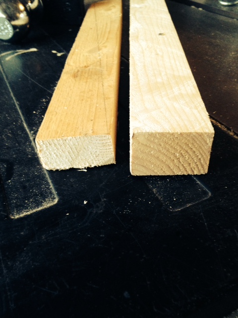

First I needed to make my wall studs. The prices for materials continues to climb and climb. When I started my shantyboat project 3 years ago I bought 1/4" BCX for about $14 sheet. It is now $24 at my local Lowes! I purchased two 10ft 2x6's and one 8ft 2x6 to rip into oversize strips. They are 1.125" x 1.5" in size- I used a piece of 1.5x6 decking board to set the cutting width of my saw. I can easily make more pieces and they will always be the same size.
As you can see, the oversize studs have a lot more beef than a standard 1x2 furring strip. I can now use 1" foam board wall insulation.
Using a decking board cutting width, I can do 4 passes through the saw (5 pieces) and the last piece needs to be run through again to bring it to size, as it is about 1/16" too wide. A 10ft 2x6" board (@ $7.89 ea) rips into ten 5ft long studs at a cost of 80cents each. A 2x2-8ft furring strip is over $2 and cuts down into only one 5ft stud= a lot of waste.

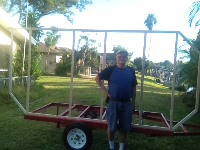

Postby Gold5one » Sun Nov 16, 2014 5:10 pm
I completed a rough frame for one side- I'm standing in front of the opening for a 24" wide door. The inside length measures 10ft-7"- add another 3" for outside length. I also made the angled corners about 10% larger so the sides looked more in proportion to the original Weekender II. I have all the corner pieces and angle cuts done to the plates, so it's just a matter of putting the other side together next weekend. I'll have to take the wheels off my trailer to finish it in the garage. I plan on using a couple of HF square furniture dollies under the axle. I am still undecided on the width- somewhere between 68" to 72" - I'll put the sides together with some wood pieces in the garage and see what works the best.Then I can bolt the plywood floor down on the frame. I need to find some windows, soon.
added- From the picture, it looks like I should move the axle above the springs. From my perspective, I need to lower the CG- a strong side wind could have too much leverage on the sides of a tall camper. Maybe I'm being overly cautious-??

Postby KCStudly » Sun Nov 16, 2014 8:31 pm
Gold5one wrote: Maybe I'm being overly cautious-??
Nope. Tall, narrow, very light trailer and high winds do not mix well.

Postby Gold5one » Sun Nov 16, 2014 10:01 pm
KC- thanks for the reminder about windy days.That must have been pretty scary when your camper blew over. I once spent 2 days holed up in a Wyoming campground waiting out 60 mph winds. Even my 5th wheel couldn't stand up to that. I saw a couple semi trucks blown off the road when I got going again. Being a tad heavy isn't all bad, is it?-

I made some good progress welding on my HF trailer over Thanksgiving. I welded front corner bracing and angle down the center. Solid welds have replaced the top bolts. I also cut and epoxy fiberglass taped the plywood floor panels together. Today I cut out the wheel wells and coated the bottom side of the plywood with Elastoseal rubberized primer coating. The second coat goes on tomorrow.
I still need to weld on 10" long side pieces of junior strut to support the plywood overhang and a couple more pieces on angle. I used electrical unistrut to strengthen the A-frame. I can still unbolt it, I I ever need to remove it for storage. Next weekend the trailer frame should be done and the floor bolted on. I'm getting really good with that 70amp welder- 5/64" rods work best.

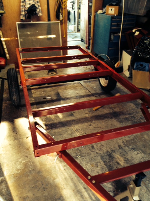

Postby Gold5one » Wed Dec 03, 2014 8:16 pm
I changed one of my cross members- moved it back 5" to where it was in the original design. Started welding on side supports, but I will have to mount the floor before I locate and weld the ones near the wheel well cutouts. Leaning towards using 1/4" bcx fir plywood for the sides. This is the same plywood I used on the sides of my boat - it may not be pretty, but it's strong. I estimate that plywood will weight about 100lbs . My floor weights 70lbs

Postby Gold5one » Thu Dec 11, 2014 7:18 pm
This week, I mounted the plywood floor to the frame and I decided I didn't like 72" width on a 48" wide frame, so I trimmed it down to 68", 2" off each side. Future gas mileage trumped the extra space inside.
