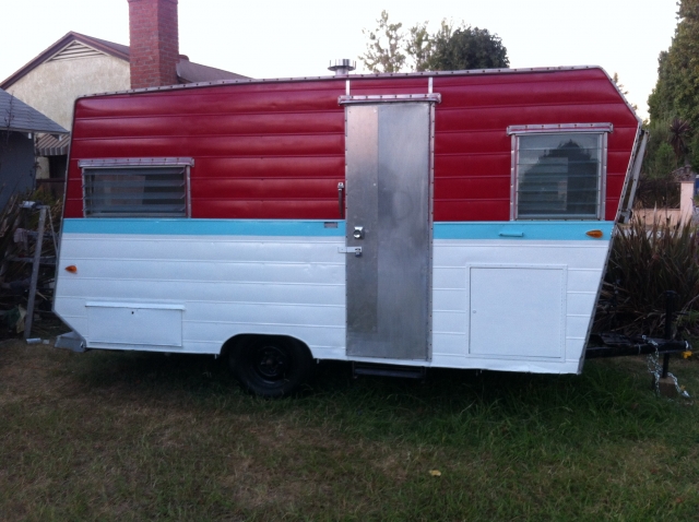

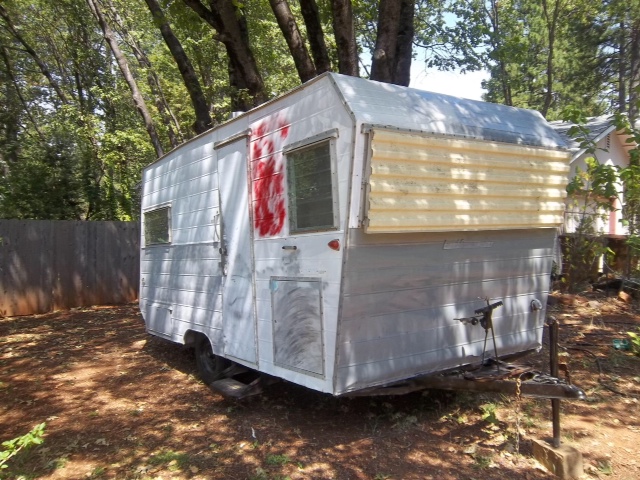

So this is my new-to-me 1964 Aristocrat Land Commander.
The actual box is about 12' long, bumper to bumper its about 16' and on registration its as 18' because they dont have a category for 16' in california?
Generally, what measurements do you all reference when stating the length of your trailer?
I got it off craigslist for $500. Another $100 for registration, $150 for new trailer brakes.

To keep my neighbors happy, I did it a little backwards painting the outside first thing. I used cheap spray cans from walmart and I'm happy with the result.

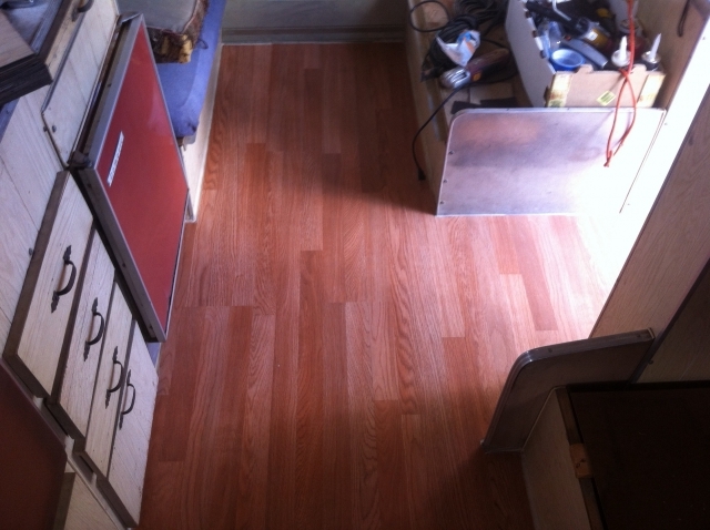

I picked up some cheap laminate flooring today from home depot and will be installing that soon.

here is a before pic:
and an after pic:

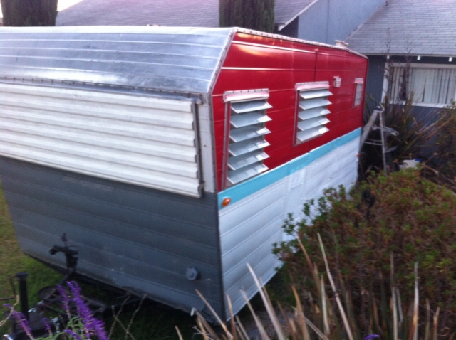

this one you can see I was able to strip the front top to bare aluminum, wish I could have done the whole thing like that but it would have been way to many hours to strip it all:

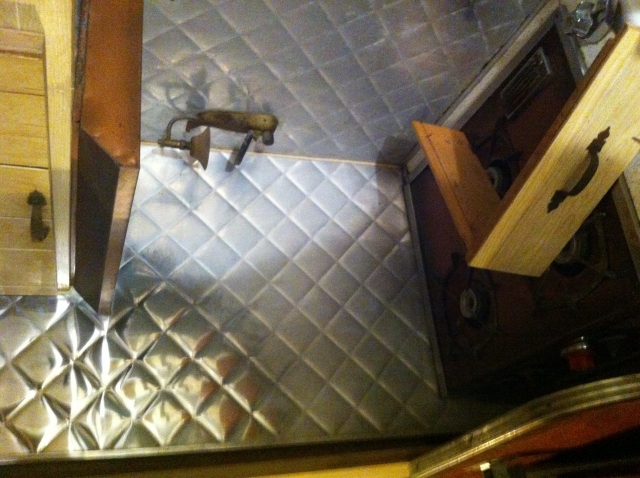

I'm starting to shine up the quilted aluminum back splash here, cleans up nice:

I brush painted the bumper and front of the frame. Spray painted the front white and will add color later. And I sealed the front and rear windows, the front and rear corner seams, and two of the roof vents.

Finished the floor Saturday

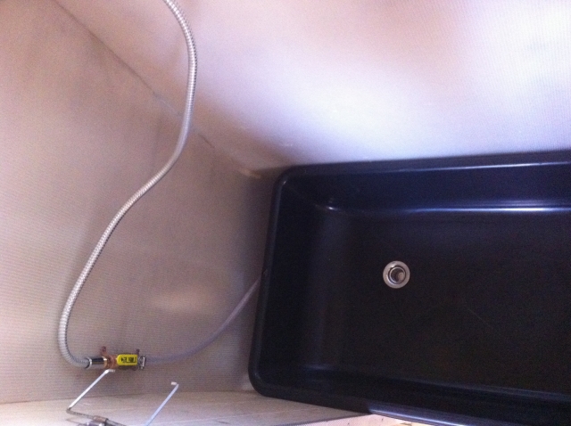

This weekend I finished the shower for the most part. I must admit I think my setup is pretty thriftily ingenius. I put coroplast on the walls I already had on hand. And for the shower pan I used a "large mixing tub" from Home Depot for $15. It's 24"x36" and fits my space perfectly, I installed a utility sink drain that goes straight into the tank. Right now it's cold water showers only but I may add a solar heater in the future. I'll try to post some pics of it all
