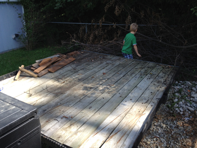

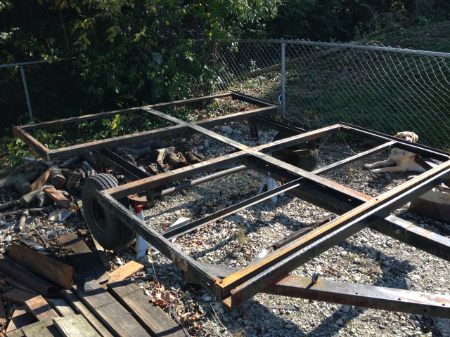

Postby chriskoebb » Sat Nov 01, 2014 2:51 pm
The trailer is cut down to close to what I think I need to start modifying to be a campster12. I am going to buy a mig weilder and fix a few spots on the trailer and add 15inches to the back to make the length to the size of the campster drawings. I opened the sides in front of the wheels so I can
replace the axel to a 3500lb straight axel with brakes. I will then put 14" tires on. I am going to do the drop floor portion but leave the support in the
middle so I dont have to redesign the trailer.

Postby angib » Sun Nov 02, 2014 10:25 am
chriskoebb wrote:I am going to buy a mig weilder and fix a few spots on the trailer and add 15inches to the back to make the length to the size of the campster drawings.
Will that put the wheels in the right place? Adding length behind the axle is a recipe for a trailer with too low a hitch weight and hence poor stability.

Postby chriskoebb » Sun Nov 02, 2014 8:57 pm
If I go by Grants design I have my axel in the right place allready, but if you measure from the back of the trailer to the center of the wheels I am 15 inches shy. So im hoping I am doing the right thing by adding the 15 inches in the back....... :worship:

Postby AZ_Desert_Rat » Thu Nov 06, 2014 4:38 pm
I must have missed something here ... Adding length to the trailer behind (aft) of the axles would be the same as adding weight behind (aft) of the axles making the tongue weight less (Kind of like adding more weight to one end of a teeter-totter). This usually makes a trailer and tow vehicle less stable, and can increase whip. :roll:
Maybe that is what your were saying Angib ... I just missed on the first read :surrender:
If the trailer length is okay, moving the axle towards the rear (aft) will make the tongue heavier ... Just my 2 cents Chris

Postby chriskoebb » Fri Nov 07, 2014 2:32 pm
AZ_Desert_Rat wrote:
That makes since. I would be adding 15" to rear and almost 36" to the front of the box part of the trailer. Effectively making the box on my trailer from 96" long to
147" long with the axle being at 121" from the tongue of the trailer Per Grants design of the campster. I guess it would have helped on my part if I would have gave all the information. :oops: now that I am buying a mig wielder I am thinking of just putting a deck back on my trailer and selling it and build from scratch.lol . Although we Did come up with a name for the Camper. "The Movie Trailer" Coming soon to a town near you!
