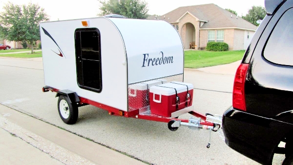

I built my first non-traditional teardrop over a period of 5 months this past Summer and Fall. It was built on a Harbor Freight frame, and skinned with Filon. I had so much fun building it that I decided I needed to build another one. So, I listed it on my local Craigslist and sold it 3 hours later.
My first build.

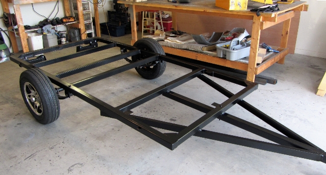

For my second teardrop project I decided to weld my own frame, and will skin the camper with prepainted aluminum. I will use lessons learned from the first build to make this one even better.
I welded the frame using my nifty Hobart Handler 140 mig welder. Its mostly 2x2 tubing with a couple of channel pieces.
After cleaning the steel, I gave it a coat of Rustoleum Clean Metal primer then followed with Rustoleum glossy black. The whhels and tires are from etrailer.com.
It took about 8 days to cut the steel, weld the parts, install the suspension, and paint the trailer.
I am by no means the skilled craftsman that so many people on this forum are, but maybe someone will find something interesting in my build. I will make an effort to post photo updates on a regular basis.

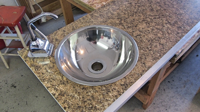

I like to have small side projects for those days when I don't have a lot of time to spend working in the garage. Today, I worked on my galley counter top. I made a stainless steel sink for $15 using a $9 stainless steel mixing bowl from Target and a $6 drain from Lowe's. Surely was a lot cheaper than buying a real RV sink.
sink made from a stainless steel mixing bowl and a small wet bar type drain

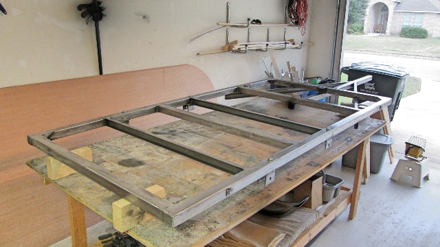

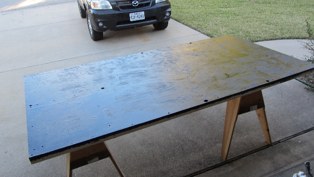

Did a lot of work on my floor (deck) today. The bottom is 1/2 exterior grade ply. Frame is 2x2's, and the floor is 1/4" ply. The interior of the structure received 2 coats of Valspar exterior primer/paint combo, because I had a gallon sitting in my garage. I plan to use 2" of R-Tech foam insulation. This is a shot of the underside after receiving a coat of Black Jack Roof and Foundation Coating. Nasty stuff, but I may do a second coat because I'm a little OCD.

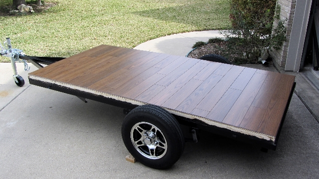

After installing my deck, my next door neighbor provided me with some flooring leftover from a recent remodel of his living room. Its Wilson Art laminate. I think it looks pretty sharp...actually better than the flooring in my house.

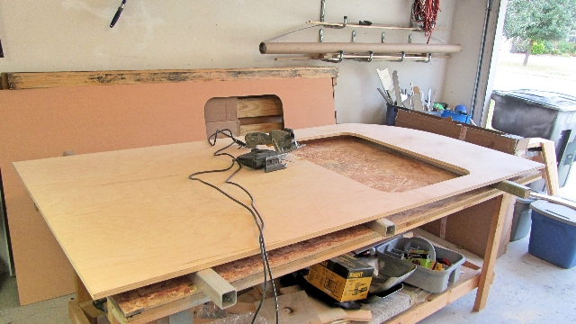

Next task was cutting the walls. I used a combination of my Rockwell Versacut (an amazing saw) and a jigsaw. Walls are 3/4 maple from my local Lowe's.
cutting walls.jpg (213.18 KiB) Viewed 4446 times
With a little sanding the door and window frames fit nicely.

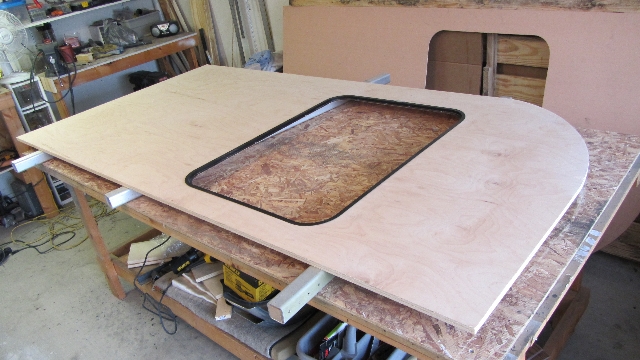

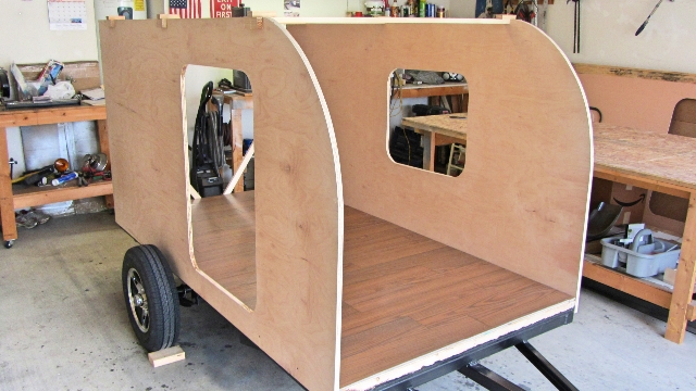

I made these jigs, which act as temporary spars, to hold the walls in position before adding the actual spars. They fit over the edges of the walls.
wall jig.jpg (173.15 KiB) Viewed 4380 times
We put the walls on temporarily to get an idea of our galley and cabin layout. I'm a visual learner. You can see my jigs in use.

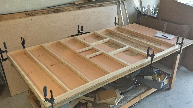

Based on lessons learned from my first build, I'm building the roof/ceiling on my work table. I'll do the interior skin, wiring, and insulation, and then install the "prefab" roof as one piece. I feel its a lot easier to build this assembly on a flat horizontal surface. We'll see.
prefab roof2.jpg (200 KiB) Viewed 4302 times
