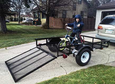

Greetings, fellow TNTTTers. I had already started on my first trailer when I discovered this forum, so I'll post some pictures showing my progress so far. My semi-retired father has been helping with designing and building, but this is also his first foray into travel trailers so don't expect perfection just yet. That comes with trailer number 2. :lol:
We started the design process with a few loose guidelines...
    Finished weight less than 1,500 pounds (under 1,000 if possible) for towing with minivan.
    Fits in garage (under 7 feet)
    Sleeping accommodations for two adults and three kids (ages 2 to 5).
    Preferred to keep the width and height small for minimal drag.
Here's the trailer I had to start with. 8X5 flatbed with one foot side rails.

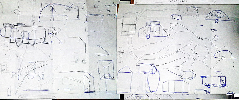

Here's a few scribbles from the early part of my design process. Some of these ideas were influenced by images from the internet (maybe some from this forum, though I didn't know it yet)...

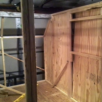

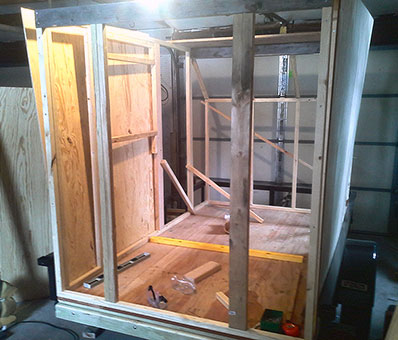

And here's a photo after building and insulating the floor and framing up the walls....

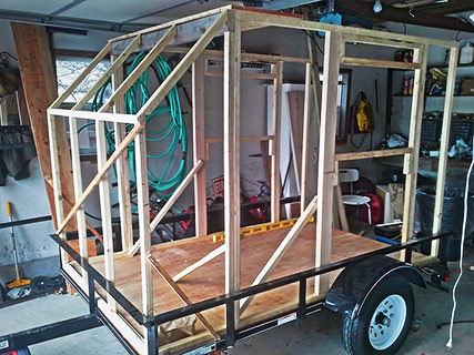

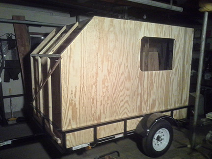

Side walls installed and windows roughed out...

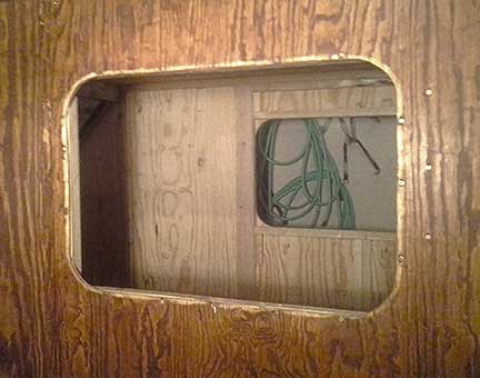

Here are a couple of shots showing more detail of the wall construction.
The skin is 3/8 inch plywood. Funny thing is I meant to get 1/4 inch, but the hardware store had 3/8 inch in the 1/4 bay. I didn't realize the error until I had already started installing it. Had to make a couple of adjustments, but I don't mind the extra strength.

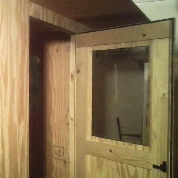

Postby Westling » Mon Dec 15, 2014 11:21 am
Much progress was made in the last week. Here's the back wall and homemade 5-foot door with 18"X24" acrylic window. Note 18 inches of overhanging roof... originally planned to trim it off, but may support it instead as a permanent awning.

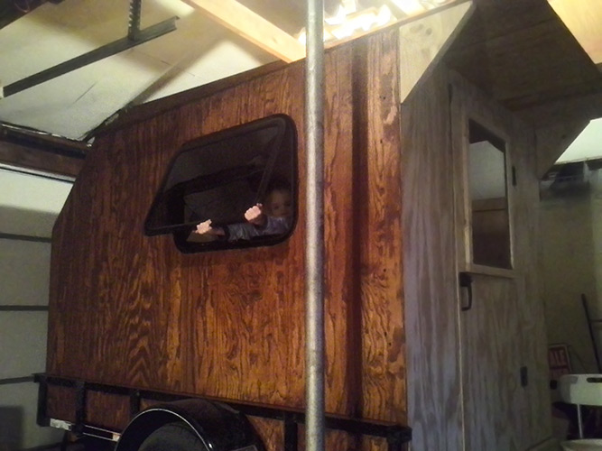

Postby Westling » Wed Dec 24, 2014 10:32 am
My oldest helping me test the newly installed exit windows...

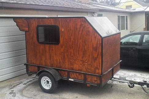

Postby Westling » Thu Dec 25, 2014 2:45 pm
Merry Christmas Fellow TNTTTers! First test drive with seams and corners sealed (Eternabond) and wings installed: Christmas morning 2014!
Feels great to be "done"... just don't ask about the interior! :lol:
