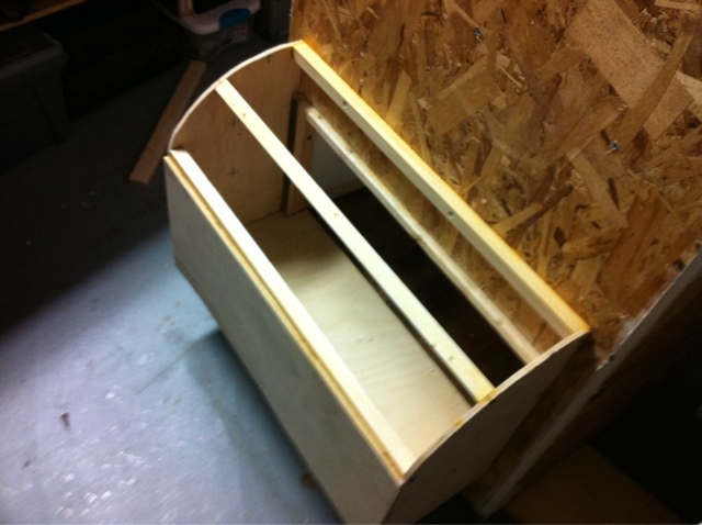

Tonight I framed out the interior cabinet, which will be a handy spot for books and such, and possibly a little compartment for a 12V system. We'll see.

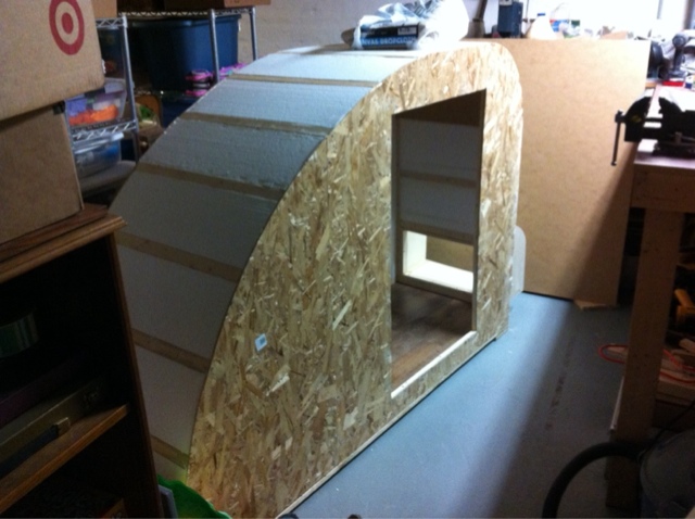

Had a little time to start insulating this week. I'm still thinking through some big design elements, like exterior and interior coverings, so I've hesitated in putting insulation in certain areas that will need holes cut.
128697
I had a lot of 3/4" XPS styrofoam insulation left over from insulating and air sealing the rim joist in my basement, so I used that. The foam comes in 4' long lengths 14 1/2" wide (so it fits be default between furring strips at 16" OC). I adhered the foam to the wood with Titebond II, but I made sure to cut it to fit snugly as well, especially since I was using scraps to piece together some of the sections.
128699
128698
I'm trying to decide whether it would be easier to cut holes for things like my 3" round soffit vents with the insulation installed or not before I fill all the gaps. I also feel that I need to settle on interior and exterior coverings before I cut those holes, since I'm considering using canvas for at least one cover. That would affect how large I cut the holes for the vents and doors, since I'll need to wrap the fabric over the edges into the openings. I have a zillion questions about how that works (and whether to use flashing, etc.) so I've been working my way through the multi-volume set that is the Foamie Big Thread, and I'm sure questions will pop up soon in the skinning forum.

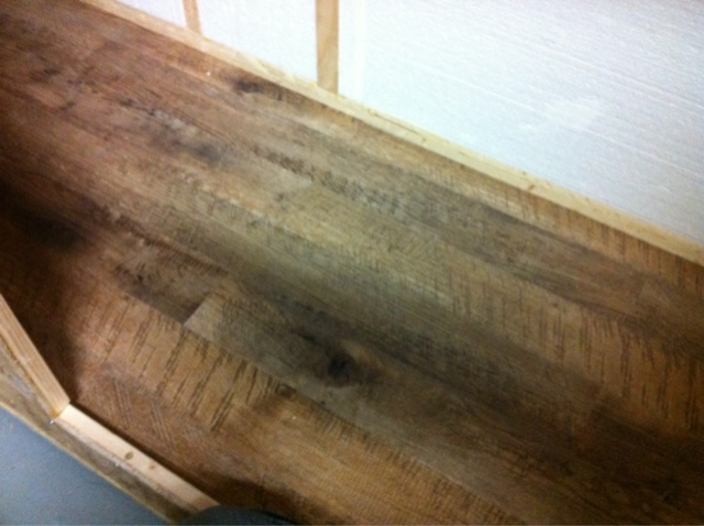

Glad you asked! I was abroad for a few weeks, and it took a few weeks to prepare and then a few to recover, so I haven't done much since the end of February. But with a 66 degree day today, I'm itching to get back at it. It's fully insulated now, and I built a little fake tongue box off the front that opens from the inside where I can put my shoes when I get in:
Then I put in some nice vinyl flooring that looks like old barn wood ($10 at the Restore):
Next step is to "poor man's fiberglass" the outside with Titebond II and a $15 Menards drop cloth. Then I need to finish building the door. Right before I left I got a box from Lil Bear full of door goodies, so I'm ready to get started on that, too.

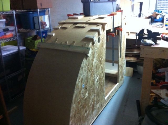

First, I finished skinning the outside of the Escape Pod with 1/8" hardboard. I used some homemade clamps made of scrap wood that I first saw in a post somewhere here on the forum:

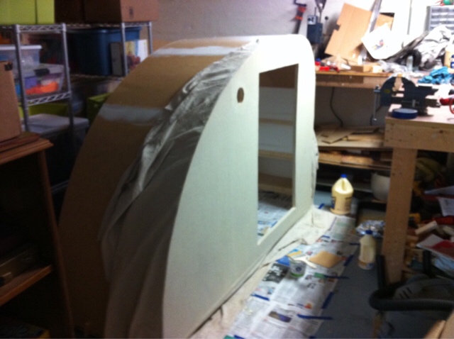

Well, last week I finished canvasing the outside of the Escape Pod. While I still have to build the door and canvas it, I'm nearly done with covering everything I own in a thin layer of glue.
Here's the canvas as I started covering the fake tongue box:
135155
I only have about 18 inches on either side of this thing to move, and working on the top I needed to have space on either side. I covered nearly every part of myself in Titebond II at some point.
Once I got all the canvas glued on, I went over everything with several thin coats of 50/50 water & Titebond II mix. That was even messier. But here it is, all canvased:
