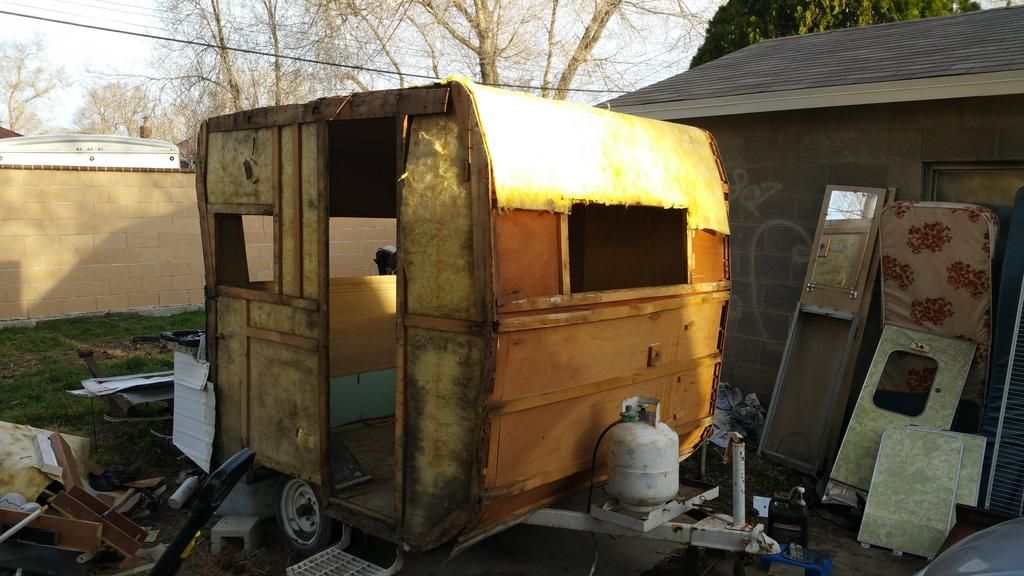

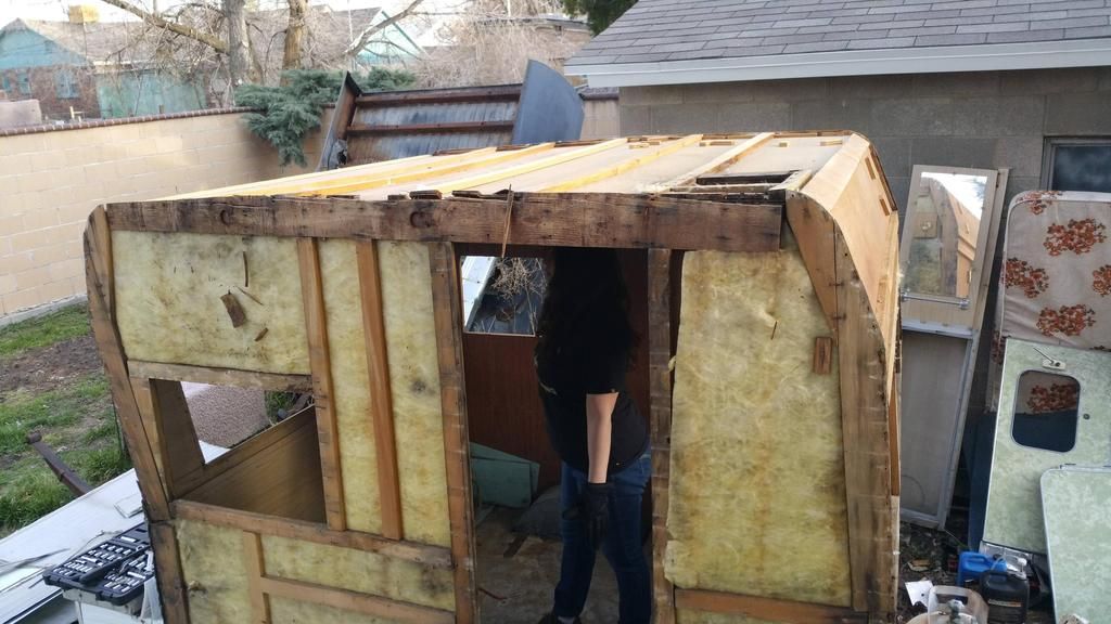

Well, have you ever started a project and felt you might be in over your head? I might not be, but I'm just hoping my goal of having this complete by my Independence day trip this year is realistic. I'll probably be referencing this site constantly.
So here's the little monkey I've got to deal with.
http://i.imgur.com/L4plbyo.jpg
1962 8' Lil' Loafer
8 Feet of in over your head, I think every wall on the beast is rotten, too many spider carcasses to count, travel trailer.
Aside from a rather abundant list of things I need to do, the size of the trailer really helps me feel I can manage it.
http://imgur.com/a/IQrMj
This is my first project like this, though I am a pretty crafty person with a number of tools at my disposal, so I'm assured of my eventual success my by my overly optimistic attitude and the small allotted budget that my wife has given me to complete said task. Given that, I'm probably going to clean up and reuse what I can, though I would rather it not look entirely like it dropped out of the 60's when I finish up.

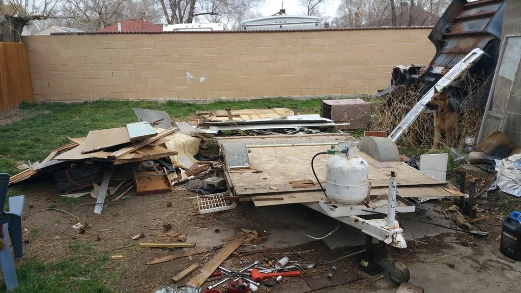

I've already started the tear down though, so now there's no looking back. I'll update with more pictures when I can, but for now, here is a wide view of the carnage.
http://i.imgur.com/WzzdjJO.jpg
I do plan on keeping the spider box/tumor on the back of the trailer and fix that up. It is a really good place for storage and such, but it just needs to look a little better.

Postby SuburbanLoafer » Sat Mar 14, 2015 4:20 pm
Well, a little update.
The good news:
By the time I'm done I'm basically going to have a brand new trailer!
The bad news:
It's because I have to tear it down to the frame and rebuild it. Just about every frame board is rotting or disintegrated.
So, no way am I going to get it done like July, like I'd hoped. I simply do not have enough time.

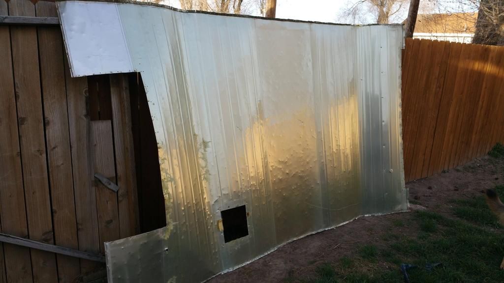

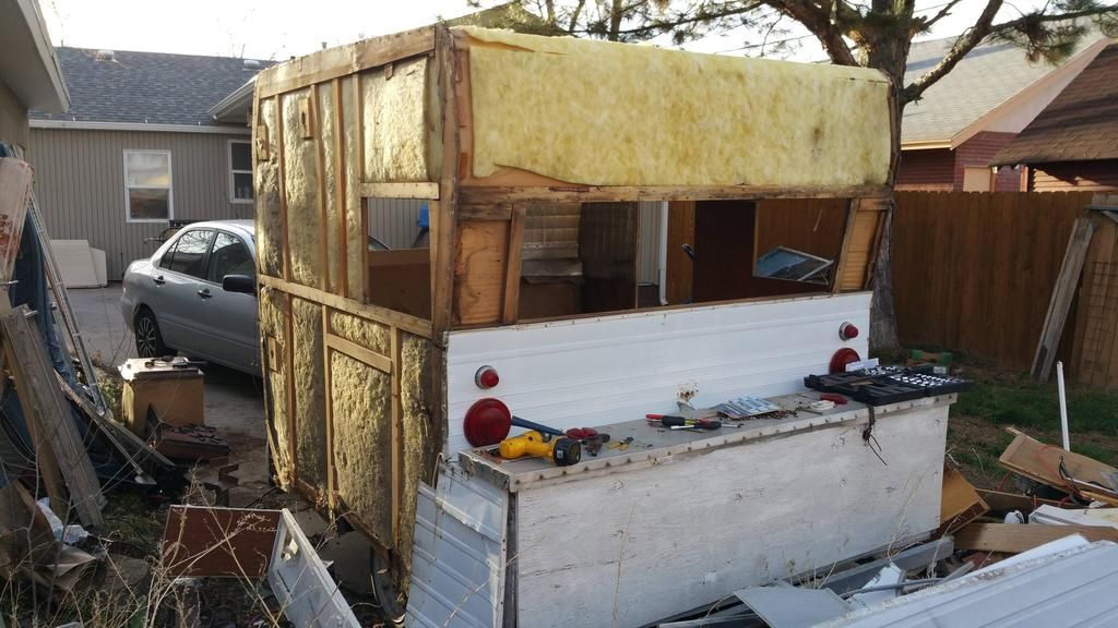

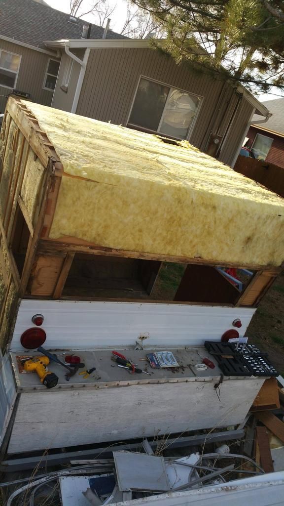

Here's just a few quick pictures of one of the sides I took off.
http://imgur.com/a/TUAC5
All in all, a little more work than I had hoped, but part of me braced for this expectation before I even started the tear down.
I am still excited to get it finished some day though. I am very much enjoying the thought of getting to use this someday.

Postby SuburbanLoafer » Sat Mar 14, 2015 10:13 pm
Well I got the trailer for free to start out with. So that's as good a deal as I could've gotten. haha.
After getting all the siding off, and considering that I am basically rebuilding this from the ground up I came to the conclusion that I didn't want to put all the same beat up sheet metal back on it though. The old sides will make perfect templates for cutting out the new ones though.

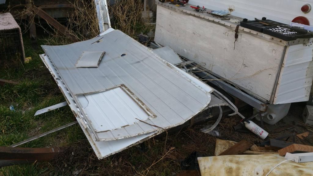

Here's a few more pictures of the tear down.
My lovely wife helped me clear out the rest of the stuff from the interior and take off the siding. It was a lot of fun working together on it.
Other plans... I'm going to use foam, instead of the yellow stuff. I also plan on wrapping the whole thing in that protective house wrap stuff. I'm hoping this will last another 50 years when I'm done with it. (I may not have it for 50 years, but I don't see why someone else should have problems with it down the road.)
On a side note though.. Because I've seen some people on here get trailer sides cut out on giant CNC machines. Is that even possible with my trailer? and around how much would something like that run?

Postby SuburbanLoafer » Sun Mar 15, 2015 8:16 pm
So the fun part is basically done!
I've been talking to my wife, especially about the wood box that was on the back of the trailer, and we have come to the conclusion that the best thing for us to do with the trailer is to extend the walls all the way to the back. It'll still look like the TTT it used to be, but we will gain about 2ft. of interior room. Since she is allowing me to do this project in the first place, I feel more than happy to give her some allowance as to what is going to happen.

Seeing the complete lack of joinery in the original structure, it is amazing that the trailer was even roadworthy when new. The fact that it was still intact when you got it is even more amazing. Have fun with the rebuild.

wagondude wrote:Seeing the complete lack of joinery in the original structure, it is amazing that the trailer was even roadworthy when new.
Amen.
On the CNC router thing, the typical commercial sizes are 4x8, 4x10 and you might even find a 5x10. The guy who did my templates only had a 4x8 and my wall height was over 4 ft, so I broke it up into three segments 4 ft wide or less. In fact, for the middle segment I really only needed the top radius and back side of the door frame, and he used scraps so that one wasn't even 4 ft wide. I just moved it back along the cut to continue the arc.
All in all it was a "nice to have" thing, but could have got there without it. The only reason I did it was because we were swapping favors, labor for labor.
