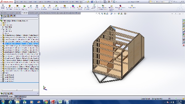

The Design
A work in progress
128937
Progression of the design 3/3/15

Updated the design section with progress of the drafting :D

Postby Da'engineer » Wed Mar 04, 2015 12:26 am
Updated design section. Steel is on order for the frame sparks should be flying some time next week!

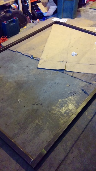

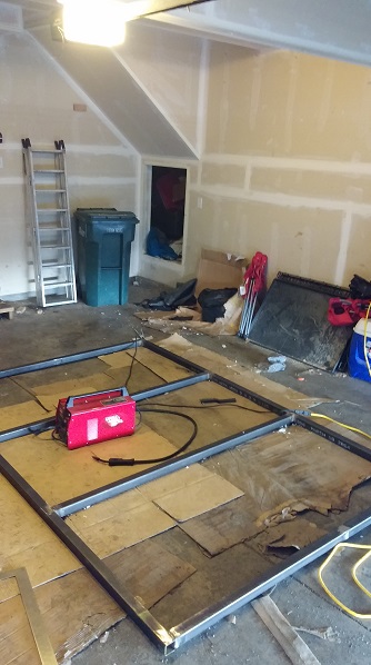

Postby Da'engineer » Sun Mar 15, 2015 12:15 am
And so it begins... Unfortunately all I could do today is get some of the metal cut and dry fitted my welder decided it the wire feed motor wanted to take a poop. So picking one up tomorrow and finishing up the frame.

Postby Da'engineer » Sun Mar 22, 2015 5:56 pm
Made some progress today didn't take pictures of the finished tongue. Been slow since I had to work weekend duty and long hours this week.
Still need to hatch the axle and etc. but that should be done by tomorrow night and will update as soon as possible
