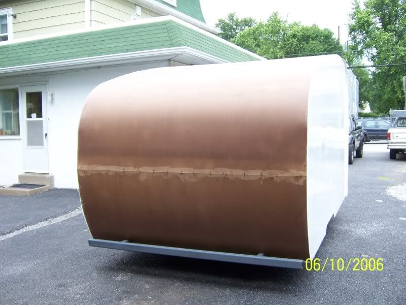

Postby len19070 » Sun Mar 08, 2015 6:16 am
Masonite is a great product to use as roof sheathing. I've been using it for years.
Its durable, economical and you can almost tie it in a Knot.
And Yes it does have problems when it gets wet, just like any other material.
The secret is when building a roof....Don't let it leak!
Same Kid, same trailer w/Masonite roof 20 years later.

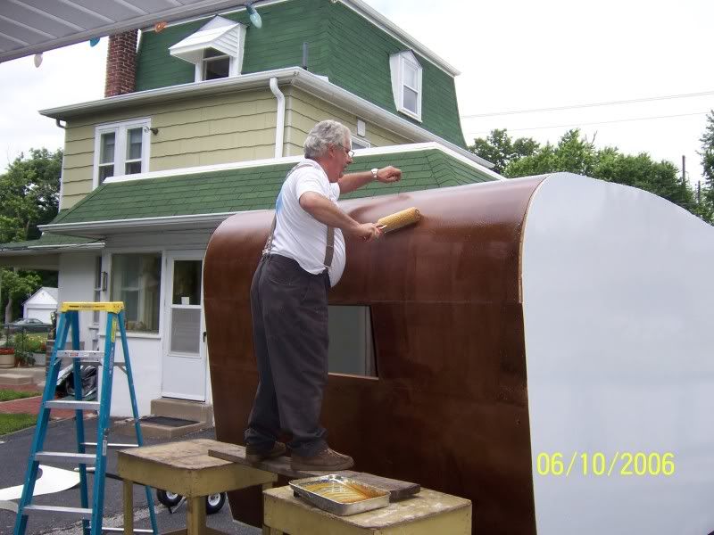

Postby Kaz » Sun Mar 08, 2015 6:00 pm
What sort of sealer is that your rolling on the Masonite roof of your trailer ?

Postby len19070 » Mon Mar 09, 2015 5:46 am
Kaz wrote:What sort of sealer is that your rolling on the Masonite roof of your trailer ?
Actually that's not a sealer, its the glue for the Filon. But I do coat the Masonite with Paint in all areas unless I'm using a Rubber Roof, then I coat the glue right to the Masonite, and use any kind of paint to coat the rest. Its just a sealer.
