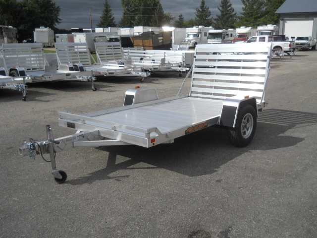

Image In order to keep the weight to a minimum , I purchased an aluminum utility trailer from Aluma Trailer in Iowa, the flatbed would be 6 ft wide and 10 ft long and would come with factory installed brakes. Once the rear ramp was removed the trailer chassis would be around 500 lbs

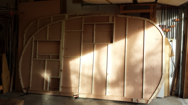

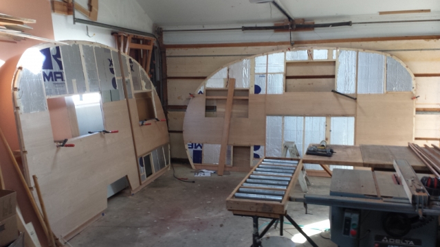

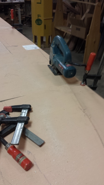

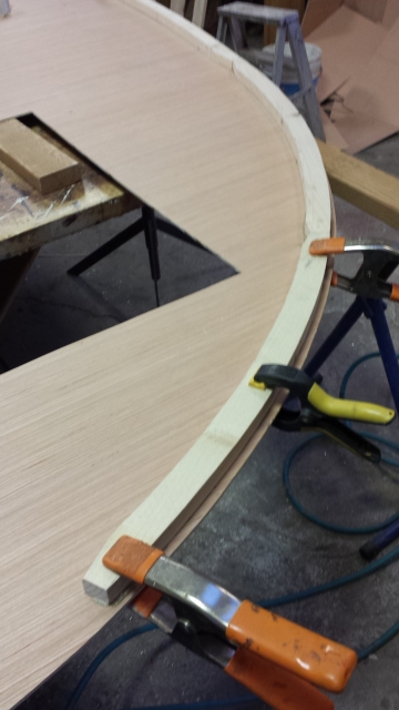

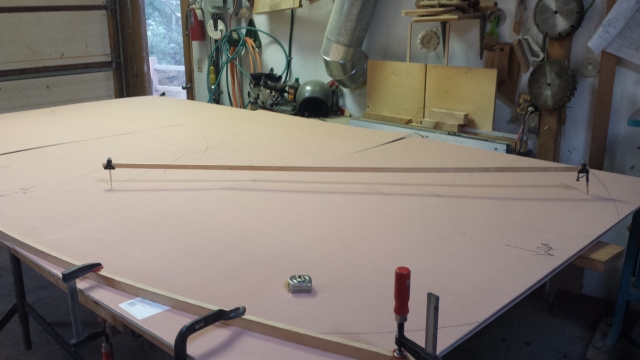

Unfortunately my trailer delivery would not be until April 7th , and I really wanted to use the winter to get a head start on the build ,, I decided that I would prefab as much of the structure as possible and then put it all together in short order once the trailer arrived. I knew there were risks involved with this approach yet I believed I would be able to make it work. I worked out a design on large sized graph paper using arcs of various radii and researched materials that would be as light as possible and structurally sound.Image I decided to use 103 in wide .040 aluminum from a tractor trailer repair company (Merritt) this would be the most durable and weather proof skin available and I would be able to cover the entire exterior In 3 pieces of metal. I found some 5.2 mm luan at Lowes for the substrate under the aluminum and purchased a dozen white wood (mixed spruce/hemlock/fir) 2 x 4 s for the wall framing. The 2by4s would be sawn into 1in by 1in studs and 1.5 in by 1 in top rail pieces.Image Using a trammel set to draw the various arcs on the luan that would define the curves of the trailer. Image Cutting the exact curvature of the side walls.Image Gluing the top curved rails to the luan with PL premium const adhesive. Image finished side wall with framing . the length of the box is 12 ft by 6ft 6in wide by 6ft 5in ceiling ht.

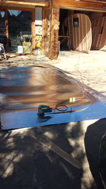

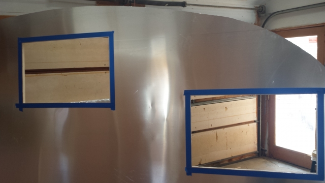

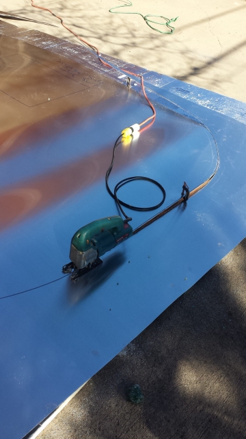

Once the wall panels were complete , I laid out two 6.5 by 12 ft pieces of aluminum in the driveway and laid the wall assemblies on top to trace the shape on the metal. Next I cut the Aluminum to size with a saber saw with a metal cutting blade. finally, I sandwiched everything together and put weight on top to glue the metal to both of the wood sides.Image Image Image The last photo show the outside of the wall with tape to protect the metal as I routed out the window openings ..

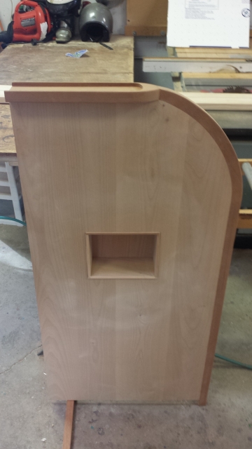

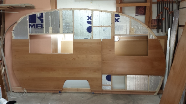

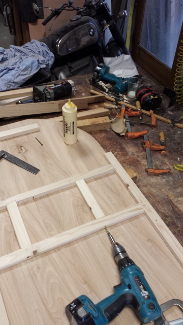

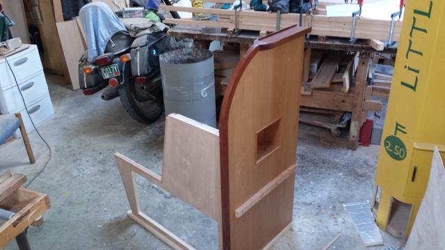

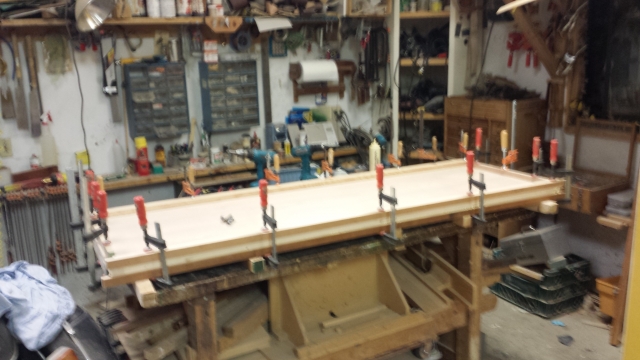

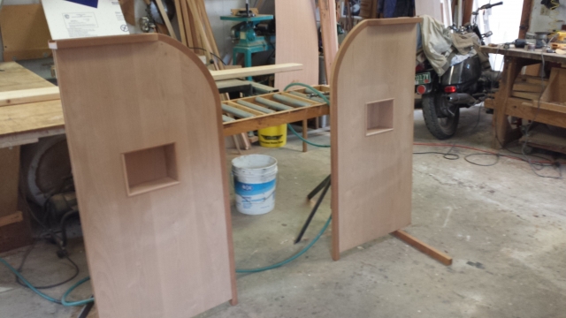

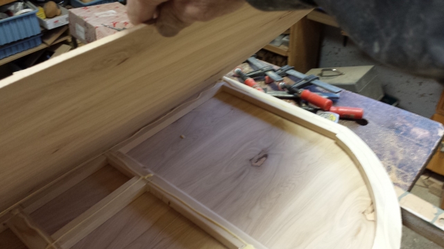

Here is a shot of the two side walls with insulation and 1/8th inch Alder paneling glued to the lower 2/3rds of the walls.Image I found some 1/8th inch alder sheet material at an RV repair place , they thought it was Luan but I noticed that it had a very nice alder face veneer. I knew this would take a nice finish , not be too dark and be very lightweight. I decided to build all the interior partitions seating and bed platform by constructing hollow core panels about 1 inch thick with rigid insulation sandwiched between two layers of 1/8 th inch alder. These panels would be exceptionally light ,very flat and quite rigid. Image Here Im fabbing the panel inner frame out of Home Depot white wood which is very light and rather fibery .... Image Laying the 1/8 alder onto the frame.... Image lastly the perimeter of the laid up panel is clamped and let dry. I planned to spray all the interior woodwork before the trailer is assembled. Here is one of the interior panels ready for finishing The edge trim on the panel is mahogany ... Image Image

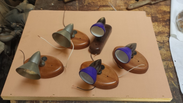

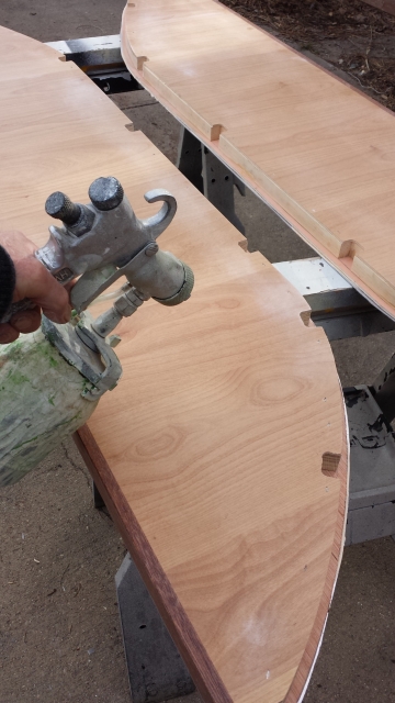

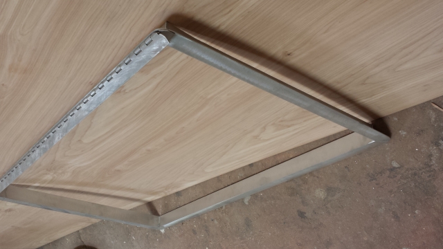

Spraying the Alder panels with ML Campbell Conversion Varnish Image The Alder paneling with finish applied Image The seating structure begins to take shape Image I custom built 5 LED reading lights using modified track lites Image One of the more dicey elements for this build is the shop built window units , I wanted larger than usual glass with a frameless exterior look. My concerns are mounting the glass panes to the aluminum hinge and making the whole thing watertight. Image
