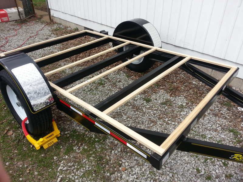

Today I busted out the chop saw and router. I got all of the pieces for my floor frame cut out and dry fit them on top of the trailer. I was hoping to have everything glued up tonight but I'm simply too tired after buying all of the wood yesterday. Anyway I think that the tongue and groove joins worked out great! This will make assembly much easier for me.
dry fitting the floor frame

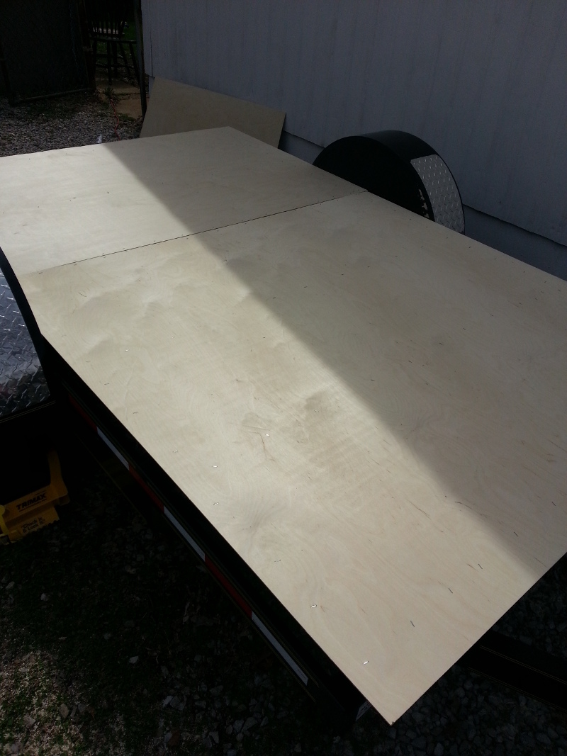

Thanks for the encouragement! I am slowly building more confidence. I glued the floor up last night and stitched everything together with 18g 1" brads. Right now it is in the kitchen floor weighted down with cinder blocks and milk jugs full of water. I'm going to take pictures and post them tonight.

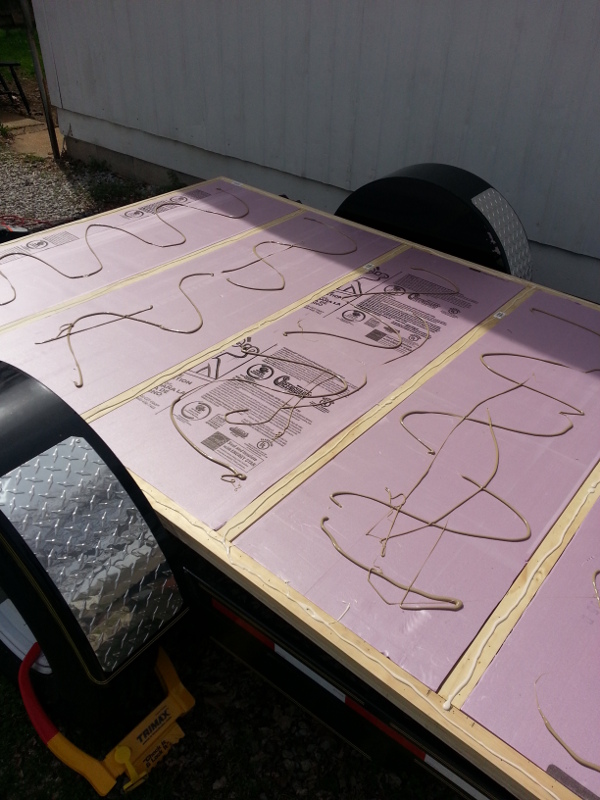

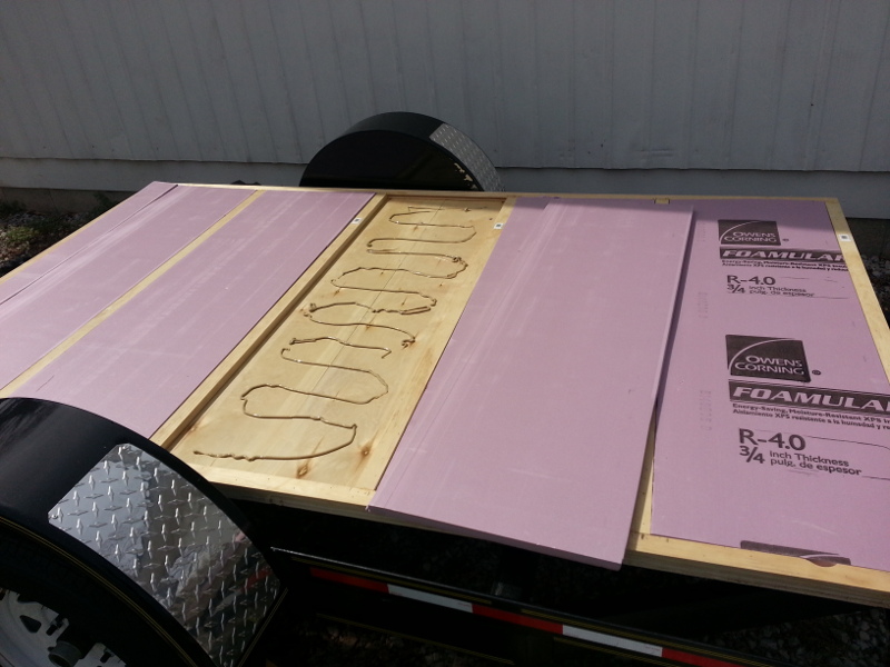

Today I glued the insulation panels into the floor and stapled 1/8" baltic birch to the bottom. Once everything is dry I will run my flush cut router bit over the sides to trim off the excess wood. There's two pieces of wood under the floor lifting it up off the chassis so that it's easier for me to use my router.

I used a combination of polyurethane and titebond III to glue the bottom of the floor in place.

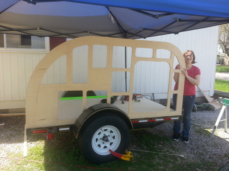

Cut out the framing for the side today. It was nice setting it up so that we could see the side profile for the first time. It came out exactly how I wanted it. I'm very pleased.

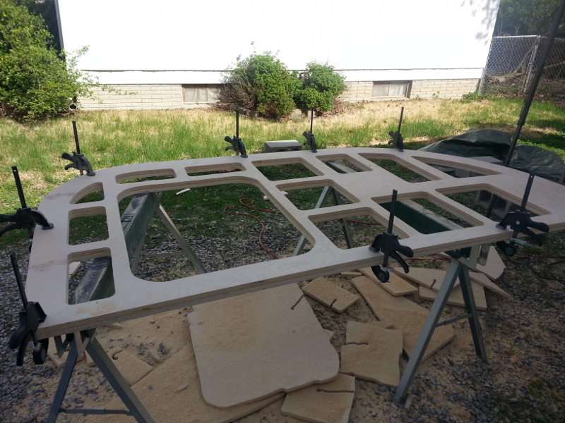

I laid the completed frame down on the saw horses and used my router to make a copy. I'm starting to think that a router is the most useful tool in wood working.
