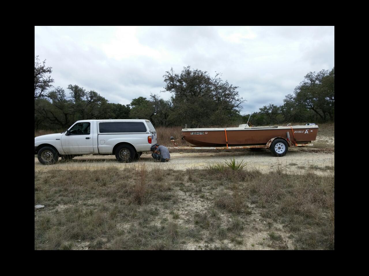

My free boat trailer. Only catch was I had to take the boat.

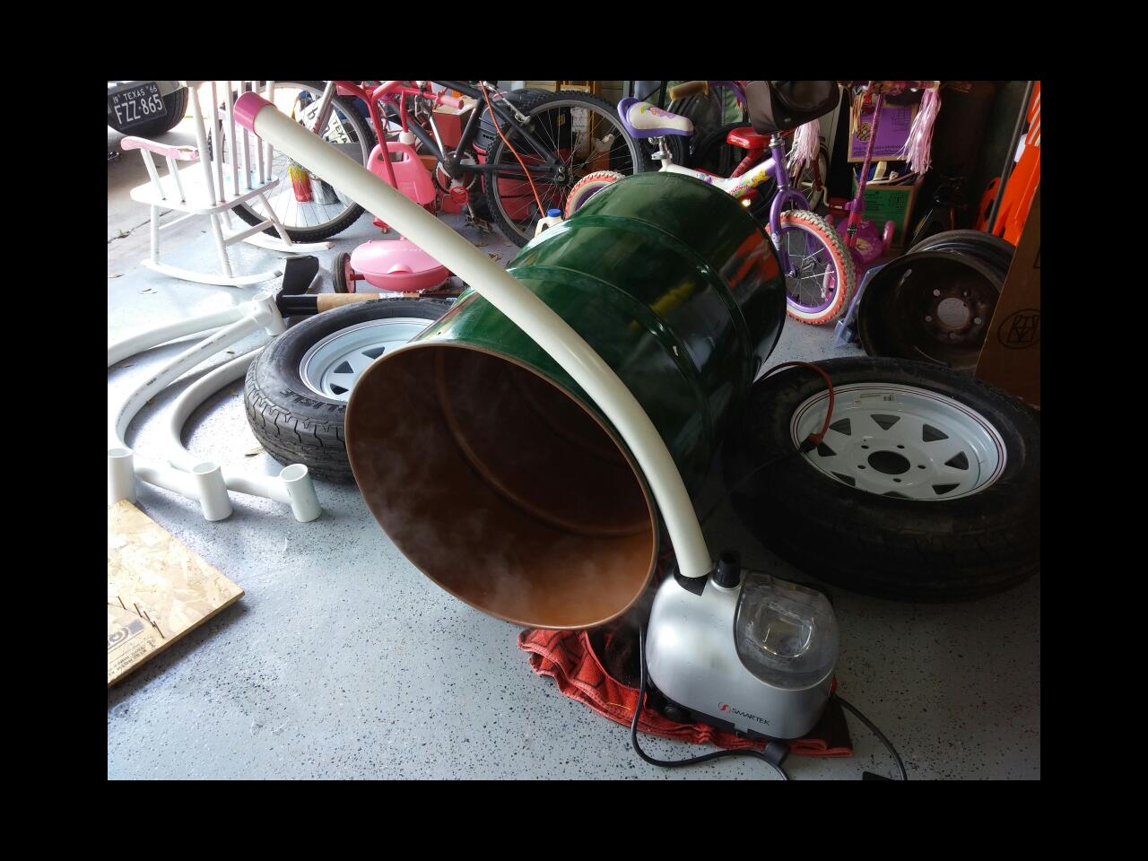

Here is my PVC bending setup.
I used a garment steamer to heat the pipe. A spray paint cap kept the heat in. A towel kept the steamer from rolling away and soaked up the buckets of condensation that rolled out of the pipe. 8 minutes was enough that the pipe started to just flop over the barrel. Some gentle bending with some heavy gloves was all it took to get them into shape.

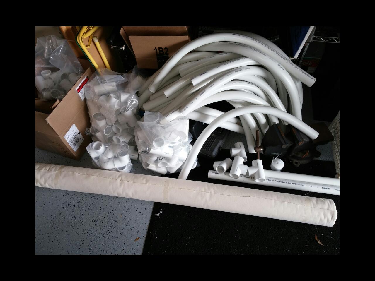

Here we have 24 corners, 110 Tee connectors, and a 64" roll of canvas from big duck.

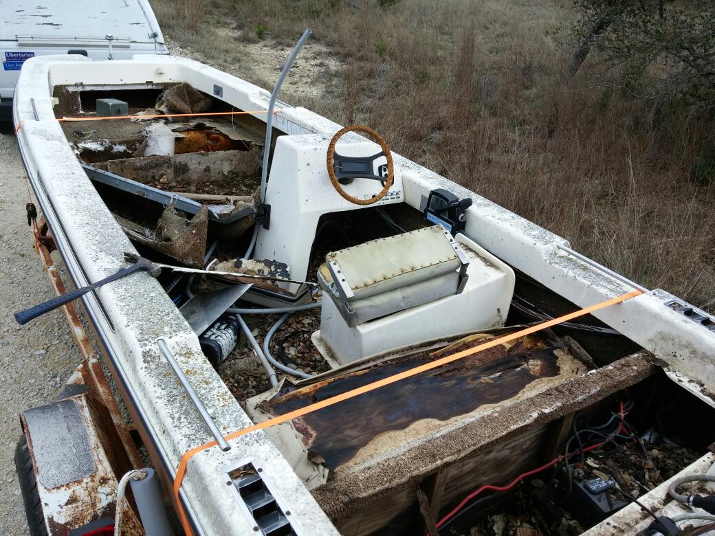

The boat was a peach.

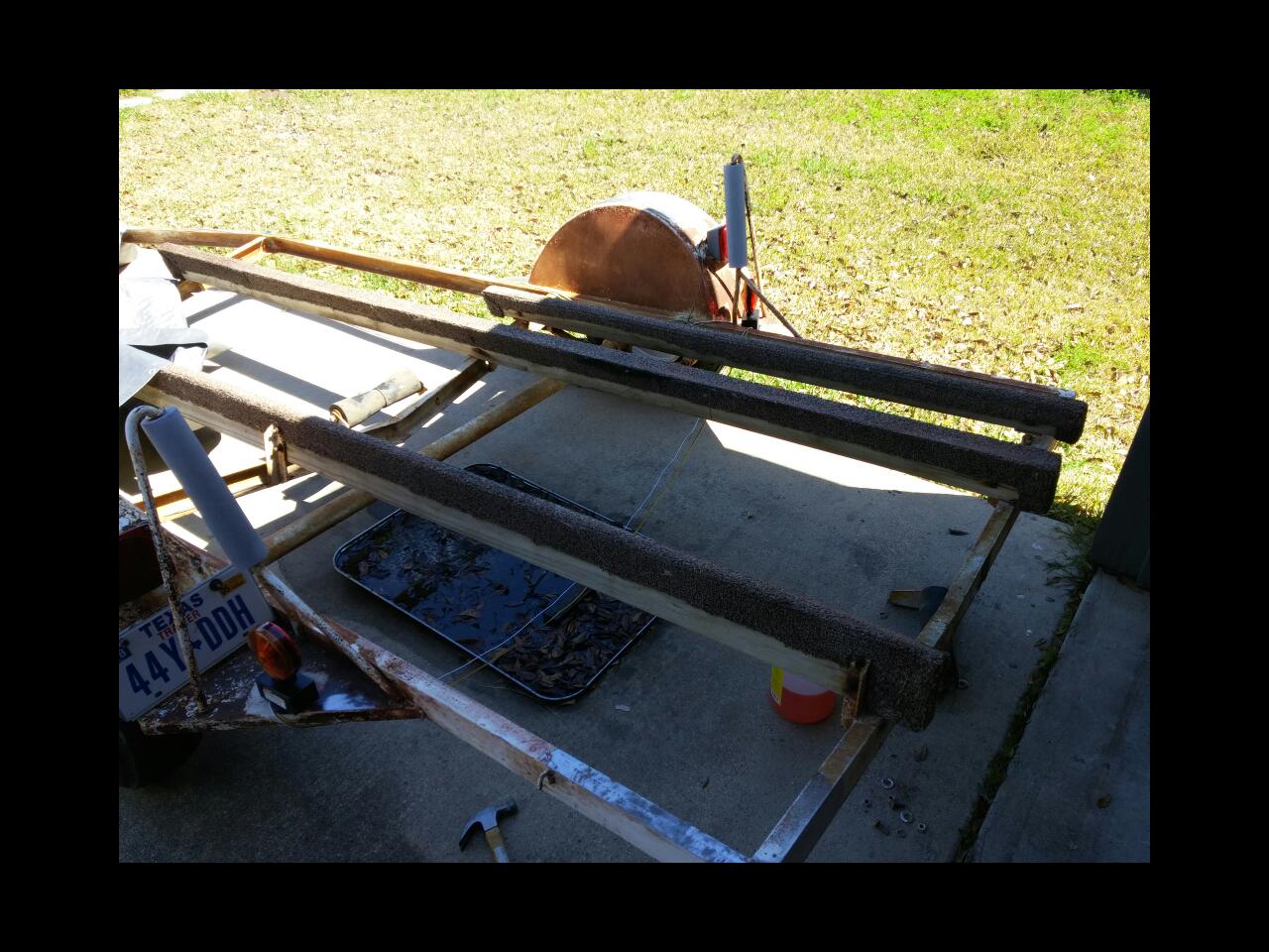

Losing weight with a cut off wheel.

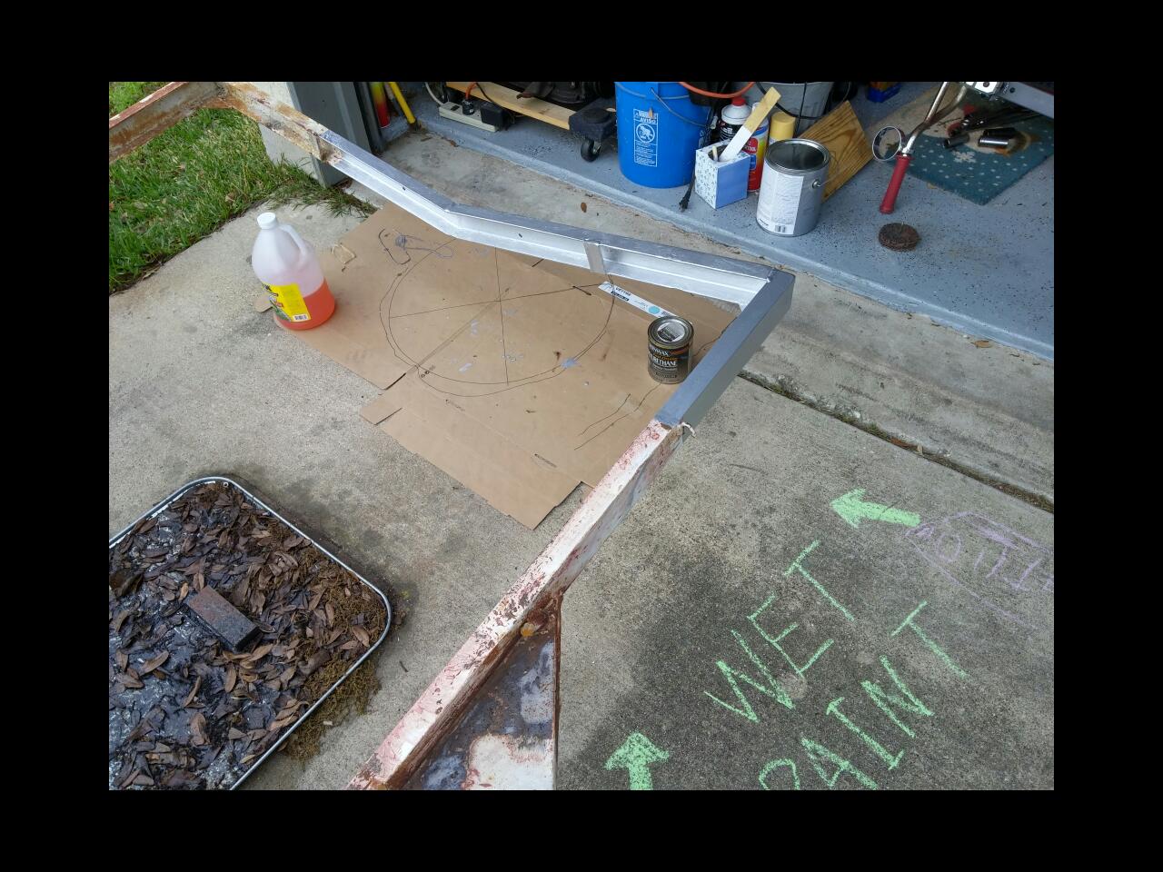

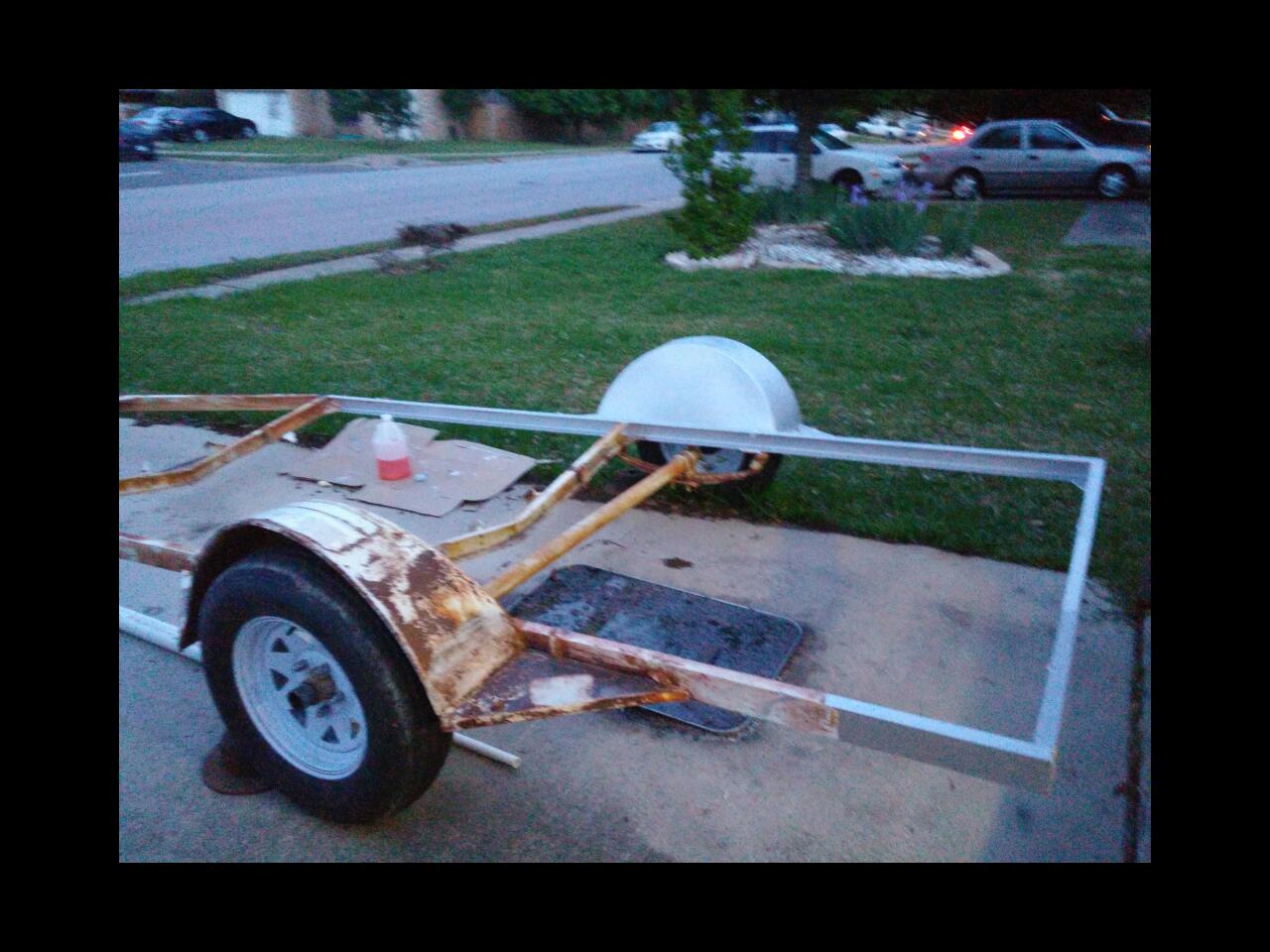

I've been plugging away at cutting all the boat stuff off of the frame. The down side of the free trailer is the amount of time I need to invest in refurbishing it before I can really start building. As this will be a mini airstream, I am going with the Rustolium Aluminum paint that turned out so nice on the big pink. Next weekend is my deadline for finishing the frame. Next weekend is also Lone Star Roundup, which is a mandatory event for me. So I'll continue to knock out a little section every day during the week.

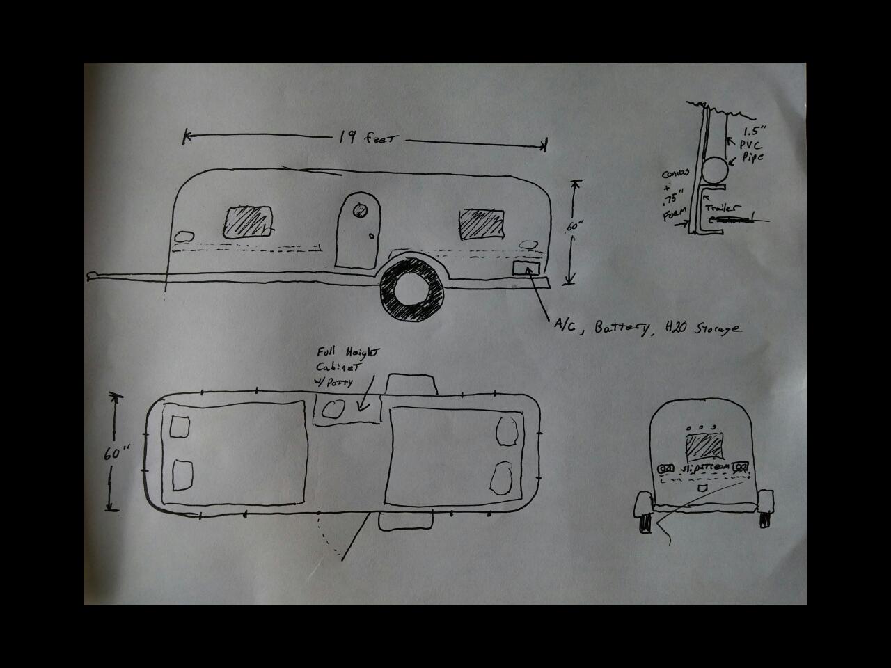

Here is a sketch of my concept. Just a sleeper for 4 with A/C and a kitty litter potty.
