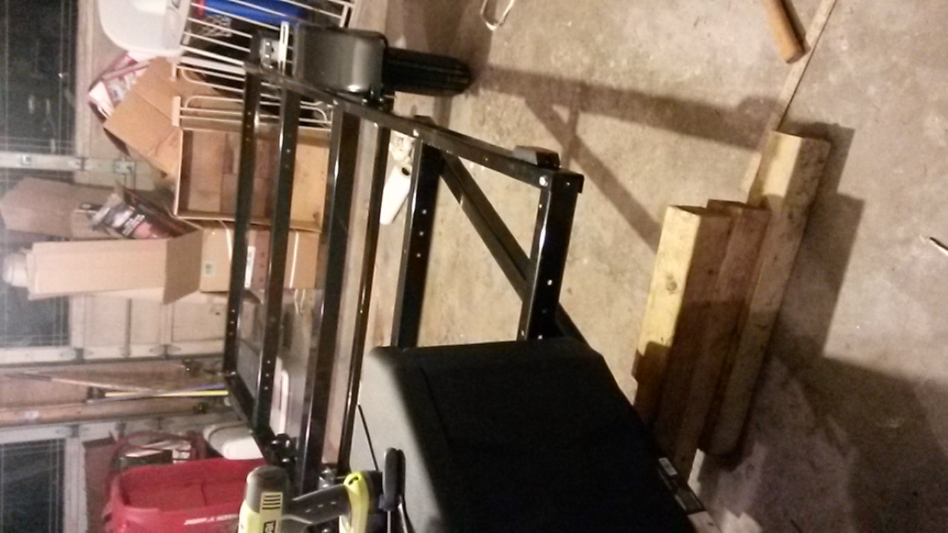

So, heres where we are now. Assembled the trailer frame

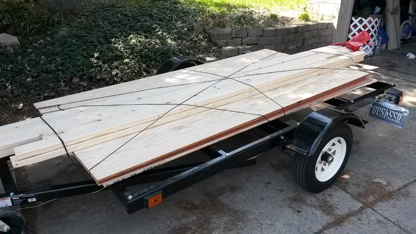

Maiden voyage to get lumber

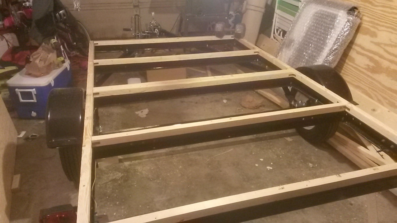

and framed up (last night)

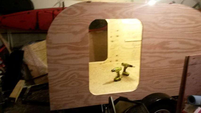

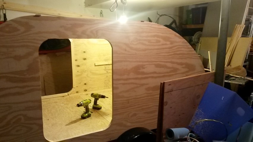

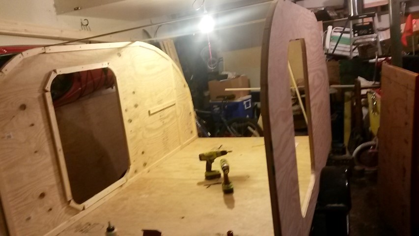

Had a friend over, so we placed the walls up. Have to build and place the bulkhead, wire, insulate and complete the walls but at least they are up!
starting to look like something at least!
20150530_210821 (Small).jpg (82.2 KiB) Viewed 13857 times
20150530_210824 (Small).jpg (70.8 KiB) Viewed 13857 times
20150530_210809 (Small).jpg (83.9 KiB) Viewed 13857 times
