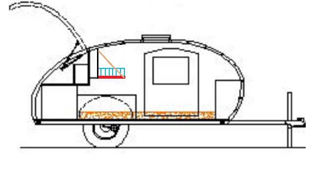

So a little thought on how we can still pull this off lead me to think of a Murphy Bed crib / youth bed that the soon to be 3 of them can use for the years to come. Taking the Grumman drawing and modifying the cabin side of the galley I came up with this design. Mom and Dad in the classic location with the "Murphy crib" above (red) The side rails (blue) will be removable for stowage .
Any thoughts / advise / criticism is welcome!

I like it! Nice find on the trailer. Is it going to be a 6' wide, as it looks like the wheels are inside the line of the walls? Also, i like the Murphy Crib setup. You could fold the side rails in on hinges, so it folds down flat for stowage & then opens up for use when it's in the sleeping position.
I know it's just a preliminary design, but I would use longer struts for the galley hatch, so the forces are reduced at the attachment points a bit. The closer you get to the hinge, the more the forces multiply and the stronger the struts & hardware need to be.

I like the crib idea too. But I hear babies come with a LOT of stuff.

I can't take credit for the Trailer design, only the thought of the Murphy Crib. The starting point of the drawing was the Grumman 2 I found in the designs section LINK here on TNTTT. The classic Teardrop shape is what we are after.
Hadn't planned on it, that is why I sought out a 5' wide trailer. I figured less frame mods that way. I can have the wheels outside the walls but with wider fenders.
I don't think Babies don't HAVE to necessitate huge amounts of gear, parents just think they do. Especially just for weekend outings. Daughter #2 and her Man tent camps with their 7 and 1 year old Daughters.

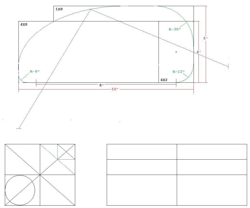

Since I do not have a Cad program, and even though I downloaded Google Sketchup a long time ago, I have not played with it much. I turn to my old faithful MS Paint program. Playing around with a square, double it, I had a "4 x 8" rectangle to then find the center and so on...breaking it down to 1 foot. That made circle of a known size easy to draw a radius. Ellipse was a little trickier but I got it.
I will use the Plywood stretcher post here to make a 5 x 10 side wall. Still playing with the Galley but you can get an idea of what I have in mind

Wow, guess attachments aren't automatically resized... sorry 'bout that.
So before I begin with the wall construction I needed to see actual door and window dimensions. Fortunatly, as some may know Northern Indiana is the heart of the camper manufaturing industry. Two S.I.L.'s and a nephew work at 3 different companies here. That said there is several "RV Salvage" companies in the area that have brand new OEM items from previous year models for a good price. While not the closest, my favorite is Bontrager's. Literally TONS of Surplus parts. A trip there after work yesterday and a bit of time searching yielded a 48" tall 33" wide prehung door with keys and a matching sliding window with screen and interior frame all for $80 plus tax. (future reference Filon is .70 per sq foot)
