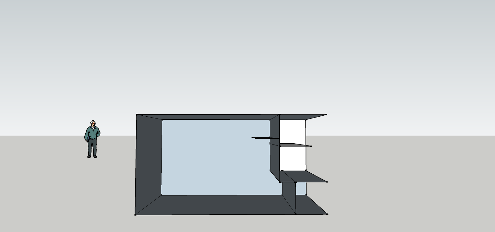

Inside cabinetry layout. I decided to not do a shelf over my head, I'll have my mom sew up a hanging bag kind of deal. That way no matter what there's nothing hard to bang your head on.

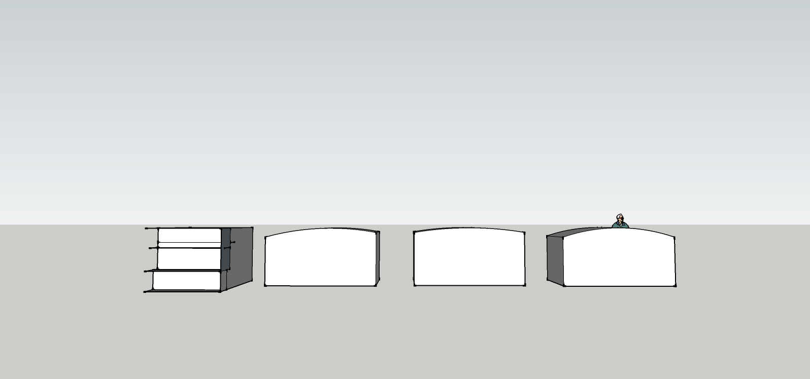

Three profile options I'm looking at.
