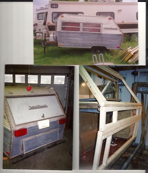

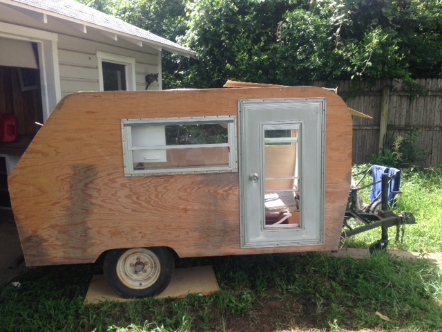

Nearly 20 years ago, I bought a Twilight Bungalow teardrop-style camper in Oklahoma City. It was the first teardrop I had ever seen in person—remember, this was pre-Craigslist—so I excitedly paid the asking price, which at $1000, was probably too much back then. I took it to a local RV repair center where they quoted me a good price to redo the whole thing, but once they removed the fan from the roof and got a look at the water damage, they backed out. My father found a carpenter that redid the galley area—all of that wood had rotted. Then my father and I built new sides, installed a new counter for the galley, and basically stopped there, as I was moving from OKC to New York City. The bungalow lived in a friend's garage in Fort Worth for ten years, then in my brother's afterwards. I now live in Los Angeles, have a seven-year old daughter, and I'd really like to fix it up to take her camping. I'm back in Fort Worth for the next two weeks and really want to work on it. But I am scared, as I don't necessarily have lots of skill when it comes to woodwork. So I'm trying to draft a friend or maybe hire a carpenter that could help me.

As I mentioned, my father and I made new sides out of 1/2" plywood. When I worked on this years ago, I put in new paneling in the interior. Those didn't survive my brother's garage, plus, I put in cheap paneling, so I want to change that out. Should I add a 1/4" birch panel to the 1/2", or make new sides with a 3/4" panel that has birch on one side that I could stain?
Also, we put the panels up with a staple gun. Seems like there has to be a better method than that. I also did a poor job on the cabinets—I had just purchased doors from Home Depot, so I want to redo that as well.
You might be asking yourself, "Why are the windows and door installed when you haven't even skinned it?" The answer is that my brother had a roommate that thought she was helping by doing so.

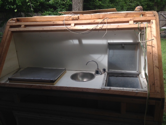

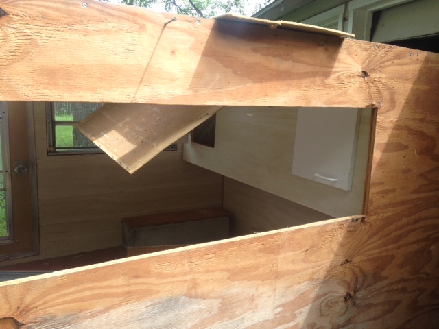

Here's a look at the galley.

When I took the Bungalow apart, I discovered that there was only insulation on the roof under the metal - there was nothing on the sides. If I install insulation, I will lose some space in the interior. Thoughts?

APCROSS wrote:When I took the Bungalow apart, I discovered that there was only insulation on the roof under the metal - there was nothing on the sides. If I install insulation, I will lose some space in the interior. Thoughts?
I think it depends on what your ultimate goal is. Either to restore it complete or make it more useable. If it's the later by all means add insulation. Of course this is coming from a desert dweller that puts on a sweatshirt when it drops below 60°. :D

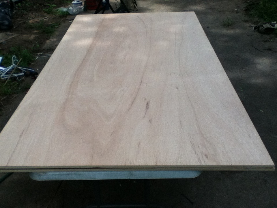

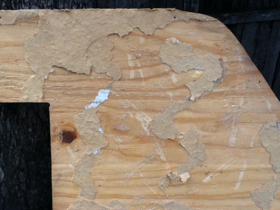

So I decided to replace the walls - the plywood wasn't that bad, but after removing the old panels, old glue was everywhere.
Rather than scrape it off, I ordered two new 4' x 8's by phone from Home Depot. An hour later, it arrived. $20 delivery fee. I call that a good deal.

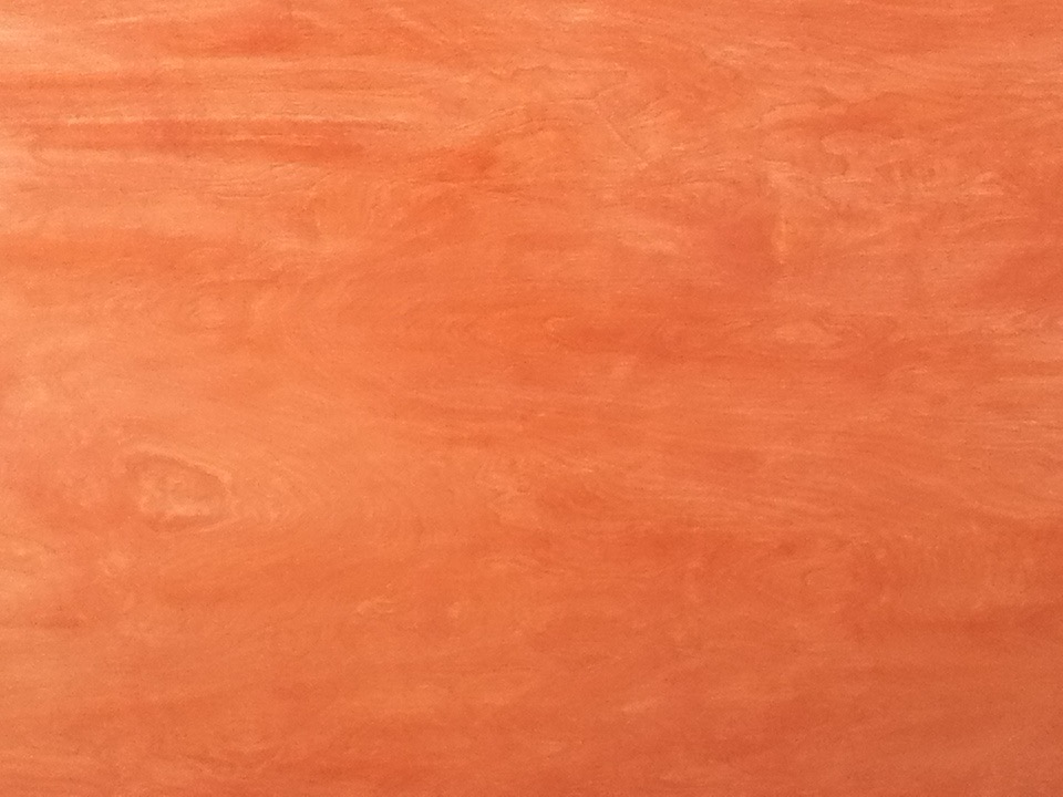

I stained my 1/4' birch panels, then glued them onto the new 4' x 8' walls. I put on two coats of clear poly; I'll do another coat or two until I get the finish I want.

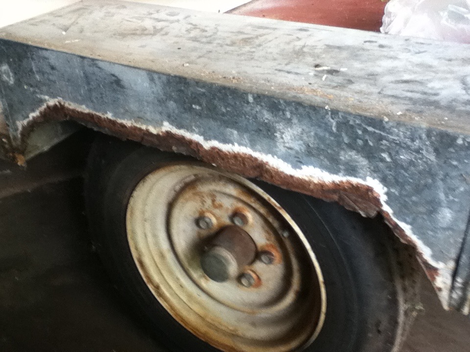

When I removed the walls, I discovered that the wheel wells were rusted in the front, so much so that the metal breaks off in your hand. I don't know how to fix that, so I am going to see if I can find someone to make a new set. Or perhaps I can find a pair new that would fit? Any suggestions appreciated.

If you don't like any of the quotes you get from metal fab shops, try HVAC shops that do duct work. That type of galvanized "tin" with knit corners is right up their alley.

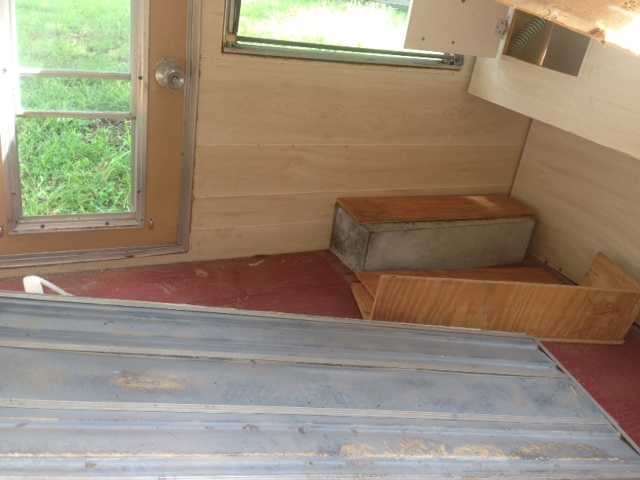

So, after a two-year hiatus, I am back in Fort Worth for more work on my teardrop. I have three weeks here, and I hope to get in good enough shape to possibly tow back to California where I live now.
