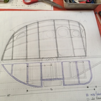

hey all ! dave from victoria bc here. OCD has struck again and the latest incarnation is a trailer. this i what i plan to build.....
and these are my rudimentary, early plans.....
plans 2.JPG (45.84 KiB) Viewed 6014 times

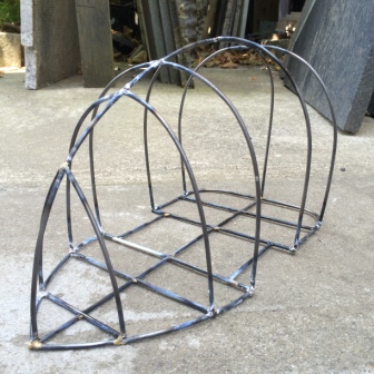

the maquette.....
frame model 1.JPG (67.38 KiB) Viewed 6014 times
i have countless hours of failing at many things, and the patience to go with it, and even though i have not built a trailer on my own (helped with an awesome teardrop last year) i don,t think i have bitten off more than i can chew. i have yet to do due diligence on material weights, and whether my pace-america cargo trailer deck can handle it, ( i used to load it with pallets of cement and/or marble and tile ) but i will cross that road soon. plenty of appropriate parts out there !! metal for the framework has not been bought yet. hoping the axle is not too far forward as i have the unit planned out, , and hoping i choose the right gauge steel for the frame (.065 1" square for the base, and 1' round for the ribs) AND hoping the trailer gods grant me the stamina and luck to complete this !!

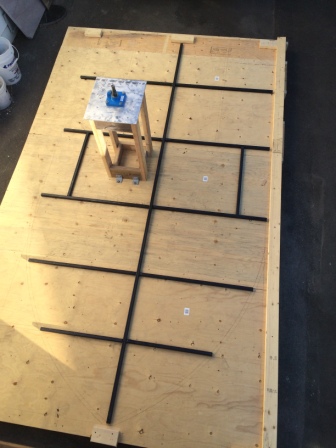

Postby dave campbell » Fri Jul 17, 2015 5:30 pm
islanders yay !!! me? westcoaster all the way, but my campbell ancestors landed at cape breton 8 generations ago !! today's update----started the life-size layout on the stage. also ordered the metal---460 bones gets me the platform and rib cage delivered to my door, including taxes. the weight of the cage will come in at 250 lbs, minus some. the cargo trailer i am using as a platform has a maximum capacity of 2210 pounds, so i have quite a ways to go for overload !!
thanks for looking ! :beer:

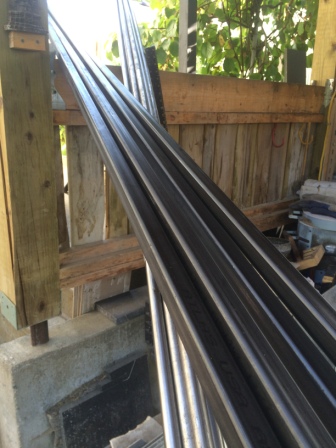

allrighty !! metal for the frame is in the house !
metal delivery.JPG (73.22 KiB) Viewed 5562 times

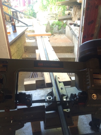

and the band saw is set up.....
and away we go
frame start 1.JPG (59.8 KiB) Viewed 5562 times
that thing set up there is the base for the tube bender--proving to be woefully inadequate for the 1" square tube. it will be fine for the 3/4" round, though.
thanks for looking :beer:
