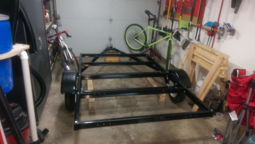

Trailer assembly nearing completion! Going to have to put a claim in for one fender bracket but all the rest went together good. Now to create a longer tongue and looking to stretch the trailer out for a ten foot design.

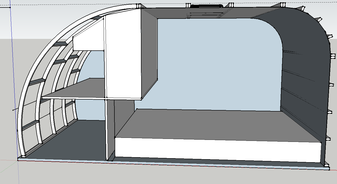

Here is a Sketchup model I have been working on. I am just learning the program so I know there is probably some faults but the purpose of this drawing is for a rough layout and making for a sturdy structure.

Postby KCStudly » Mon Aug 03, 2015 8:56 am
I think it would be better to have the lower edge of the hatch close against the back edge of the floor. That way water will shed down and away with less chance of pooling on the edge of the floor.

KCStudly wrote:I think it would be better to have the lower edge of the hatch close against the back edge of the floor. That way water will shed down and away with less chance of pooling on the edge of the floor.
KC,
I agree. In my defense I had not progressed that far as to correct that flaw in the drawing. I just wanted to show some progress and get some opinions on my design so far. I am really leaning towards canvassing the exterior and going with a high build percentage of foam. Is there some design tips I should work in for making the canvas process more seamless?

I am still a little stumped on the whole trailer stretch thing. I am looking at stretching the trailer out 2 feet or very close.
Option 1:
I have thought long and hard about whether or not I should cut the side rails before the leaf spring mounts and stretch the trailer using one or two of the cross beams and then replace the utilized cross beam(s) with 2x4 studs.
Option 2:
The other idea I have had is to build a 5x2 structure from 2x4 studs and attach it to the rear of the trailer and then move the axle back by drilling 4 new holes in the bottom of the frame rail. I am not too concerned about the idea of moving the axle but as I am typing this I feel as if option 1 is a better choice.
For reference I plan to flip the hitch mount and run a 2x2x 3/16" square tube as a tongue and to sturdy up the A frame. Also I am pretty stuck on the idea of building a foamie or mostly foamie. I really want to have the rig max out some where just under or at 82" tall and 70" wide and 120" long. I am either going to use 2 inch foam or laminate two 3/4 panels and construct a 3/4 skeleton for strength.
