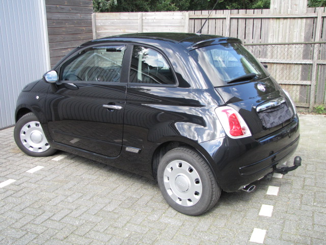

My starting point was my current car.
Or better, the size of it. I own a 2010 Fiat 500 (Eurospecs) 1.2l dualogic (semi automatic, or robotised manual gearbox) with 69hp.
Quit small, and yes they can come with a towbar...
Impressive on the small Fiat 500 (at least in Europe) is their in comperisson quit large towing capasity.
For a car that weights about 875 kg, you have a max. towing capacity of 800 kg (braked), or 400 kg load unbraked,
with a max towing ball weight of 60 kg.
I don't really know if you have to want that on such a small car, but it is perfectly legal here.
That is a lot for such a small car here in Europe.
I have to admit that i like some smaller class of cars. I dont really need one, and have no feeling to compensate things with a big car.
Nore the money either in that prospect... :roll:
So my next vehicle wil probably be a small one too.
So my (to build) teardrop trailer must be rather small too.
Even more, i didn't want the teardrop to be (much) wider than my car body. By that i mean inclusive the width of the wheels.

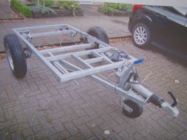

Postby smeerkees » Wed Sep 09, 2015 2:33 pm
Meanwhile i kept one eye open on the Dutch selling sites if i could find a (for me) suitable trailer or trailerframe for the start of my teardroptrailer.
This ment size (lenght, width, and max. mass.) wise , brakesystemwise, wheelsize wise, quality of the frame wise... etc.
You guesst it already, that took a while.
But after some 6 months or so i found a possible candidate.
And somewhat affortable too.
Edit: For uploading some of my older pictures, i had to make the files much smaller.
And since my computer skills aren't much better than my spelling skills, i had to do it the hillbilly way.
And yes, that included printing the old picture, and photograph the print in a much lower resolution...
But, ...result.
This was the situation in wich i purchased the trailer (chassis).

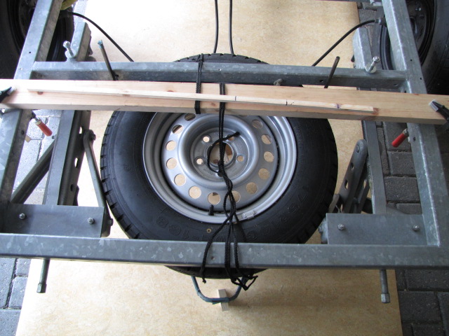

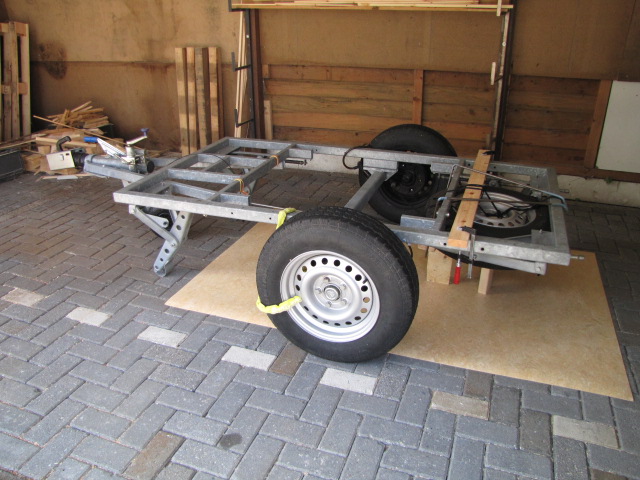

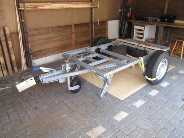

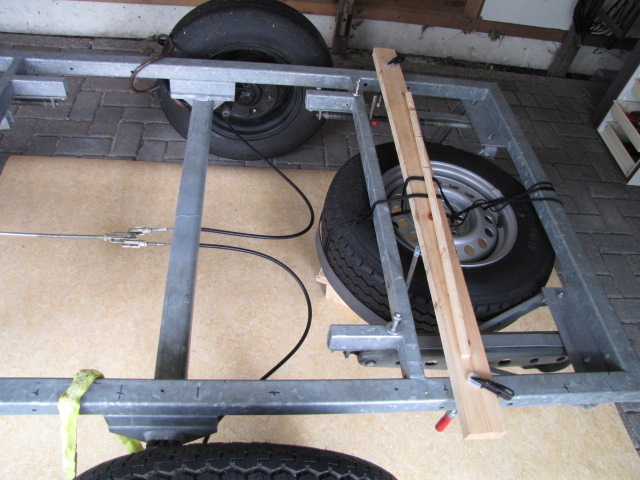

Postby smeerkees » Fri Sep 11, 2015 10:10 am
This is how the trailer chassis looks about today.
Build wise, it looks if there has been not much going on, and in a way thats correct.
But there is more done than meets the eye.

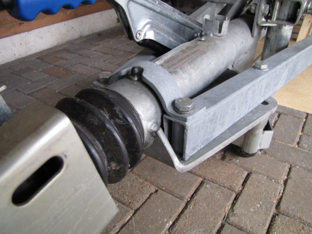

First of all i reposisioned the towingbarframe (bracked) from on top of the A frame beams,
to under the frame beams.
I had to cut a little of the front of the A beam, so the towing bar sits now between the A frame bars.
Miraculously it fitted quit well.
The handbrake lever in downward position clears the A frame by just a couple of millimeters.
I also made a couple of bushings to put in the inside of the A frame for some extra strength by tightend bolds, plus an extra brace
on top of the A frame for extra stability. That last one was a bit difficult because of a grease nipple just under the brace.
Now i know how to upload my pictures on the forum i will make some detail foto's of the towingbar situation.
Now maybe you guess what kind of towing bar i use on the frame.
In the Netherlands we don't use the electric type of trailerbrakes you have in the states, but a kind of push brake system.
When you push the brakes of your car, the trailer wants to push you forward. That forward momentum is used to pull the brakes of the trailer.
Now the trailer stays much more horizontal behind the pulling vehicle.
On top of that, now i can modify the horizontal stand of the trailer much more easily when changing the pulling vehicle.
Unscrewing some bolds, and add some spacers will be enough.
The Fiat 500's towing knob is rather low on the car, that was the main reason for this rebuild.
Previous the trailer had a kind of ducktailstand with the backside of the trailer more than 8 centimeter higher than the front.
In my opinion butt ugly, and also much more unsafe to tow.
In the "ducktailstand" a trailer is much more subsebtive for "tail wagging" situations.

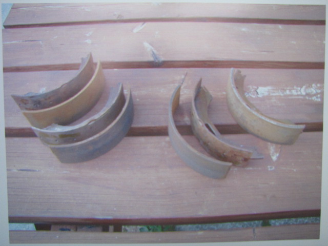

Towing my trailer to its current build place, i had my first breakdown already.
:o
My first learning moment for trailers you might say.
I was driving for about 200 meters (...) when i heard a loud klunk noise followed bij a screatching sound from a tire on asphalt.
When i looked into my mirror i saw that the left wheel of the trailer didn't roll anymore...
Bloody h#%% that is not a good beginning for my teardrop relationship.
I already got an idea what happened, and it had nothing to do with the wheel bearings.
So after i got the combination home i took off both the wheels, and brakedrums for inspection.
And yes, my suspitions turned out to be true.
Each wheel has 2 braking pads in the drum, and by 3 of my 4 brakingpads (!!) the glue between the brakingshoes and the rest of the pads
had come loose. So a loose brakingshoe turned with the rotation of the wheel, and got stuck between the next brakepad, and brakedrum...
Strangely the brakedrums, and brakepads as well as the wheelbearings looked as new. And were still the factory ones from the build.
Luckily i was doing about 15 kilometer per hour when it happened.
But what really happened?
As it turned out the trailer i bought was used as demonstration trailer for years at a dealership, but never used on the road.
When i bought it much later, and from the second owner, it had still never been on the road, but the one thing witch was used for all those years was the handbrake system.
Appearantly the glue between the brake shoes, and the rest of the brakepads will come loose after long periods of use of the handbrake.
Also the brakeshoe's are only glued. My assumption was that this kind of brake shoes were glued, as well as "rivetted" like the brakeshoes of a truck.
As it turned out they use glue only for years already for drumbrake pads on caravans, and light trailers. (At least in Europe.)
(In retrospect, i had heard a very minimal sound of brakepads touching a brakedrum already. My thougts were i had to re adjust the brakepads, and braking cable, and perhaps grease up the brakingcable, the slidingboom of the towingbar, and pivotingpoint of the brakingbevel. But that was not the case here.)
This is a 1500kg. (about 3300 pound?) rated axle with matching brakesystem from BPW. A big German axle company.
There products meet all the required standards as such.
So when you park your trailer for a longer time, put something before, and behind the wheels, and don't use the handbrake.
(Remember this is an European system. Usa rated systems may be very differend).
For me, (for hobby coming from the vintage motorcycle world), it was an eye opener.
Greets Kees.

Postby smeerkees » Sun Sep 13, 2015 9:48 am
pchast wrote:Kees,
The type of brake system you describe is called 'surge brakes' here. I've
seen it done with Hydraulic or Electric actuators on boat trailers.
I'm surprised by the bonded brake shoes separating on you. I'm glad
it wasn't more serious.
Hello pchast, (Pete)
Ah, it's called a surge brake system. I didn't know.
However this system is a little bit different.
It doesn't work with hydrolics, or electric actuators,
but is purely mechanical, and works with a sliding pipe in a pipe, a rebounce spring, and the rest with pullrods, and cables.
The handbrake system uses the same pullrods, and cables.

Since i really wanted to tow a full size spare tire with the trailer, i have got to improvise.
Width wise i have exactly what i need next to the leveling stands. (In both outward, and inward positions).
Idealy the spare wheel would be mounted a few more inches backwards in my opinion by the lengthning of the chassis, but it is what it is.
Length wise, when i would have a small pivoting rotation point when lowering the spare wheel to the ground, i am in shape.
Since it is the only place i can hang it under the frame, i have to give it some extra time and thoughts.
My currend (second) attempt looks promissing yet...
You have to know the chassis will be lengthened about 14 cm (about 5,5 inch) at the back, and widened some 20cm (about 8 inches) each side.
So at the final width the wheels are for about 90% under the body.
I will need some fendering, but still the body width of the trailer is still a bit smaller than the body width of the pulling vehicle (my Fiat 500).
This way i don't need extra width mirrors on my Fiat 500 while towing the trailer.
These are exactly the floor ( base) measurements of the 8x5ft. grumman 2 design.
The open space between the axle i want to use for some extra storage space under the trailer floor,
And on the front of the trailer, under the chassis, the pullrod of the breakingsystem is in the way for such a big spare wheel.
No problem, it is probably a great space for a battery. (or two). That gives me some way for balancing out the weight on the pulling knob
at the end of the build.
Greets, Kees.

Speaking of my towing vehicle.
Here is proof that the Fiat 500 can come with a towingbar...
On the picture the car has still the european 7 pins connector.
In Europe useable for small trailers, and bike carriers.
(The European 7 pins system is significantly different than the Usa spec. 7 pins systems.
The more versitile systems for for instance caravans, etc. contain 13 pins (european specs).
And because i want to be as versitile as possible connector wise, i have already a european 13 pins connector system ready.
But will be mounted later on in the progress.
A 13 pins connector system here contains among others a continuous + wire, and a + wire over the cars contact switch, in comparison with our European 7 pins system.
Greets, Kees.
