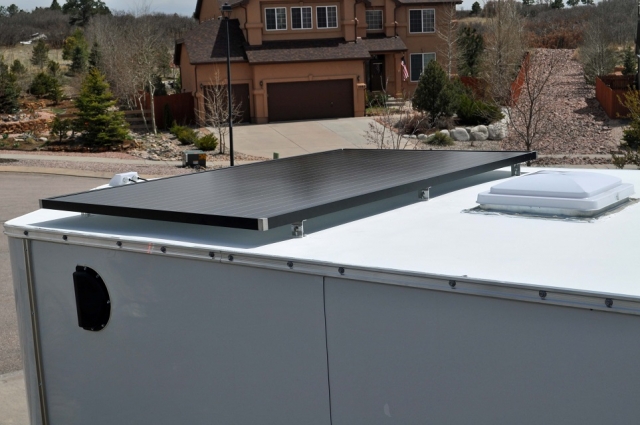

I've been making a lot of minor adjustments since completing most of the build. Just added a major addition, a 270W solar panel and MPPT charge controller. Also coated the roof with Henry's 587 roof coating.
