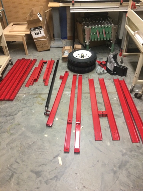

I went to Harbor Freight and was able to find a 4×8 utility trailer for a great price. The next day I had it in the school ready to go. It came in two boxes.
I unloaded everything and sorted It out.

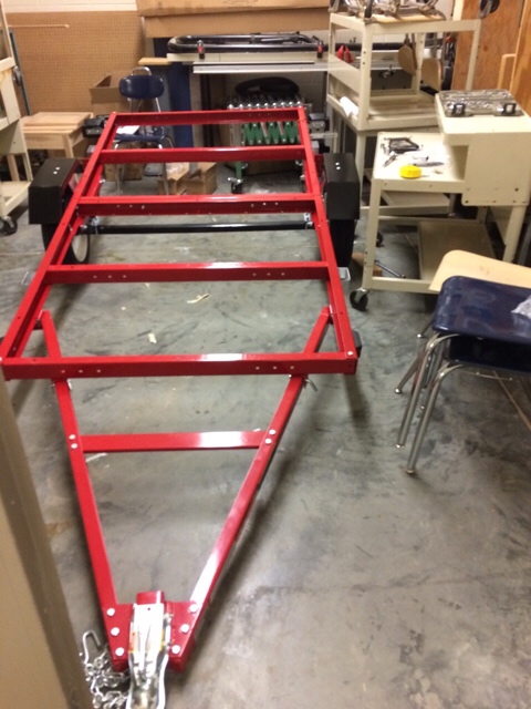

It is actually designed to be able to fold in half for storage, but I really didn’t need that. So, I implemented a few minor modifications that I think will reinforce the middle where it is supposed to fold. After a couple of days of putting the puzzle together, I had most of the frame put together.
All I was left with was the axle and wheels, and this is where my inexperience began to shine through. And by inexperience I mean that the extent of my mechanical knowledge lives and dies with changing a tire on my car. But, with this thin, I was supposed to unpack the hub and repack the bearings and blah blah blah. I struggled for about an hour before I called in the reinforcements… the hicks. With a couple of my redneck friends, we got the trailer to the finished product that it should look like.
As far as the trailer itself is concerned, all I have to do is wire the taillights and turning signals, which I also know nothing about. Luckily, you can learn anything in the world from Youtube, so I plan to tackle that on Monday then go to the lumber yard and begin the build. Big things.

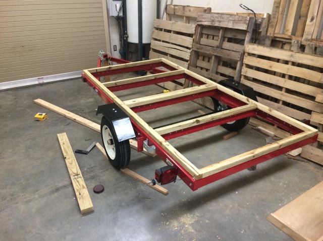

I don't really have a time parameter for this build, I just do as much as I can in the time I have. This week, I was able to wire the trailer and build the floor joists.
I know as much about wiring a trailer as...well, I just don't know anything about it okay.
Thankfully, you can learn anything imaginable from youtube.
Harbor freight supplies you with some super cheap wire and really stupid splicers and wire nuts. I would probably suggest buying your own stuff if you choose to do a build like this. I am going as cheap as possible on this one though, and miraculously all the lights worked when I tested it out.
The other thing I was able to manage was begin the wooden frame of the floorboard. I bought 2x4x8 pressure treated boards and ripped them into 2x2s.

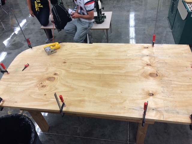

The next step was the walls. Cutting the walls has been the best part so far because It is allowing me to see what the shape is going to ultimately be. Also, all of the kids that doubt the project are beginning to see that I might actually be able to pull it off.
I clamped the sheets together, drew out my shape, and cut it out. Simple, right? No. The curve of the teardrop meant that I couldn’t use a compass or a ruler, leaving me to freehand the shape. When it was finally cut out, it looked all janky and uneven, but enter the belt sander. Using a high quality belt sander, I was able to smooth out the sides to give it the classic teardrop shape I was going for.
While keeping the sheets clamped together, I cut out the door and pre-drilled the holes for the studs to go in around the curve. After that, It was time to dry-fit it all together. To my surprise, it actually looked like it was all going to work out.

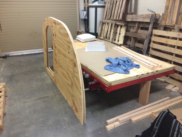

Postby hpuckett4 » Sun Sep 27, 2015 2:33 pm
The first thing on the task board this week was to go purchase handfuls of bolts to secure the floor to the frame and the walls to the floor. I bought 4" bolts for the floor and 2" live bolts for the walls.
IMG_4961After the tedious task of tightening all of the bolts, I grabbed another student to help hold the walls up while I bolted them into the floor. Then on to the spars.
The spars are made out of 2x4x8 stud boards that I ripped in half both ways. Earlier, When I had cut out the walls and still had them clamped together, I took the time to drill the pilot holes for my spars, a move that I am now very grateful for. Doing so ensured me that the spars would all be square, all I had to do is add some glue on each end and drive in the screws.
Week 4: With the spars In, I was very eager to get the interior skin on. For the skin, I used 3/16" multipurpose ply from Home Depot. I had to cut off about an inch and a quarter off the long edge of the plywood in order for it to be flush with the walls. It was a slow process getting it to bend to my 20" radius curve. I let is bend overnight and for half of the next day, gradually clamping it tighter so It wouldn't crack on me. Unfortunately, my patience grew thin and I decided to start gluing a little prematurely.
It cracked on me a little, but nothing significant enough to be noticed from the inside. To glue it, I attempted using construction adhesive, but apparently I didn't cut the hole wide enough and the caulking tube burst after only gluing one spar. Time for Plan B. Next, I decided to use Titebond III, it ended up working fine, but was very messy and much too runny, especially in comparison to the quikrete I was using earlier.
Eventually I pulled it off. Using an assortment of pieces of scrap to hold the skin up, it secured pretty well.
