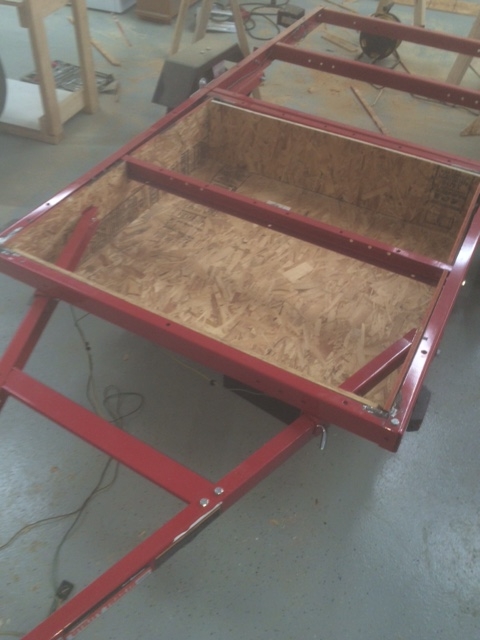

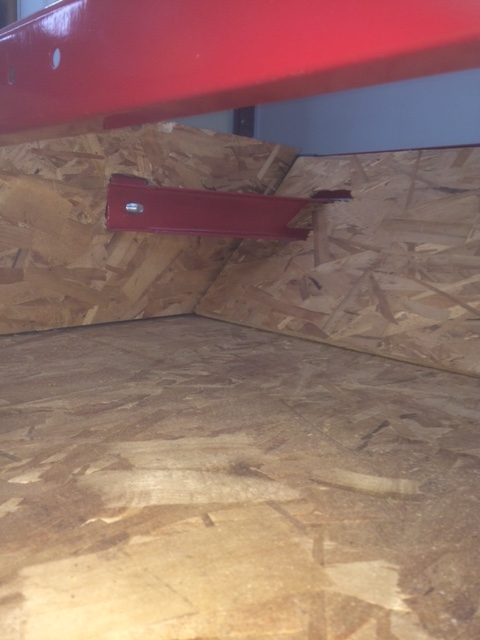

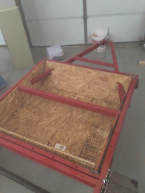

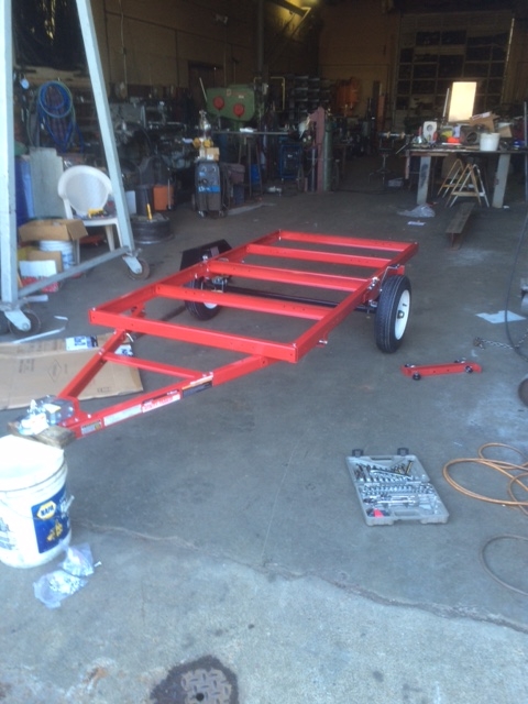

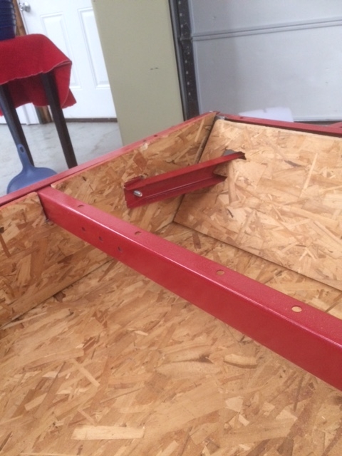

Okay, Day one: Trailer Assembled! It took all day bacuase I spent a lot of time considering the design. I also started cutting some angle iron for the footwell.
Saturday #2! Footwell built! I'm very happy with my progress. It isn't glued in yet, but the pieces are cut and they fit! More refinement of the design and how the cabin will come off and attached again has taken place.
Because I wanted the front of the footwel to be angled back, it made for a very difficult time getting the toung through it! two different weird angles to work with. I had to tak ethe toung back apart and slide the peice through. Those should seal up fine with some silicone I think.
This weekend: Building the 5x8 sub-frame for the cabin that will sit on top of the trailer. I realize that a good side profile is missing. I'll be sure to get a pic of it next week.

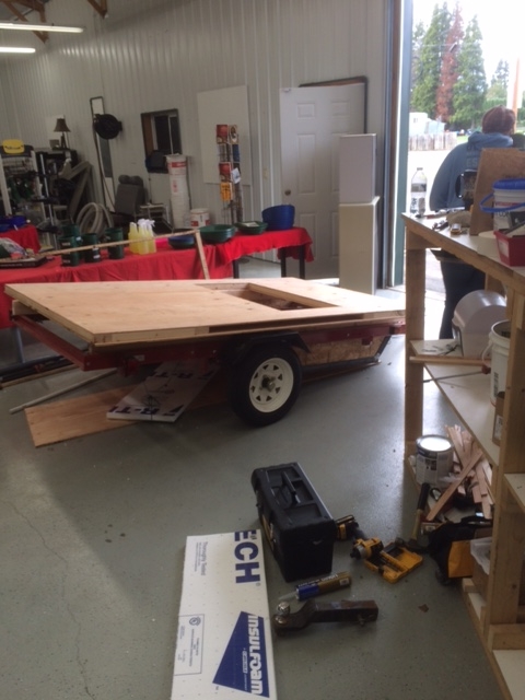

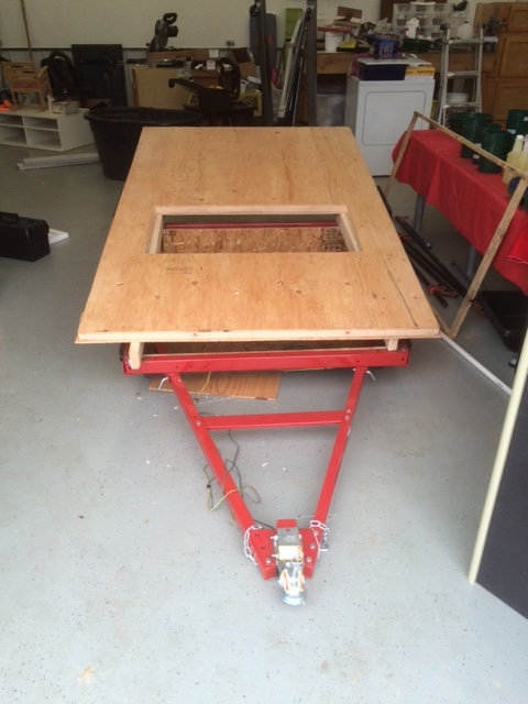

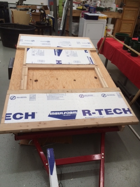

Because I plan to have the cabin removable fromt he trailer, I need to have a rigid and sturdy floor. I built the floor out of 2x4 and 2x2 frame sandwhiched between sheets of 3/8" 3ply. I used liquid nails everywhere and stapled it together with 1.75" staples.
I found a source for 5' x 10' 3/4" ACX for $125 each! :? I'm using 5'x10' so that I can have the curved teardrop shape go about 1' FWD and 1' AFT of the floor. That will give me a little more room in the cabin. I'll use the 5' width of the sidewall sheet to provide a 4' 4" inside cabin height (at it's peak) and give 6 inches below the floor to hide the trailer frame and provide a lower appearance.
I decided to go with the less expensive white styrofoamm insulation for the floor. I do not really intend to use this trailer in any environment that I wouldn't use a tent, so I am not putting a high value on insulation for this trailer. I really only put insulation in the floor to sturdy it up a tad bit more.
In the Below pic you can see the hole in the sub-floor lined up with the footwell. In the photo, it is sitting on 2x4's because I still need to notch out a section for the fenders before it can set directly on the frame.
Again from the side. The FWD protion of the "footwell" will be used for bedding stowage while the cabin is in the table booth configuration.
