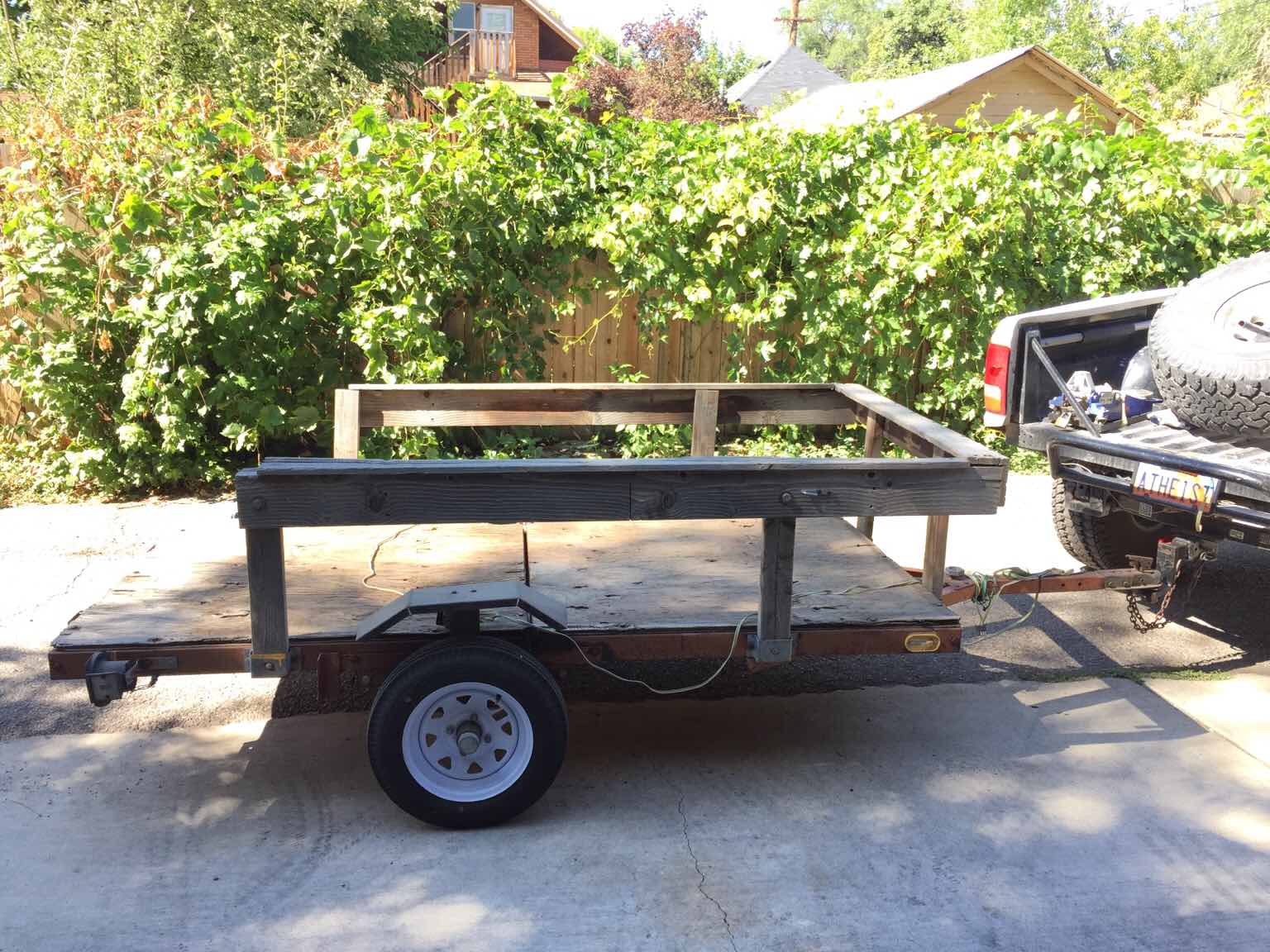

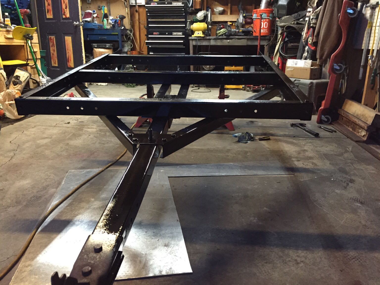

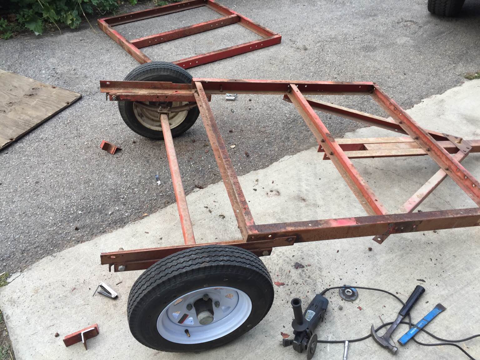

The first step was sourcing a trailer. A good friend had been given one and knowing him, it was sitting in his yard collecting dirt. Sure enough a phone call and $50 (to cover the new wheel and tire he purchased) I had a platform. A nasty rotting wood platform. Similar to a HF 4x8 folding but sold through our local Fred Meyer stores.
First task was removing all the old wood which of course was attached with bolts that hadn't seen a wrench in years. Once free of wood the next task was to eliminate the folding mechanism.
I then reassembled, checked for square, and welded every seam. Once solid I went to work with a sander and wire wheel removing surface rust. Once that was clean a fresh coat of black paint was applied. Shaken not stirred.

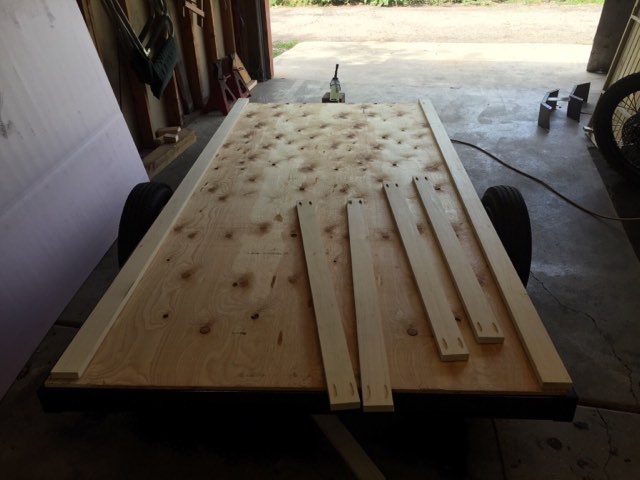

Postby Kanook » Tue Oct 13, 2015 12:25 am

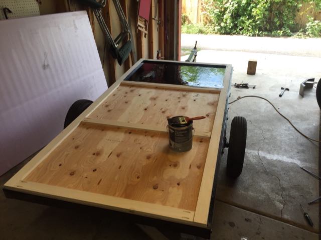

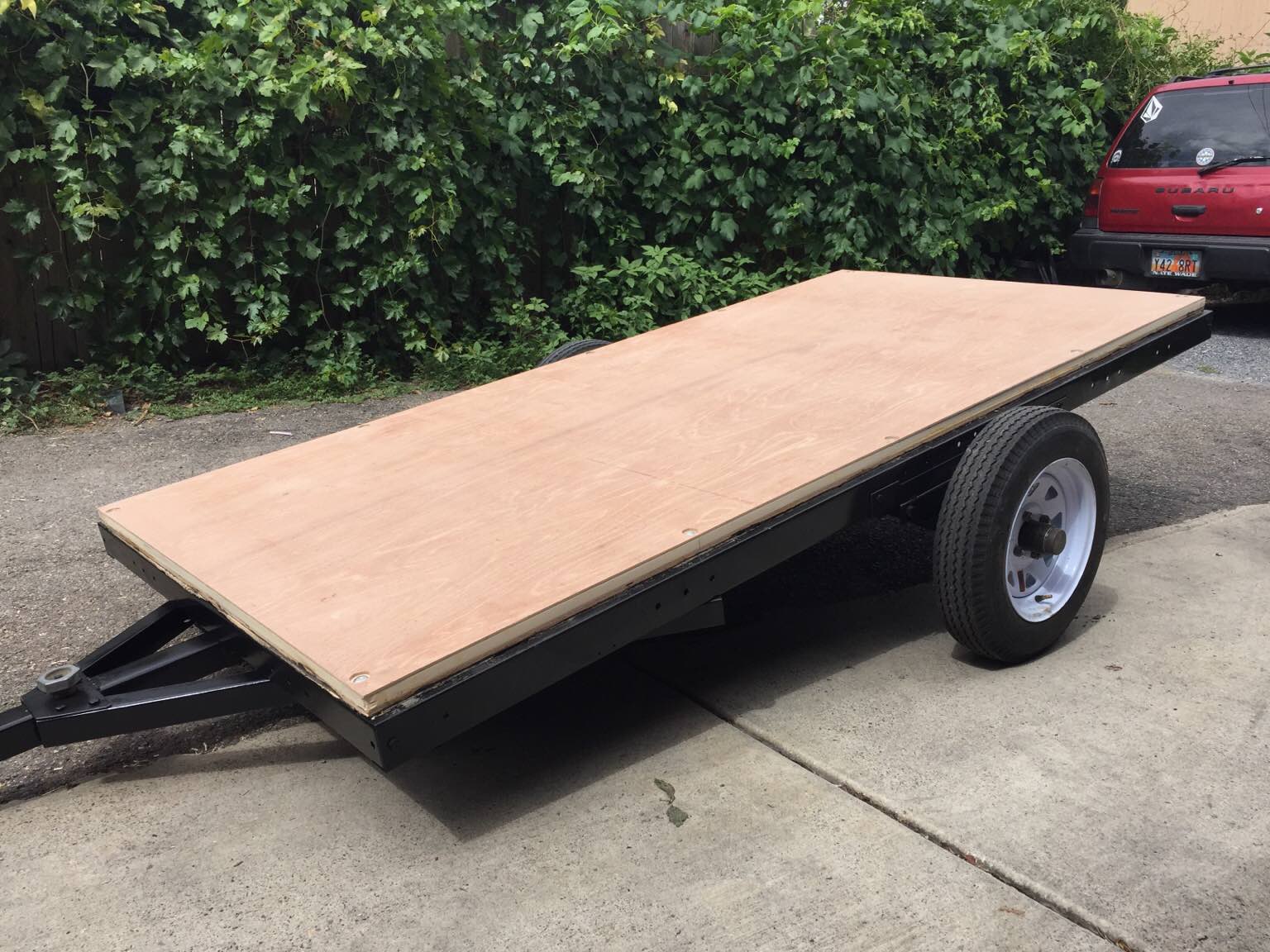

Floor being built. 1/2" base, 1x4 framing, 3/4" pink foam board in the negative spaces, and a luan top. And roofing tar coating the underside
Kanook
Posts: 60
Joined: Thu Jun 25, 2015 3:41 pm
Re: How I amazed myself. First build success.
Postby Kanook » Tue Oct 13, 2015 12:26 am

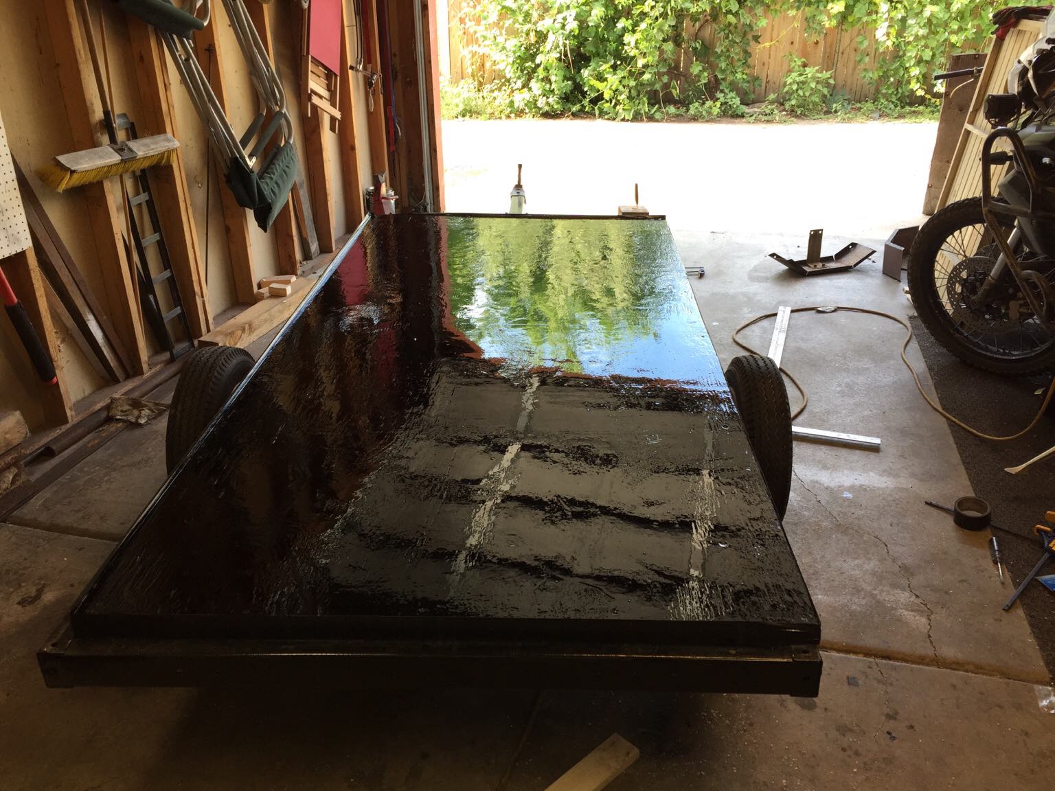

Tar dry and floor attached

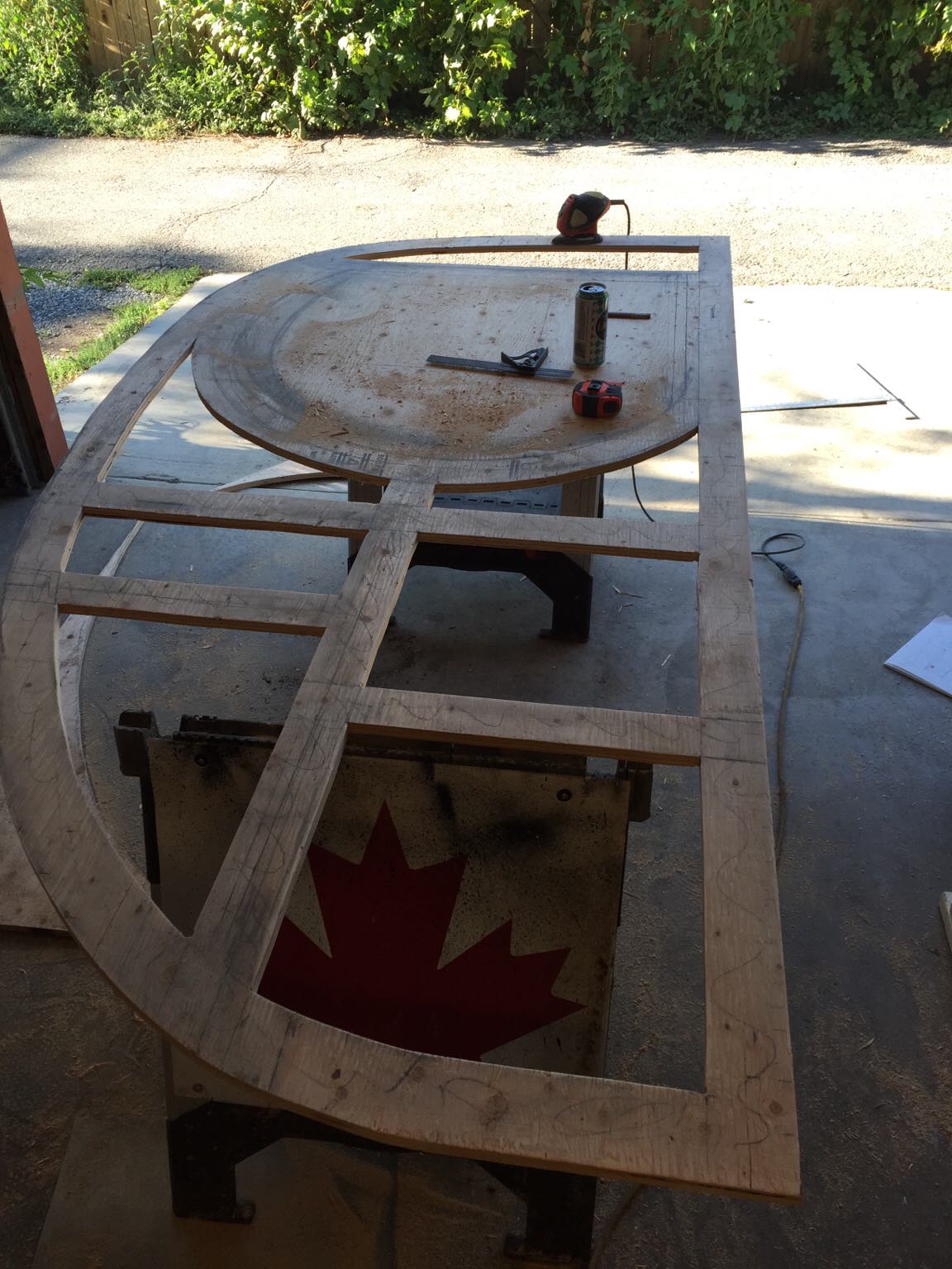

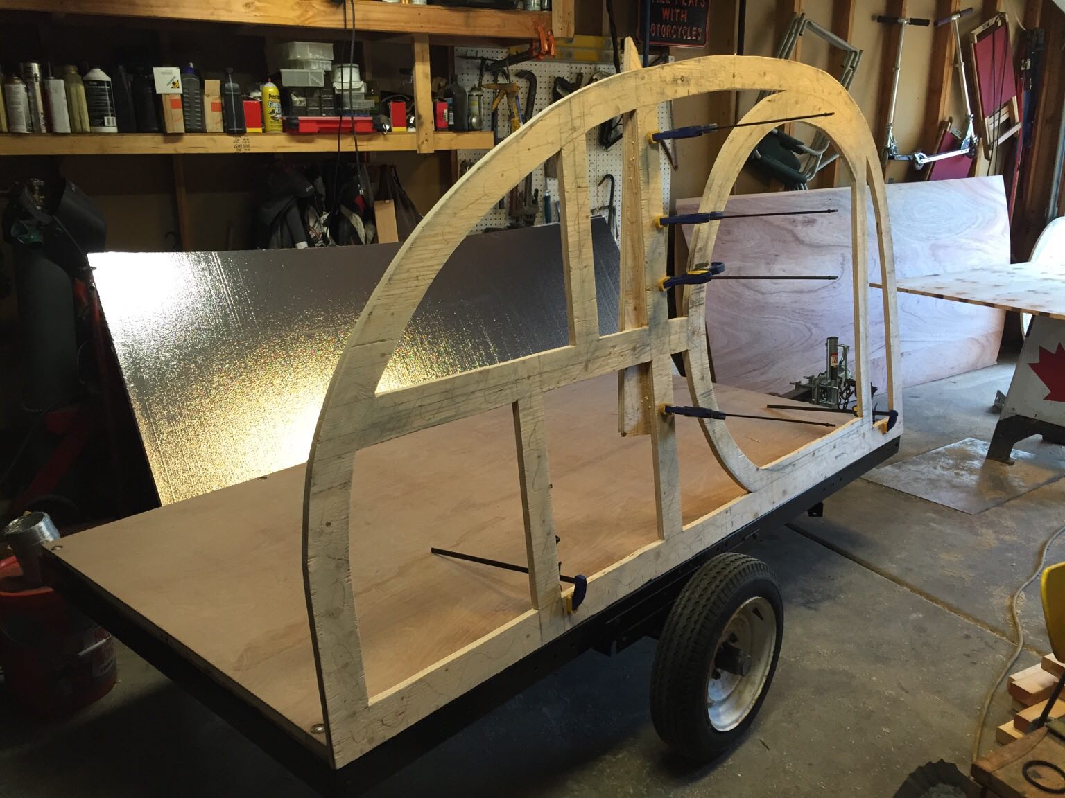

Postby Kanook » Tue Oct 13, 2015 1:01 am
Thanks to a fellow forum poster who graciously posted a profile I liked and on graph paper.

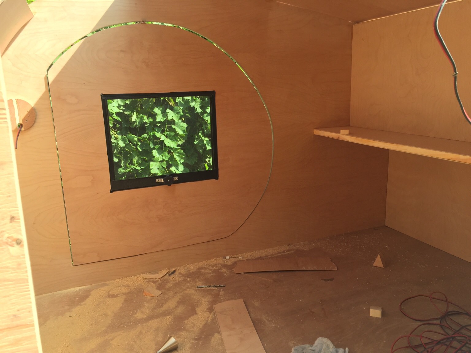

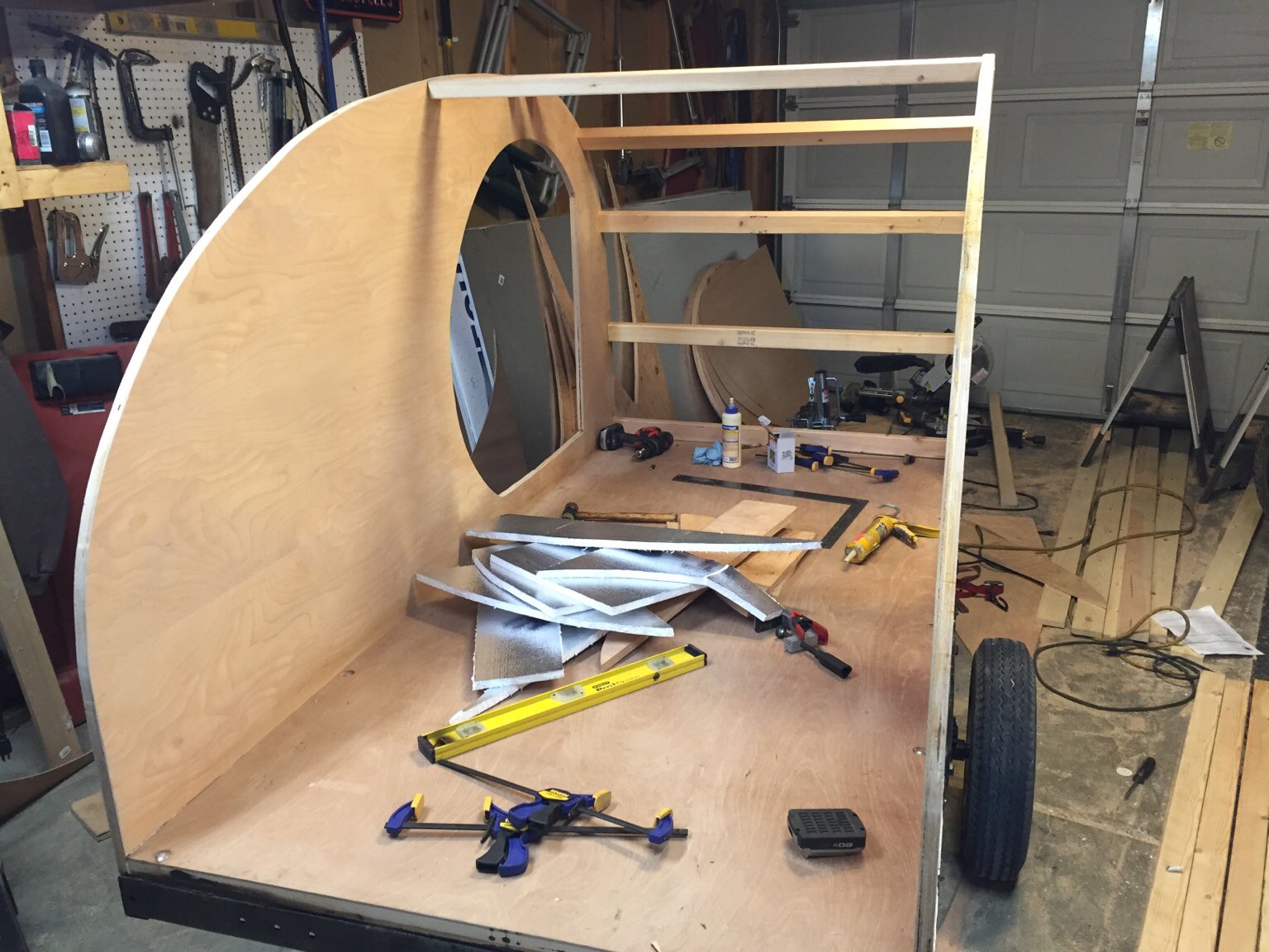

I skinned the interior walls with 1/8" birch prior to standing the walls. I left a floor thickness reveal at the bottom so the birch would rest on the floor surface rather than the side. Why? No idea. Just seemed like the right thing to do.

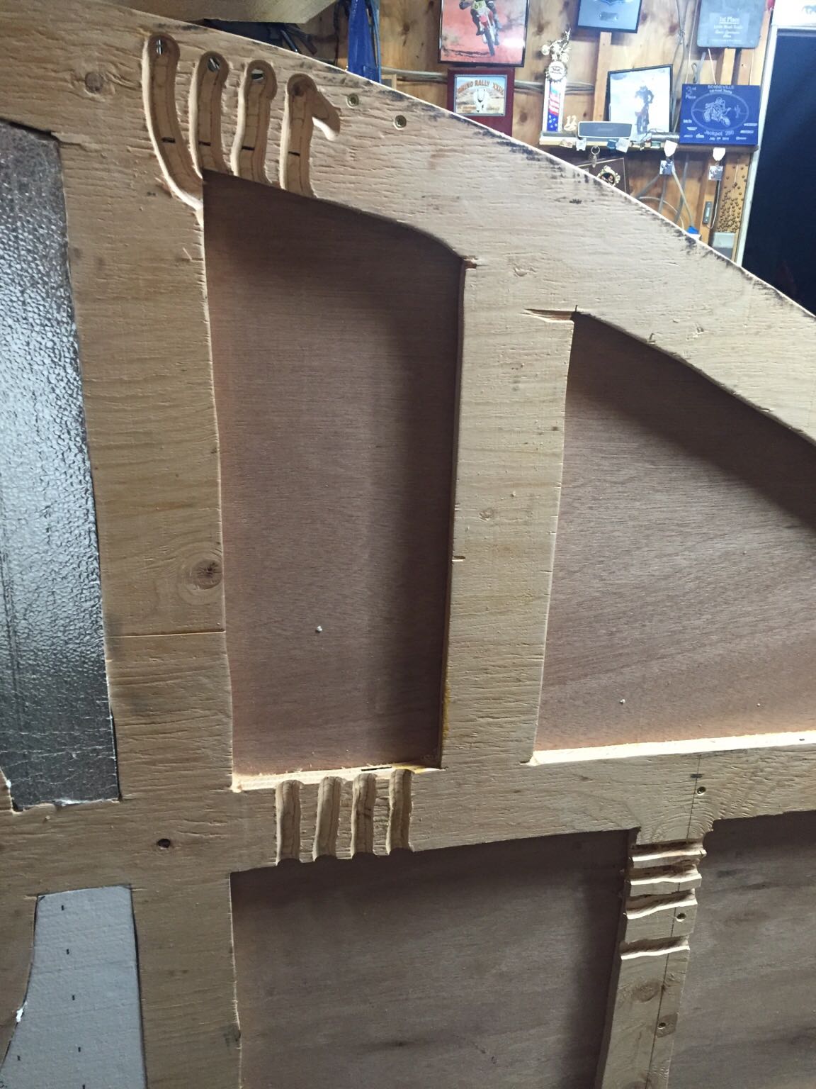

Routed out channels for wiring.

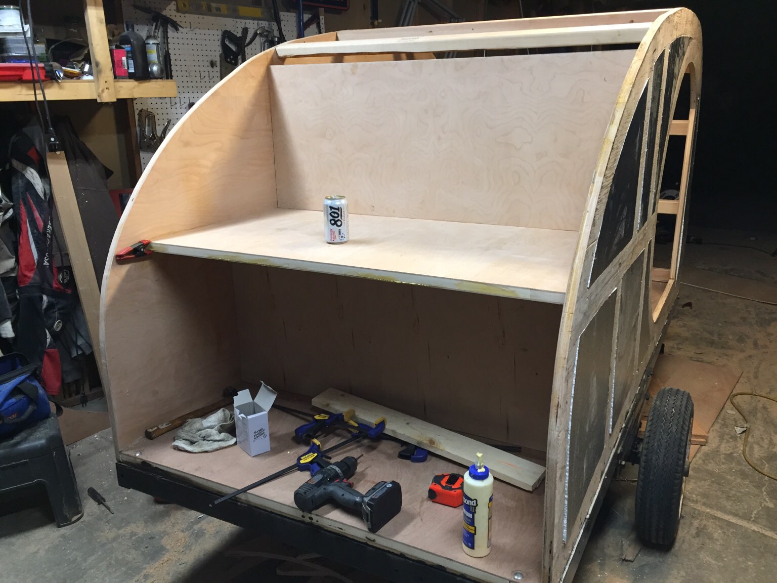

Postby Kanook » Tue Oct 13, 2015 1:18 am
The bulkheads and interior shelf that also extends to the rear as the galley counter are all 1x3 framing, foam board insulation, and skinned both sides with birch.

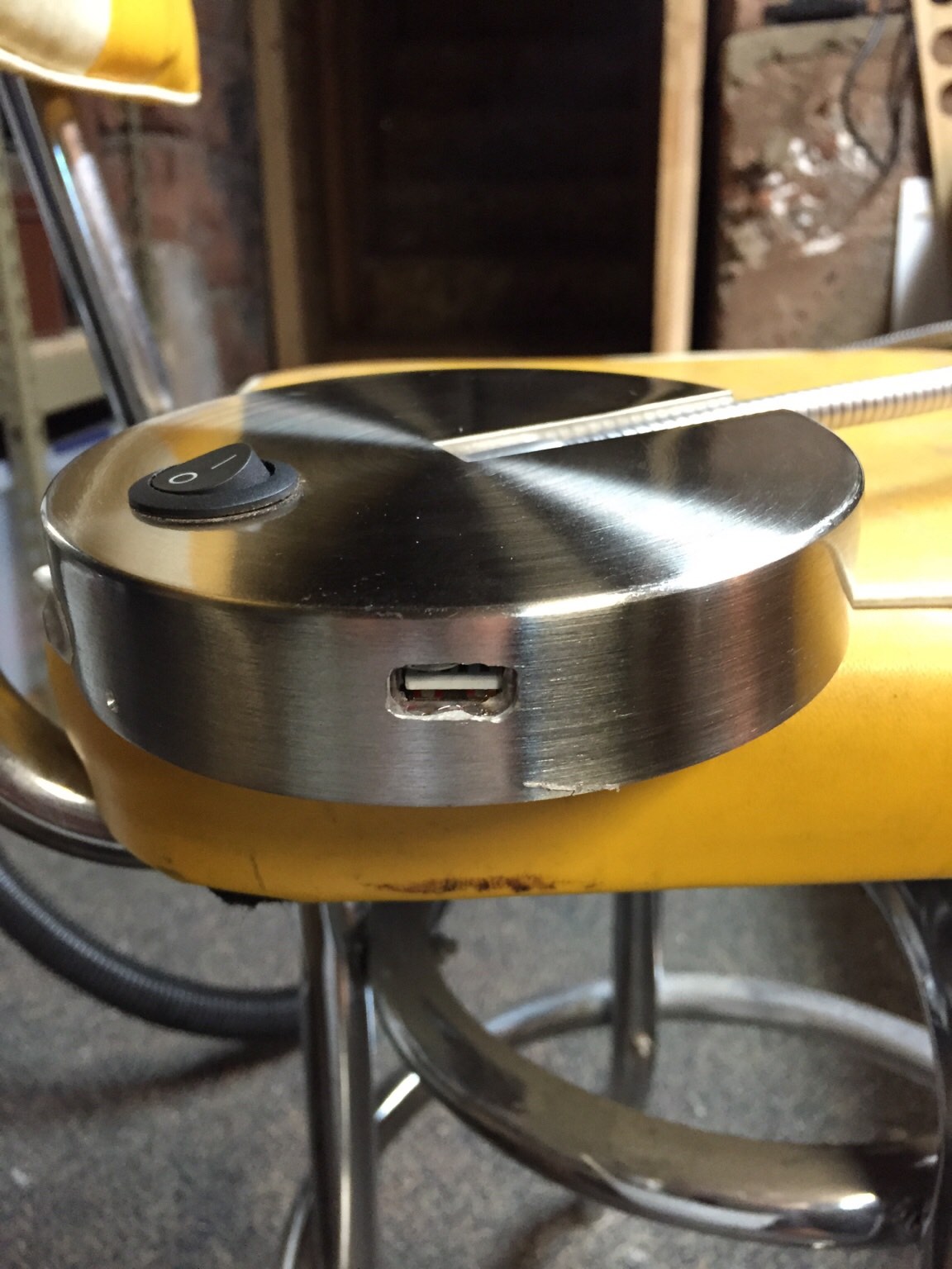

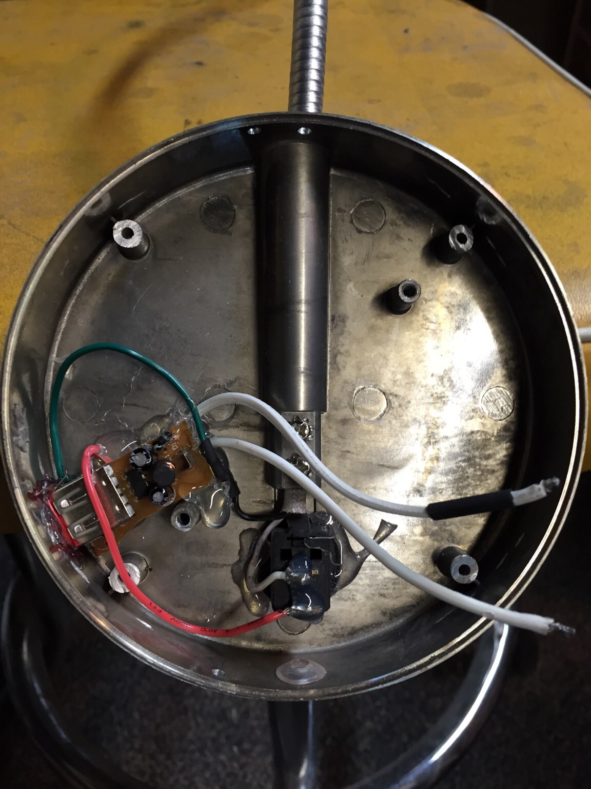

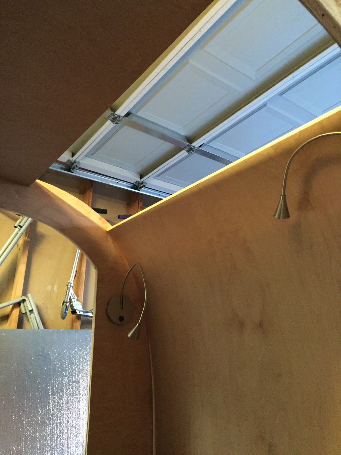

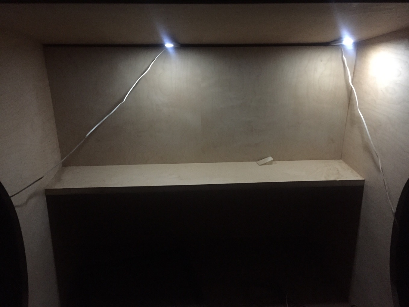

Postby Kanook » Tue Oct 13, 2015 1:24 am

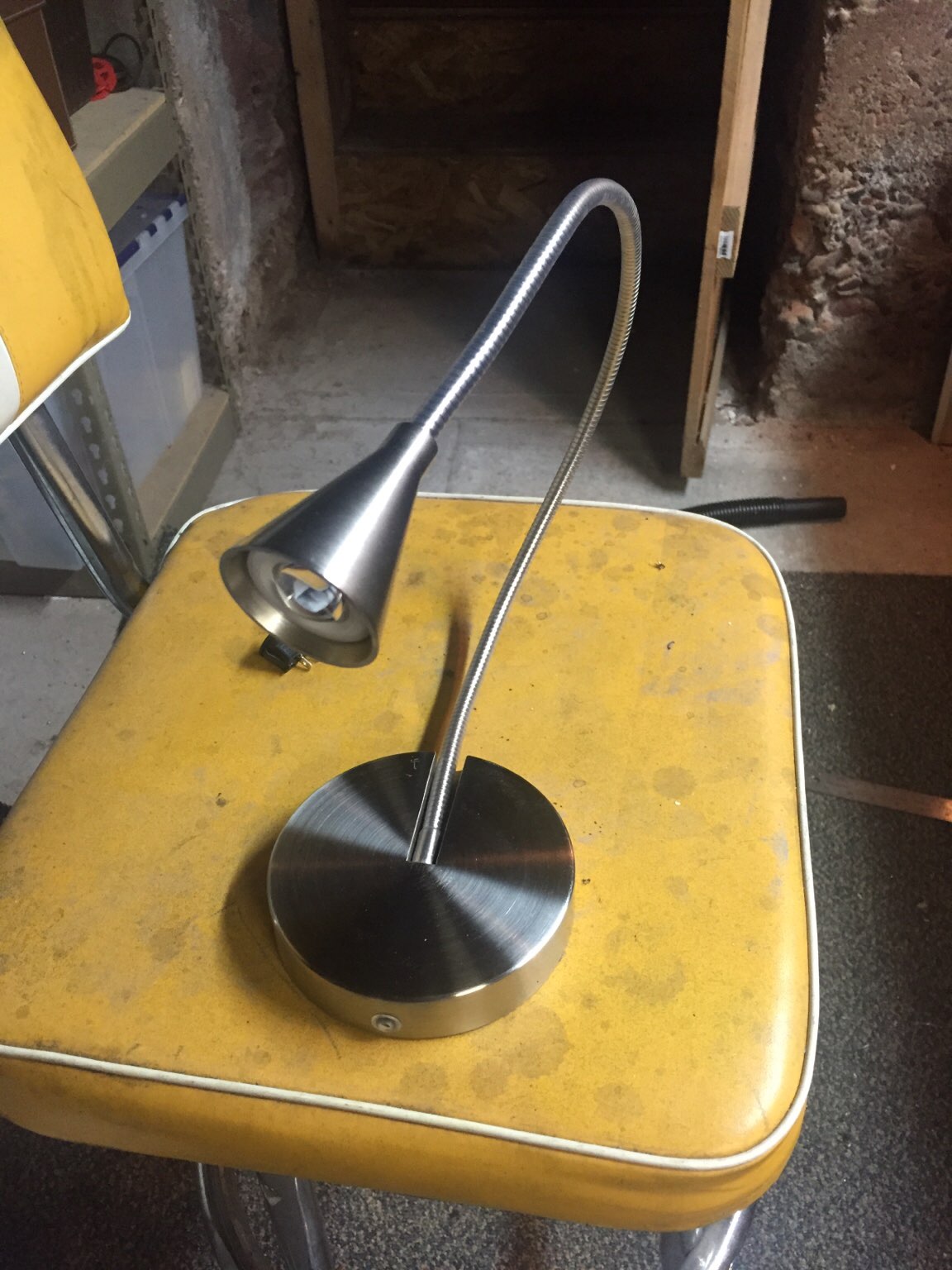

A trip to Ikea for lights. I chose these led table lamps for wall mounted reading lights. I gutted the weights and added a rocker switch and a USB adapter to convert to the correct voltage. I cut notches in the sides of the lights to double as phone/iPad charging ports.

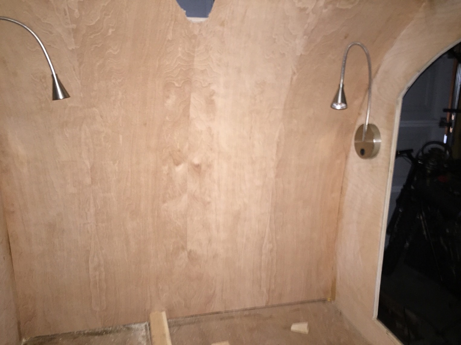

Any Guardians Of The Galaxy fans may appreciate this. One of my sheets of birch has a book matched image resembling Groot. Of course this piece was used as the front interior wall. Instant art on the wall.

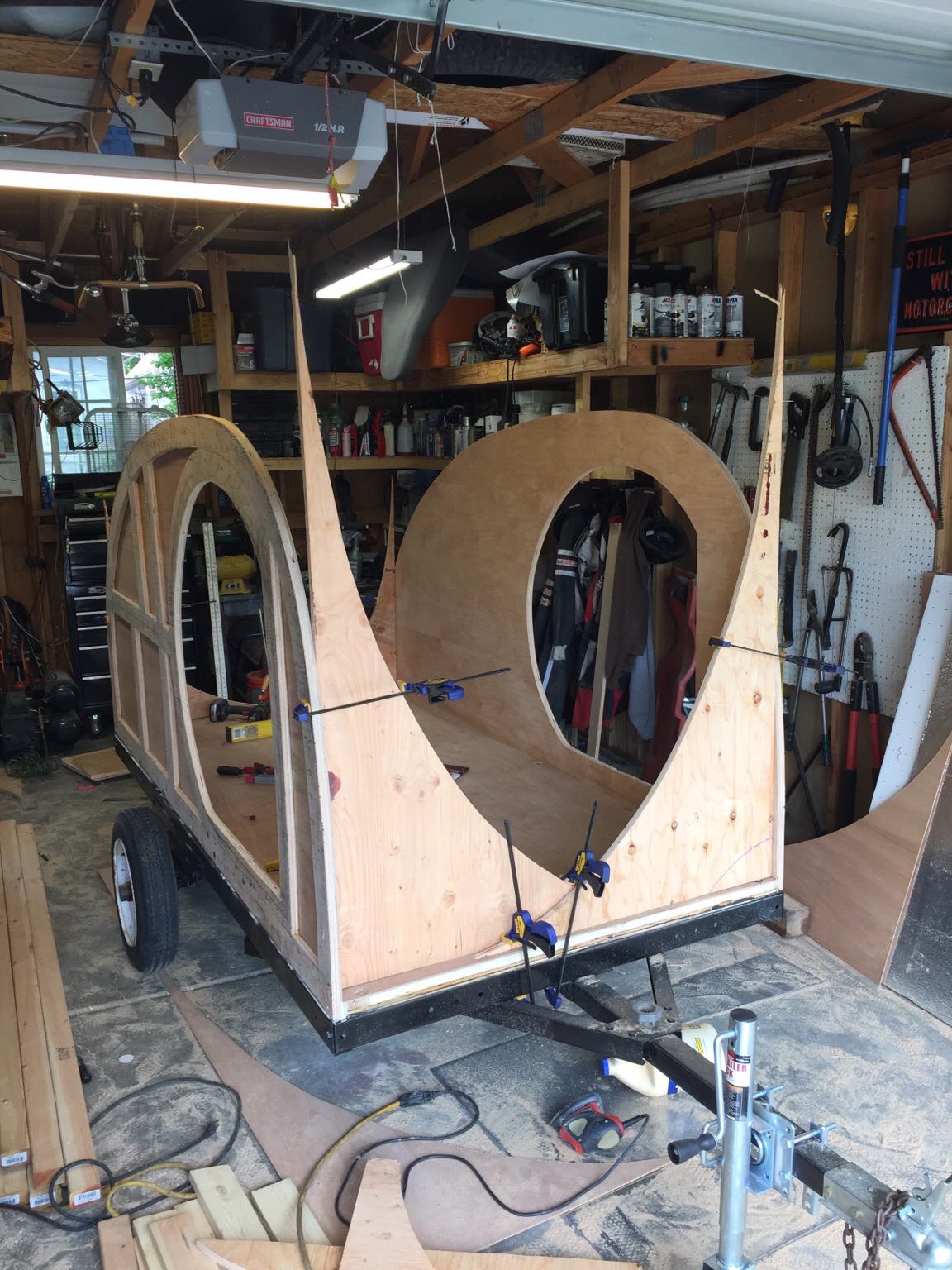

Postby Kanook » Tue Oct 13, 2015 1:32 am

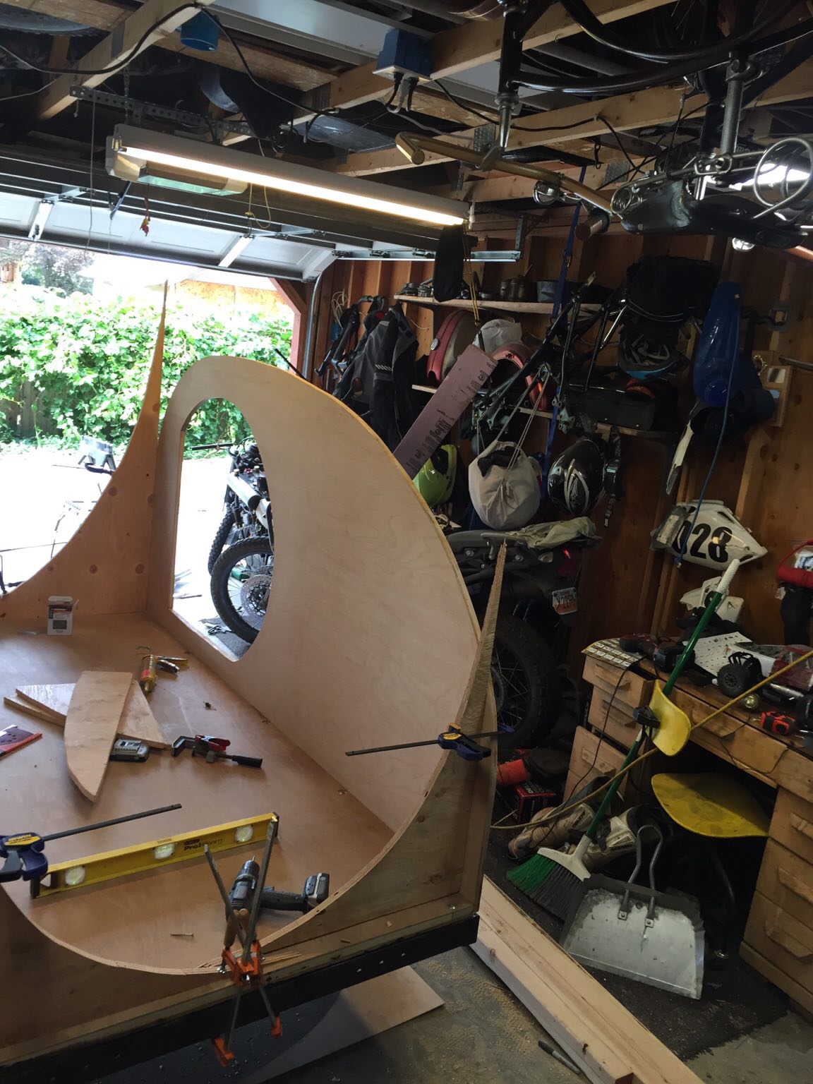

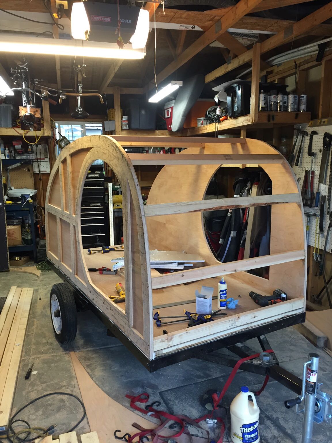

Taking shape.

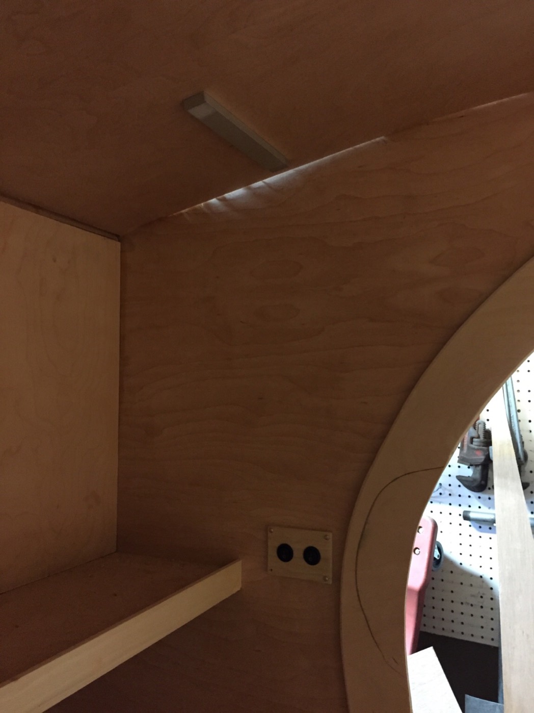

Postby Kanook » Tue Oct 13, 2015 1:34 am

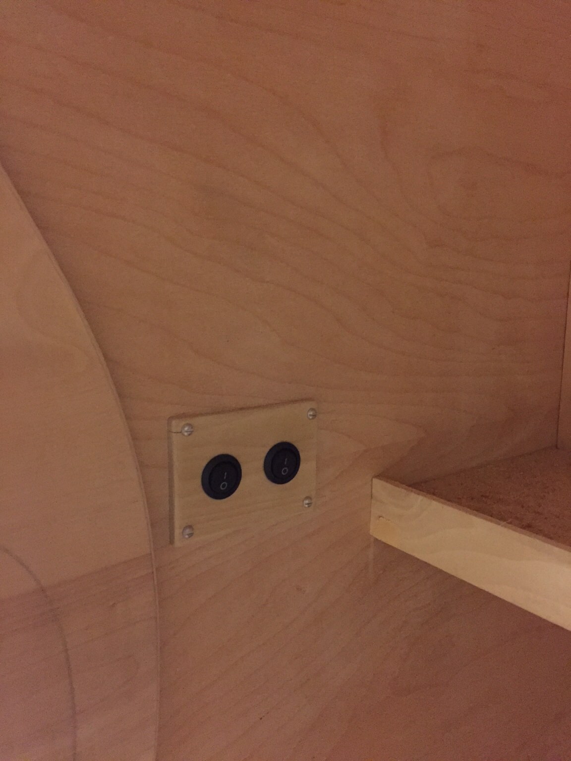

More ikea lights and switches installed
