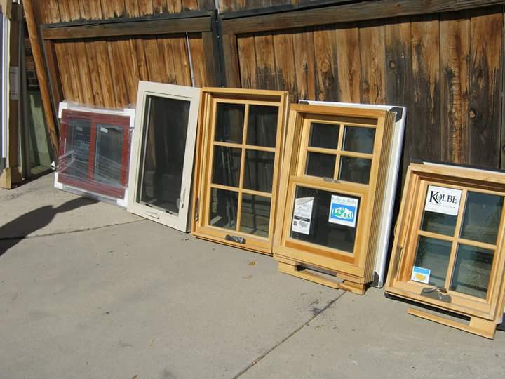

Windows!

Postby rebapuck » Sun Oct 18, 2015 11:32 pm
Are they all double pane?
Judy
1966 VW camper
1967 VW singlecab
rebapuck
Posts: 2243
Location: Chapel Hill NC
Re: Yiayias Waggon
Postby springdew » Mon Oct 19, 2015 10:33 am
rebapuck wrote:Are they all double pane?
They are! Quite the grab bag, aren't they? Three wood, two vinyl, and one aluminum. Those brackets on the bottoms of two of them are from being mounted in a display. I've since removed them.

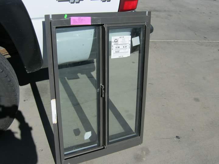

I just noticed that I didn't put the newest windows here. I'm selling the aluminum window and I found two more vinyl ones that are 2 feet tall and 4 feet wide.

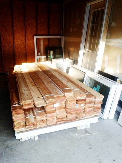

This month, I am educating myself and stockpiling materials. On April 15 I hope to secure a large storage unit with power to be the build area. If that works out, I'll move all my materials there and get started sanding and back-priming the siding.
Decided to go ahead with electric, due to difficulties doing it after paneling has gone up. Water and gas can still wait. So of course I am pillaging the Electrical Secrets thread.
Since we love pictures, attached is one of my current storage unit full of stuff. What you can't see behind the siding are cans of paint, primer, roof coat, polyurethane, etc.
