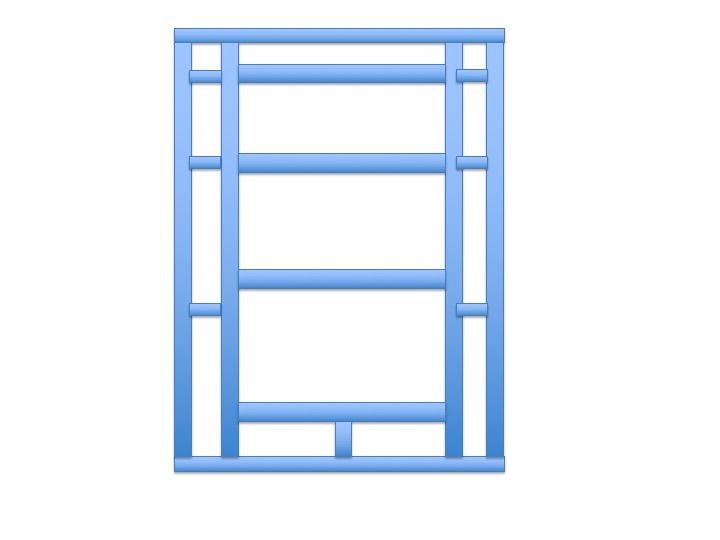

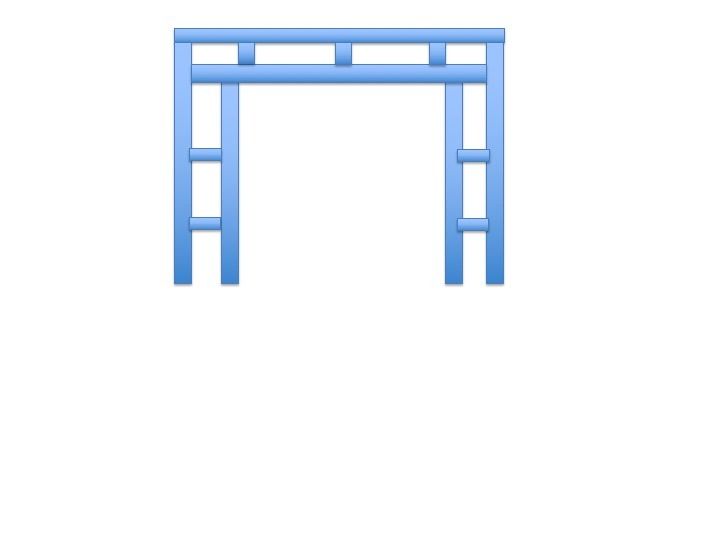

Deck addon plans:
Foundation of the trailer will be Jim's build from 2012/2013

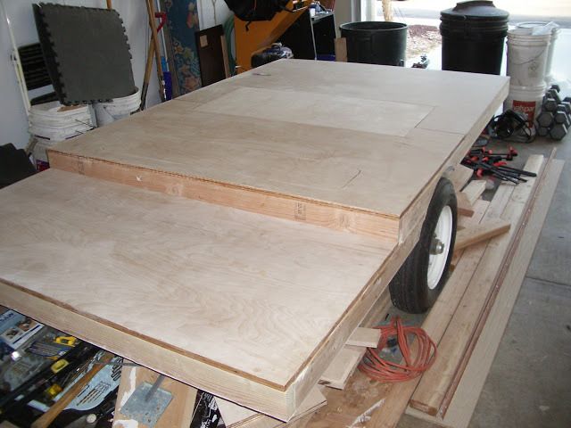

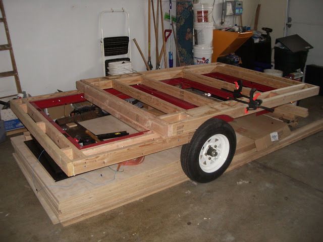

I purchase the HB frame over Thanksgiving break 2015, and now used Christmas 2015 break to assemble the frame.
