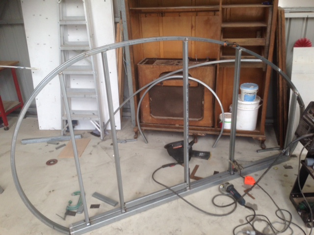

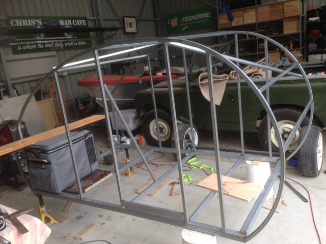

Hello,
Just recently started my teardrop build, its unconventional in terms of build materials and also its quite high because I am quite tall. Plan is to build a steel frame, fibreglass cladding on the outside and timber on the inside.
Its a bit of an odd profile, but I don't think it looks too ugly. The hatch hinging all the way to the bottom may prove to be a bit of an issue with the return on the curve, but I will see how it goes.
Some random questions, how often should I have the cross members, planning on sheeting it in 1.6mm FG sheet with no timber substrate but stuck on with VHB tape.
Cheers Chris

Gday chris,if your only having 1.6mm skin youll probably need to have your spars pretty close together.
How rigid is the fiberglass skin?
You may be better off rethinking the ply underneath and will save you alot of work and weight in spars.
Or composite pannel maybe.
Where in aus are you?

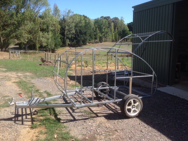

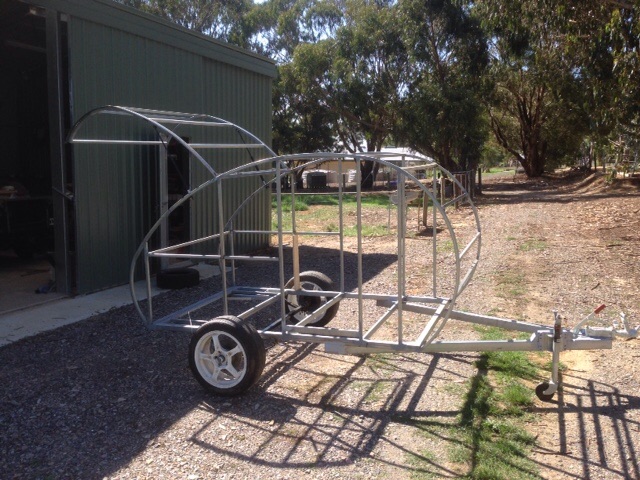

Postby CJ_DT » Sun Mar 13, 2016 5:18 pm
Progress has been a bit intermittent but reached a milestone yesterday. The frame now rolls, hatch frame built and gas struts mounted. Few more bits to weld in and then I can start fitting out the insides.
