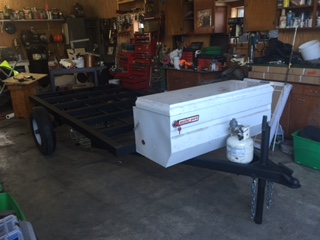

if I did the picture thing right so should see a picture of my trailer upside down the trailer will have a large tongue box, a 10lbs propane tank on the tongue, two shoe baskets under the doors, a receiver hitch in the rear, two recess pans in the galley area which will house a battery and water tank, and three pipes which will convey lp gas, 12volt and 120 volt from the front to the rear of the trailer

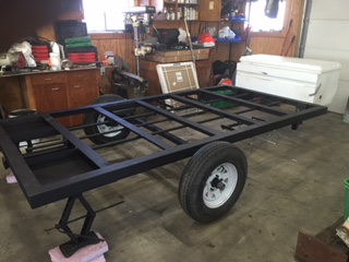

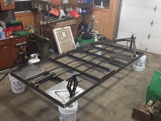

well finally we have a roller painted up ready to start working with wood now
ibbowhunting
Posts: 65
Joined: Sun Mar 22, 2015 12:12 pm
Re: "Its On Point" 5x10 Benroy Design, MN
Postby ibbowhunting » Sat Jan 16, 2016 4:58 pm
one more picture

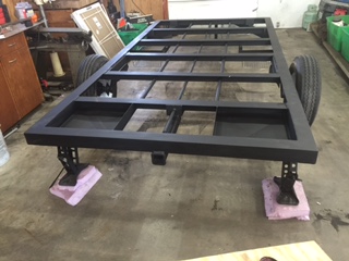

Postby ibbowhunting » Sat Jan 16, 2016 6:01 pm
one more :pictures: sorry just happy to be done with the trailer

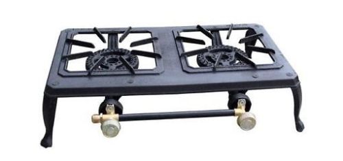

anybody using one of these for a stove seems simple and durable I plan on have a stainless steel countertop and back splash
input.... good or bad

Postby ibbowhunting » Wed Jan 20, 2016 8:04 pm
so with my design having a dog kennels eating up some of my depth of the galley, countertop depth is going to suffer there is no way I will get a 24" deep countertop, so I started measuring objects around the house
The largest pan I own is 12" Dia
The largest cutting board I own is 12" wide
A 4 burner cook top fits into a 24' countertop so I will only have a two burner stove divide that in half = 12"
so I'm thinking 12" depth is not that unreasonable for countertop/work surface but i'm sure I can make it deeper then the 12' minimum
please tell me if the cold weather is starting to effect my thinking
or if it will work
ibbowhunting
Posts: 65
Postby KCStudly » Wed Jan 20, 2016 9:16 pm
If you are building a flat back, a short galley can make a lot of sense. Alaska Teardrop built his Northern Lite Traveler with just a small cubbie and a flip down door that extends the work space.
As to that style of stove, some of those can be rather heavy cast iron, so it depends on what your usage is. The ones I have seen really kick out the BTU's and were great for scrambling a big stock pot full of eggs for a huge crowd of boy scouts, but I wouldn't want to have to backpack one in.
To serve a couple of people (or even more) I prefer the white gas suitcase style stoves... Coleman. They're light weight, self contained and they stow and travel well.
