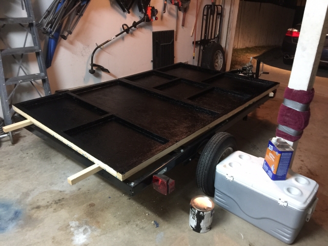

Got some work done today. Floor is water proofed, insulated, and flipped over onto the frame. There is a 1/4 gap or so on the front, middle and back cross members, What have others done to correct this issue?

For the gap, most people either cut slats of lumber or use a piece of hard plastic trim as a shim; some have used aluminum flat bar. You can attach them to either the bottom of the floor or the top of the trailer. Just be sure, if you use wood, to seal it well.

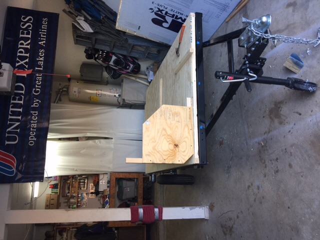

Postby Ragonk » Mon Jan 18, 2016 7:32 pm
[img]138919[/img]
I finally decided on a profile and got them cut out. This was a sticking point for me and I'm glad I got it done! Thanks Irrowe for the help with uploading my pictures.
