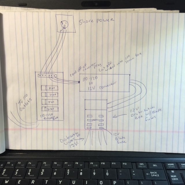

Postby dms2871 » Tue Jan 26, 2016 7:03 pm
would this work
this what I quickly thought of
power wiring idea.jpg (135.82 KiB) Viewed 1699 times

Using an all-in-one converter like the Progressive Dynamics PD4045 just makes putting all that together easier.
It contains the 120VAC circuit breaker panel, the 12VDC fuse panel, and a smart battery charger all in one box.
I like the automatic switch-over when you go from battery to shore power, or vice-versa. I don't have to do anything to change the power source.
There is nothing in a PD that you can't put together out of separate components.

Postby noseoil » Tue Jan 26, 2016 11:05 pm
The PD4045 is really a good item to include in your build, I agree with the above statements. It does everything you mentioned, breaks the power into 110v & 12v, converts, charges the battery, gives you both fuses & breakers, & ties it all into one neat package. I did add a ground buss to tie things together (frame, skin & all the grounds) behind the PD4045.
The only thing I added to my trailer is a solar panel for day to day camping (without shore power) & two dc volt meters, one in the cabin by the entertainment center & one in the galley. This makes it easy to watch battery state of charge when things are running inside or outside.

Postby dms2871 » Tue Jan 26, 2016 11:54 pm
Jdw2717 wrote:This is similar to what I did. The shore power 110v comes into two 15amp circuit breakers. Then one breaker hooks to one outlet in the galley that powers the fridge. The other breaker has two outlets attached. One in the cabinet with all of the power hookups for the two converters and one in the cabin for the TV and DVD player. The converters power the fan (one dedicated to this) and the other for the lights and 12v jacks for charging phones. The 12v lines go through a fuse panel with cutoff switches before they connect to the lights and 12v plugs.
104149
This picture is before I had everything hooked up and installed cleanly but it gives you an idea of how I set it up. Also, when I don't have shore power I bypass the 110v outlets and hook a battery to the fuse panel to run the 12v items.
Yeah good idea hooking that converter on the breakers

Postby dms2871 » Tue Jan 26, 2016 11:56 pm
GuitarPhotog wrote:Using an all-in-one converter like the Progressive Dynamics PD4045 just makes putting all that together easier.
<Chas>
:beer:
Aren't those converters like expensive I was going this route cause I can do that a lot cheaper than 600$
