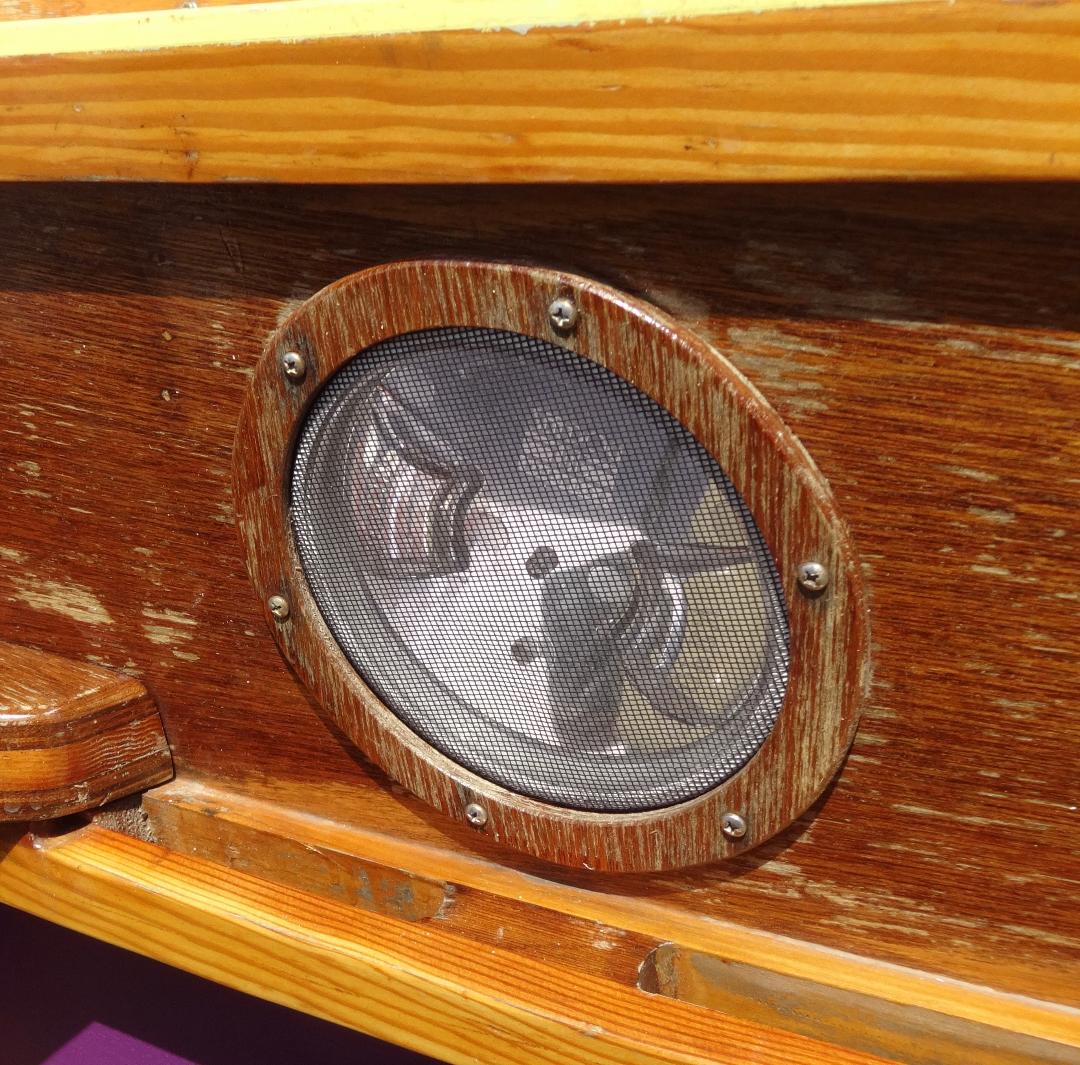

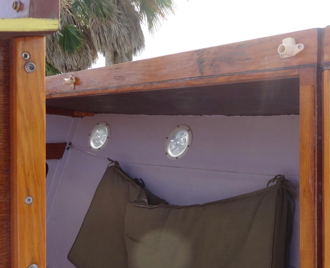

something i have noticed in the boatbuilding/saiing world are "deck plates" which are 2 piece units that get screwed into a round hole in a wooden surface and the center can be unscrewed to allow thru access to a given space
there are now on the market several sizes of round deck plates w/ clear screw in centers
some of the folks who sail and boat/beach camp have begun installing these plates from the inside of their small cabins(smaller than the ave TD) to allow natural light into the cabin and by unscrewing them they get a bit of breeze/air flow
one builder laid a piece of insect screen over the hole as he set the unit in place and now not only has light and breeze he has insect protection
here is a link to one source offering 4" 5" and 6" plates/ports
https://www.duckworks.com/product-p/sd- ... parent.htm
here'za pic from the outside of an older application
and here'za pic from the inside
