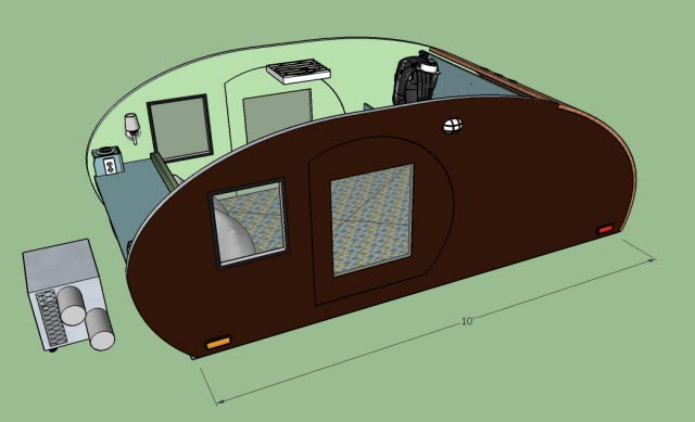

THE GROUNDWORK:
I checked out tnttt's selection of free plans http://www.angib.pwp.blueyonder.co.uk/teardrop/tear00.htm, and while I was originally leaning toward the very cute (but not free) Cubbie, it didn't look like it was going to be long enough for a Q-sized mattress and a galley of any size. Also, it was not free. So I went with tnttt's Grumman instead, whose old-school futuristic curves are so adorably old-fashioned.
I downloaded the free version of SketchUp and followed Dan Lott's wonderful tutorials to design my trailer based on his SketchUp-ized Grumman plan. http://tnttt.com/viewtopic.php?f=62&t=49302. Note--I'd never done any kind of 3D modeling in my life. But during a week's convalescence with walking pneumonia, I learned everything I critically needed to know from Dan and made a go of it. My iteration has a 10-ft foundation, with an extra foot of length (& storage!) provided by the curved nose and tail.
Viola! The Little Ferdie!

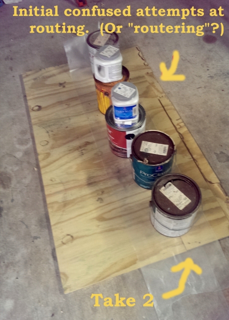

The test is this: I have to "stretch" some plywood. The profile is (a hair less than) 11' from bulge to bulge, so a 4x8 isn't going to be big enough--I have to splice two pieces of plywood together. I had never so much as turned on that router, I'd never cut a board using a clamped-on guide, I'd never heard of Titebond III. I thought nails came in lengths shorter than 1/2" (not at Lowes, they don't).
I asked the forum for advice on how to do this http://tnttt.com/viewtopic.php?f=21&t=63635 (thanks, guys!), and TODAY, I STRETCHED SOME PLYWOOD. OH HELL YES.
It's 1/2" exterior grade (deplorable, crappy, knothole-ridden from Lowes, but the specialty lumber places wanted some $80 per sheet. So Lowes it is), and I made a 2" lap joint (I'll be nailing it to poplar studs, so it doesn't need to be super strong). I routed my first... route today, which was exciting.
Thank goodness I had been advised to do a trial run before taking on the real thing.

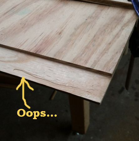

It turns out that my router has an "edge guide," which in retrospect is a mixed blessing. It took us about 1/2 an hour to figure out how to attach it, and then we had to develop an approach to clearing all the material between the 2" guide limit and the edge of the board. This probably isn't the right way, but it did get the job done: we made a series of channels parallel to the edge about a 1/2" apart. Then we used a sort of small back-and-forth movement to clear each remaining ridge of material. This way, the router was supported on both sides as long as possible. Clearing that last ridge at the edge, though--always messy. The router leans a little and digs more deeply into the wood. I think it will be okay, but it was definitely not lignified perfection.
If we hadn't used the guide, we could have followed some advice I received to clamp some plywood on the other side of the edge, where it can support the router. This is probably what I'll try next time. The guide does make cutting the farthest-from-the-edge channel a breeze, though. Go from left to right and zoup-zoup: it's done.
Anyway, after the adventures in routing, I glued the two routed faces together using Titebond III, with waxed paper above and below, and sat heavy paint cans on them.
The plywood--in addition to being knotty--is also warped, so this afternoon I bought a staple gun to encourage the splice to stay spliced.
When I pulled the paint cans off after a couple of hours to apply the staple gun, the joint popped apart (we're still on the trial run, here. But we've learned a very important lesson.) I stapled it back together, but I'm not sure how strong the join will be in the long run. Fortunately, is just scrap wood.
Then I repeated all those steps (minus a few of the cock-ups) on the good pieces of wood. By myself, I might add, Mr P having pooped out. The joint is glued, stapled, and paint-canned, lying on the garage floor to cure.

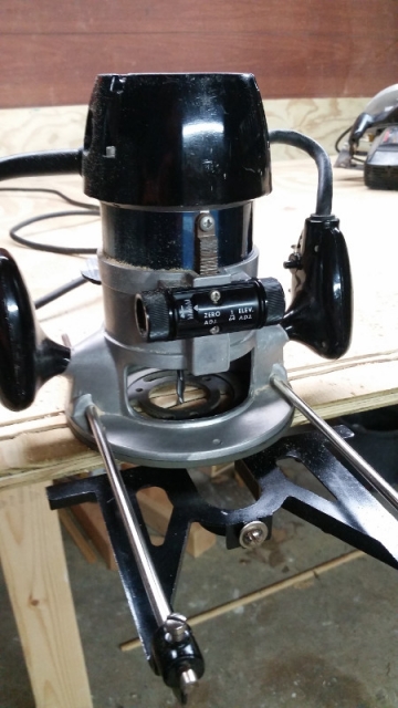

I'm posting some boring details about how to use the Craftsman 315-25070 Router, for my own reference later. Probably won't be a very scintillating read. You've been warned.
If you don't have a copy of the user's manual, it's available free here: http://www.manualslib.com/manual/480024/Craftsman-315-25070.html?page=6
But I prefer my own instructions, so I'm recording them here.
CHANGING THE BIT
(1) There's a small metal leaver with a piece that fits into a notch in the bit's collar[?]. Press it and rotate the collar till the piece finds the notch. Now you can screw/unscrew the collar with the special wrench to let the bit out.
(2) Insert the new bit, but then back it out a hair before tightening with the wrench. We didn't do this at first, and the bit kept creeping deeper and deeper.
SETTING THE HEIGHT
(1) Loosen the "wing nut" (the finger-bolt on the back of the unit)
(2) use the right-hand "ELEV ADJUST" to raise and lower the main body of the router until the bit is just touching the surface of the wood while the router is perfectly level with the surface. The "ELEV ADJUST" dial is sticky-- you can pull or press on the body of the router to encourage it to move.
(3) Turn the left-hand "ZERO ADJUST" dial to zero. This is the unit's baseline. From here, you will tell it how deep to plunge.
(4) Lean the router back so the bit can descend without touching anything. Use the right-hand "ELEV ADJUST" dial to raise and lower the bit, reading the depth from the ZERO ADJUST dial. This is confusing. Do not try to set the depth using the ZERO ADJUST dial--it won't work.
(5) Tighten the wing nut good and tight.
(6) You're now ready to begin routing.
ADDING AN EDGE GUIDE
If you want to add an edge guide, it makes the most sense to do it before setting the height.
(1) Find two parallel channels in the router that run parallel to the ground. The two long shiny rods fit into these channels, though you'll have to loosen a couple of screws on the underside of the unit first.
(2) Fit the two shiny rods into the two parallel channels in the top of the edge guide. Again, you'll need to loosen some screws first.
(3) Measure the distance from the lip of the edge guide to the middle of the router bit hole, and adjust the edge till is reaches the desired distance for a channel you wish to cut or a lap joint you wish to create. (There has to be a better way--this is ridiculously imprecise)
(4) Tighten all the screws.

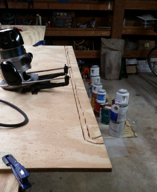

Here's how the route looks with the edge guide in place, doing its thing:
As I mentioned in my previous post, to make the face for the lap joint, I first cut parallel grooves in the region I planned to remove. Then I used a sort of scrubbing movement to remove each of the ridges of wood between the channels, one at a time. This seemed to work nicely.
The problem with the edge guide is that as you remove the last ridge of wood, there's no more support for half of the router face--it's just hanging out over space, and it naturally tends to lean toward the user a bit, causing inappropriately deeper channels.
If, instead of using the edge guide, I had clamped a second piece of plywood butted up against the first, and then had clamped a couple of straight edges in place to circumscribe the movement of the router, it would have always been supported = no unsightly gouging. I'll probably try this next time, when I stretch some plywood for the the other wall.
However, for this iteration, I'm hoping that copious wood glue and staples will hold the thing together, regardless of gouges.
