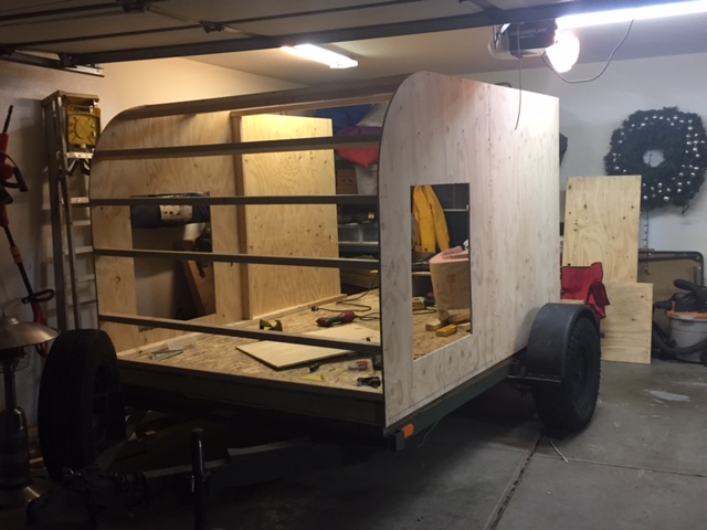

so we found a great trailer on craigslist 6x10. So we decide to start building a hunting trailer for ourselves. We went a little bigger than normal as we are going to run a small bunk across the trailer for my little daughter when she wants to go hunting with us. (give my wife a break:) )
here is where we are at so far....
any suggestions appreciated.

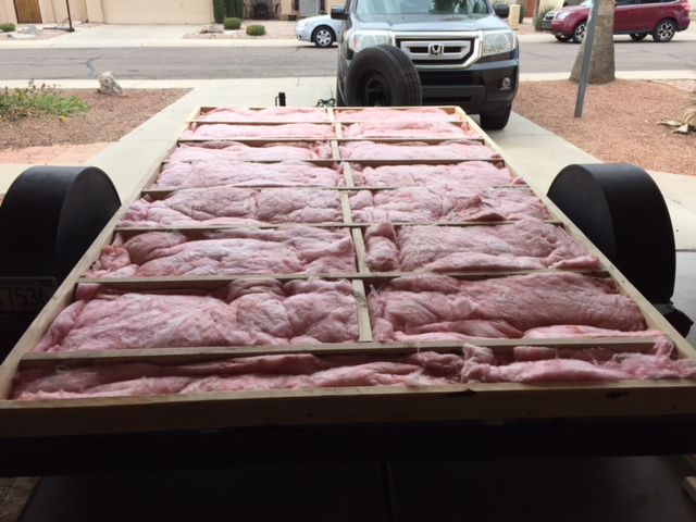

Looks like you're beyond this point, but I'd stay away from fiberglass insulation. It can tend to hold moisture. A layer of rigid insulation would have been more than enough, and you could have had some in-floor storage for extension cords or whatever else you can fit in the floor cavity. Otherwise, looking good!

Yes, you look to have a good sturdy foundation for your trailer. But 2x4 s may have been overkill? :thinking:
Remember your are not building a house, and teardrops are all about "weight".

Vedette wrote:Yes, you look to have a good sturdy foundation for your trailer. But 2x4 s may have been overkill? :thinking:
Thanks for the pictures, and we hope to follow along with your build. :thumbsup:
Good Roads
Brian & Sandi
thank so much for the comment. we went with 2x3 because I thought 2x4 was over kill also. ;)

absolutsnwbrdr wrote:Looks like you're beyond this point, but I'd stay away from fiberglass insulation. It can tend to hold moisture. A layer of rigid insulation would have been more than enough, and you could have had some in-floor storage for extension cords or whatever else you can fit in the floor cavity. Otherwise, looking good!
I thought about that, and then I realized I am in Arizona and mostly travel in Arizona. It may rain like 10 days a year here....if we are lucky...:)
