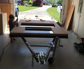

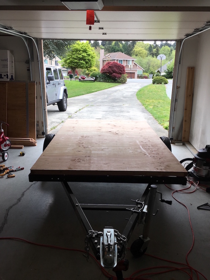

Today I framed out the floor, and cut the pieces for sub-floor storage. I plan on having 1/2" CDX above the frame, and sanded 1/4" Arauco on top of that. I will insulate the floor, and want to know if I should cover it with 1/4" or will Henry's be enough?

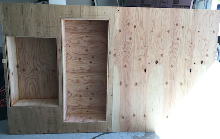

Tomorrow I plan on putting the storage boxes together. The front (closest to TV) will be 32"x21", and other will be 48"x21". They're 9" deep.

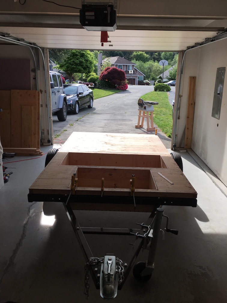

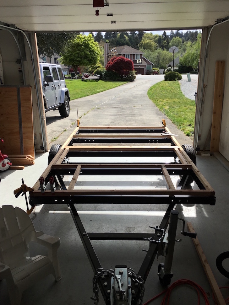

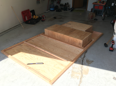

Here are a few updates from today.
The floor is getting closer to completion. I mocked up the storage, and will mount them this afternoon (after my little guy gets his nap). I want it covered in the black stuff by days end so it'll be dry by the weekend.
I would love to hear any thoughts.

Got some work in this morning. I was able to get the floor to a place where I am ready for some Henry's 107. I would like to know if you guys leave the underside of the floor (w/insulation) exposed, or cover it with 1/8 ply?

I think that really depends on your region, the climate and conditions that you plan to do most of your traveling in. Some people have posted that they sealed the underside first and glued or fastened the insulation in afterwards with no outer protection and it has held up just fine.
I live in New England where there is a range of weather from hot and humid in the summer to dry and freezing in the winter; plenty of moisture and road sand debris year round. Plus I plan to travel long distances on dusty forest service roads, so for my build I wanted as few "chinks in the armor" as possible and went with a full skin under the floor. No place for dust, dirt or water to try and get in, and less likely to rip, tear or snag on sticks or branches that may get driven over (tree falls are fairly common on the Magruder).
To me this also allowed me to build the floor as a composite, or SIP like panel, using a much thinner skin on top (5mm (3/16 inch) top and bottom) yet still having plenty of strength.
