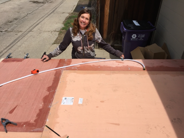

141741
Laying out the profile with a garden hose, bent piece of molding, and started with measurements from Andrew Gibbons Grumman 2 as a start point. Ours is going to be 5' tall, and turned out to be about 10'-8" long.
