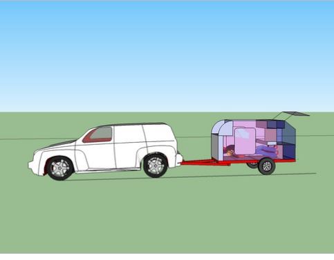

my sketchup

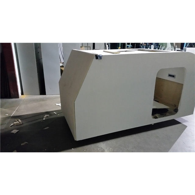

Postby cubbyboy57 » Fri May 20, 2016 8:48 pm

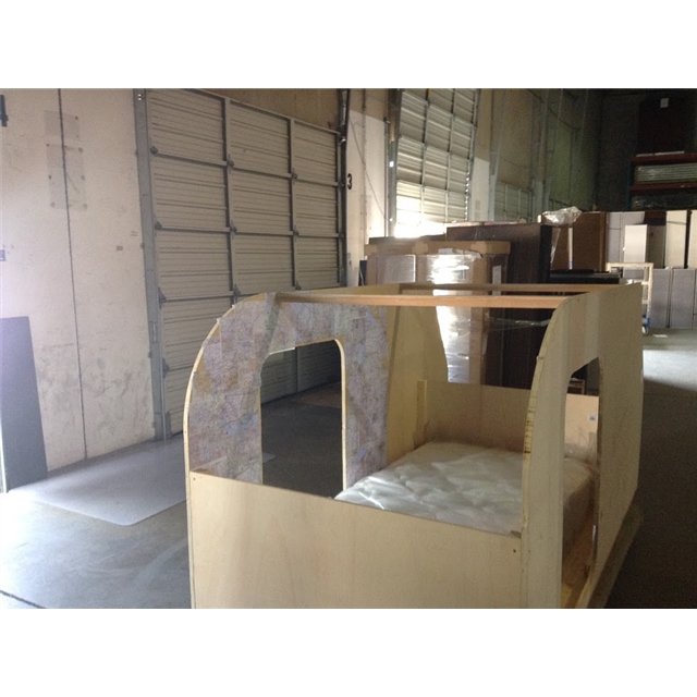

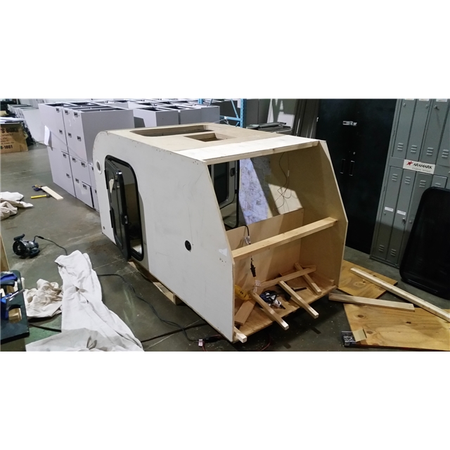

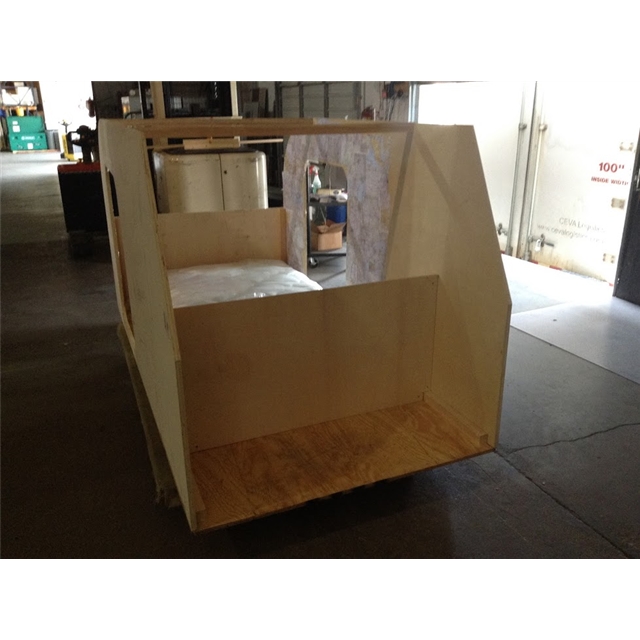

So I spent a few hours this week getting the sides up - looking forward to working this weekend on finishing the frame and maybe starting the canvas.

Postby greygoos » Fri May 20, 2016 9:31 pm
Looks like agood start. Good luck with your build

Postby TheOtherSean » Fri May 20, 2016 11:49 pm
Nice work! I hope I can accomplish that much this weekend.

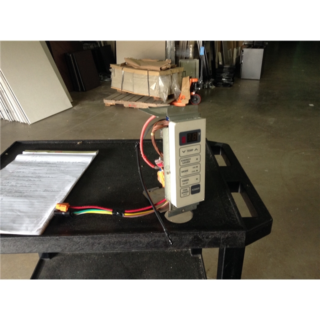

Postby cubbyboy57 » Sat May 28, 2016 8:09 pm

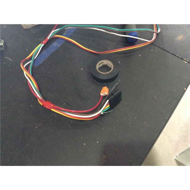

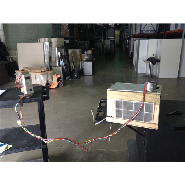

I got to where I was going to frame the AC and dug out the window unit a neighbor gave me a couple of years ago. I plugged it in and noticed something was rattling in the squirrel cage. I ended up disassembling the whole thing as it was full of dog hair, leaves, and dirt. Was contemplating purchasing a new $109 unit at Wallymart, but decided to save a few dollars and turn this one into a split system. I had to move 4 control wires and a compressor wire. Went to HF and got a trailer wire kit. I ordered some deck plate covers and 4in hose from Amazon.
A few more pictures of my hack job in the gallery.
Hope to finish this tomorrow and back to the trailer!

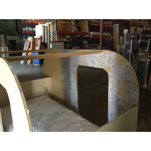

Postby cubbyboy57 » Tue Jun 07, 2016 8:42 pm

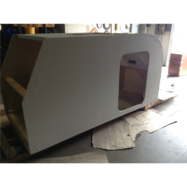

I have a new appreciation for the people who have documented their builds -- I always get too busy and forget to take pictures. I put in my FRP ceiling and insulated the roof. Finished the frame and started to glue the canvas on. Here are a couple of pictures and more in the gallery.

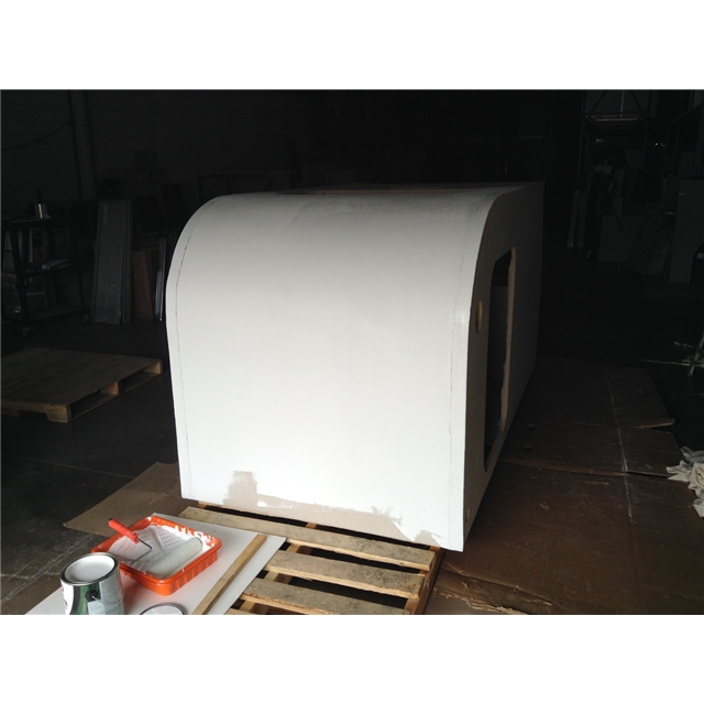

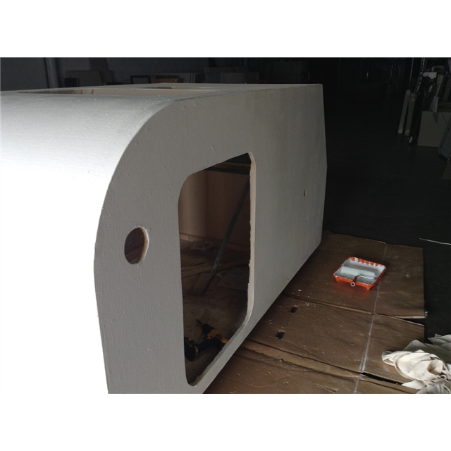

Postby cubbyboy57 » Sun Jun 12, 2016 7:56 pm
On to painting! Started sealing up the shell today.

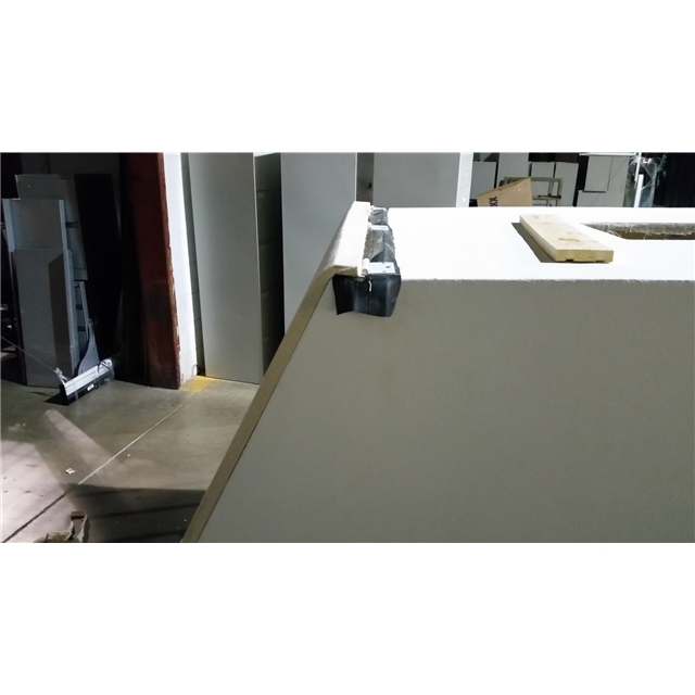

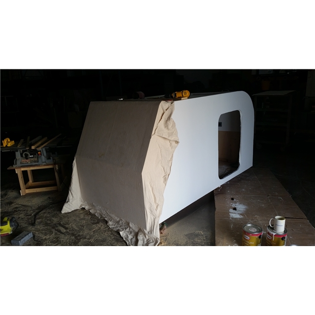

Postby cubbyboy57 » Mon Jul 04, 2016 9:06 pm

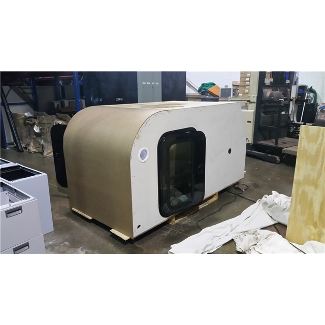

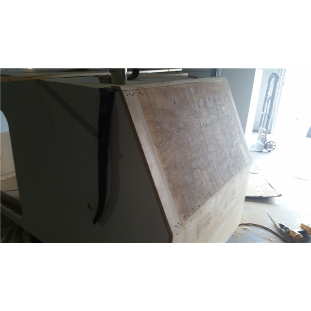

Work has picked up, so not getting much done lately -- finished priming and sanding and started painting the main box. This weekend hung the hatch and started canvas on it. Took a small break to grill some meat for my holiday lunch.

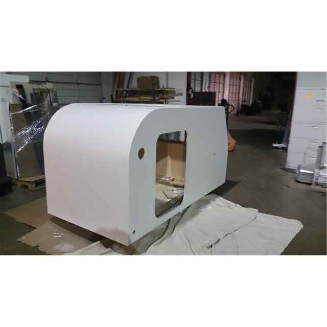

Postby cubbyboy57 » Mon Jul 04, 2016 9:09 pm

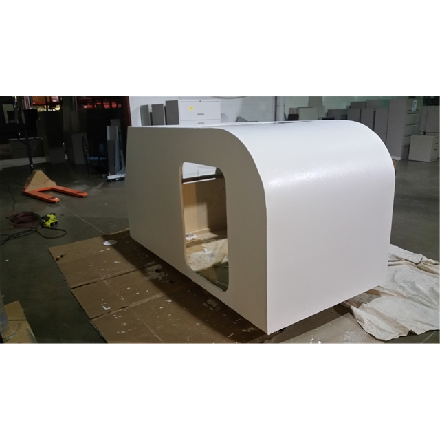

Here is the front of the box, couple of coats and I am done!

Postby greygoos » Tue Jul 05, 2016 9:06 am
Looking great. I like the canvas over the plywood, nice and smooth. n the last pic, is that a shadow or a stain on the bottom right corner?

Postby cubbyboy57 » Tue Jul 05, 2016 9:57 pm
That would be my fat head shadow - it is finishing nice, didn't know how forgiving the canvas would be but I like the ease and look of it. It is mainly Gripper so far, just got the first real paint coat on it.
I trimmed the hatch out and will start priming it this week.
