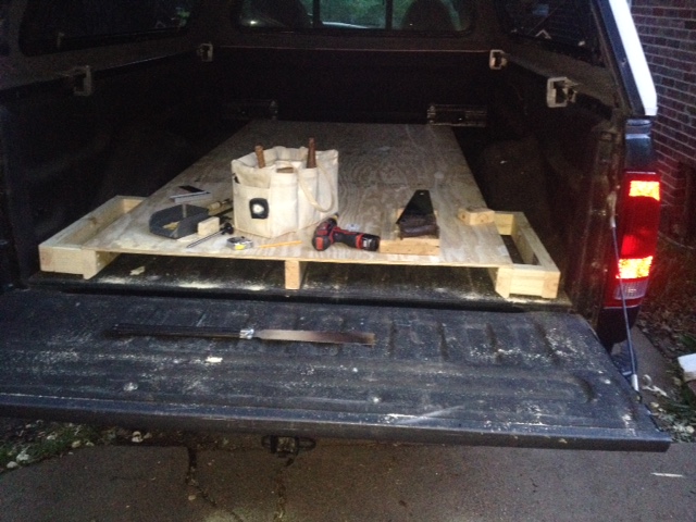

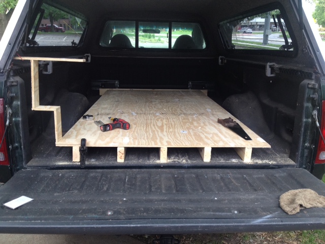

Postby rodtermaat » Mon May 23, 2016 2:13 pm

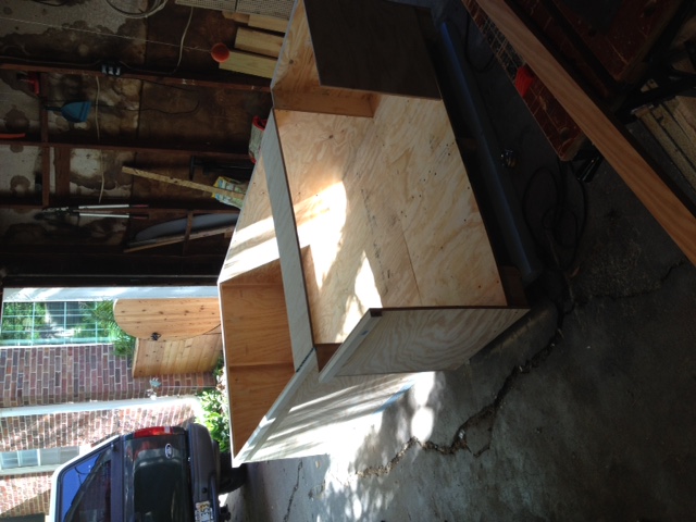

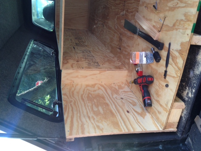

I made some initial progress on the camper this weekend. I started by building the foundation. I really need/want some basement storage for wood, my traveling shaving horse and pole lathe. Therefore I designed the base to allow for this.
My original thought was to use the more complicated lower half as depicted in the picture. The kick out above the wheel wells will be under the 2 beds and serve as storage with sliding doors. They will be at least 6 feel long and have something like 4" wide by 10 inches tall. Once I laid this out I came to the conclusion that if I moved the 2X4 framing to the outside of the 1/2" plywood I could attack the wall to the 2X4 substantially increasing the strength. I also realized that although I measured twice and cut once I still did not align with all the ripples in the truck bed. Furthermore at 48" the 2X4 on the outside edge would be mid ripple. I always like a chance to use my old school tools on todays projects, so out came the shaving horse to bevel the 2X4 so that everything would lay level and in between the ripples. After this remediation I could continue on with the plan to simplify the lower half to just straight side walls up to the edge of the cab bed and then build the storage compartments on the outside. This should increase the overall strength and greatly simplify the construction. I can then build the fake kick outs on the outside. I know this does not come across well in text, and I should have an updated pick later today.
I have a bit more work to do for clean up as I plan to have a cover plate in front to protect/secure the contents in the basement. More on that in the next post.
Question. Do you recommend that I use the mineral spirit / poly on all the wood here? I assume yes and that I should furthermore use the roof tar on the underside. I need to search out the exact product, but it would seem easier to do this now then further down the build.
Thanks for reading. rod

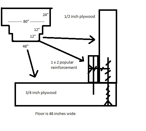

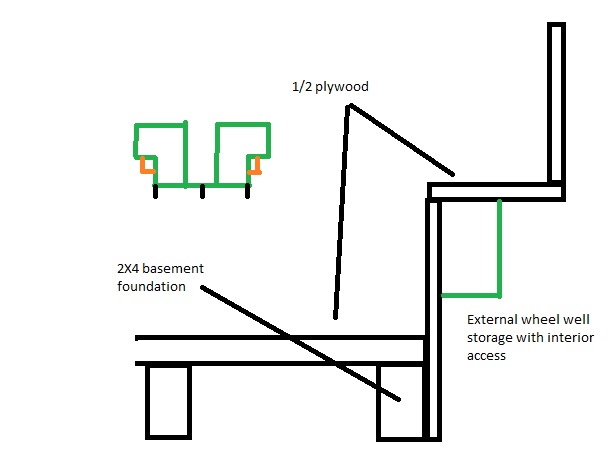

Postby rodtermaat » Mon May 23, 2016 2:28 pm
Hopefully this artistic rendition helps describe the simplified floor design. rod

Postby KCStudly » Mon May 23, 2016 3:11 pm
You could gain a lot of interior space if you only make the clearance for the wheel wells at and ahead of the wells. To the rear the slide in doesn't go far enough in that it has to clear the wheel wells.
Unless you want that space for "outside" storage.
As to the tar, I don't think I would put it on the sliders, too gummy. I would just knock all the corners off your cut ends, oil them up good (or use the mix) and consider them sacrificial.
Re: Truck camper build
Postby rodtermaat » Tue May 24, 2016 11:24 am
Thanks KCStudly. I will head your advice and modify the rear of the camper base/floor to include the kick outs. I think the added space will be helpful when building out the interior.
I made a bit of progress last night and hope to get these built tonight. So I might be able to send out a progress pic.

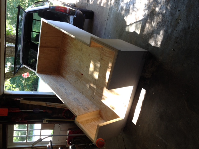

Postby rodtermaat » Sat May 28, 2016 11:27 pm
Our son goes to college in Phili and early this morning my wife and son left for the 23 hour drive. He has an internship in the city this summer and our 2 weeks with him came to a close today. Great to see him, I could not ask for a better son and future friend. He needs to car so my wife is driving out with him and flying back next Tuesday - leaving the car. This is some great mom and son time and I am rather jealous. Hopefully, I will get to go out and visit in late summer.
Enough sentimental talk. Their deparure meant unlimited truck camper building. Ok not unlimited as the Nebraska rainforest required some gutter work to decrease the amount of basement water intrusion. New house, new problems.

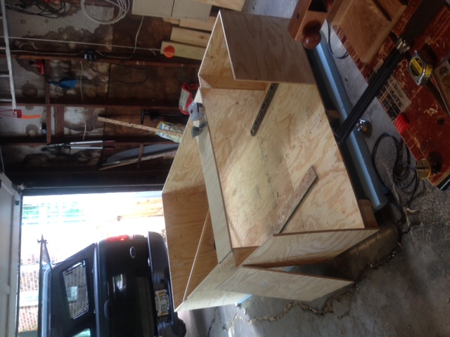

I spent most of the day building the lower half of the camper shell. here are the rear wings in place. Not a great look - I agree.
I removed said ugly base from my truck and spent the next 10 hours to get here.
I have most of the lower framing done. I will finish the rest tomorrow. I will then fill all the recessed screw holes with epoxy and prime the lower half. I was still able to rather easily get the camper back into my truck at the end of the day.
I still have tomorrow and Monday and my goal is to have a completed base. I cannot add the wings and complete the rear/front until mid June as I am going to a woodworking event in MN next weekend and need to have the topper to sleep in. This is the 10th annual Spoon Gathering in Milan MN and I would not miss it for the world. Yeah, we make wooden spoons, all 200 of us, try it, you will love it. I have been for every year and we have grown from 15 to almost 200 spoon carvers strong.
rod

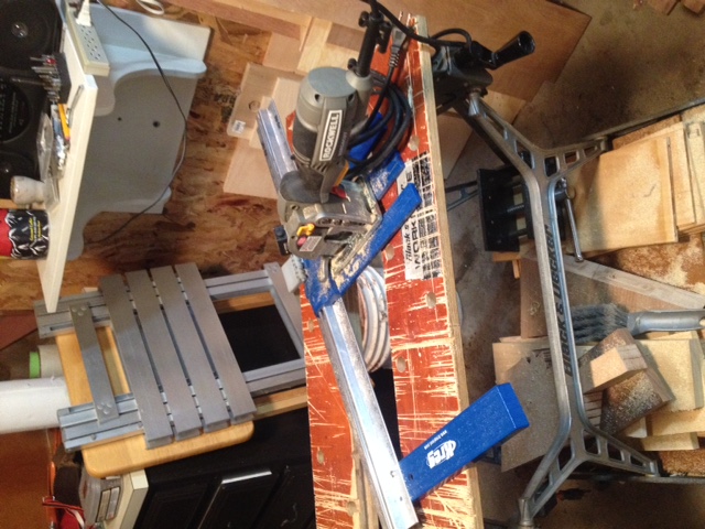

Finally, I cannot recommend the Kreg Skill saw attachment. I have not affiliation, but it has made cutting the sheet material was easy peasy. I a hand tool (no electricity) woodworker, but I could not do this build without a tool like this.

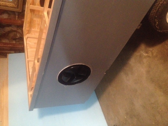

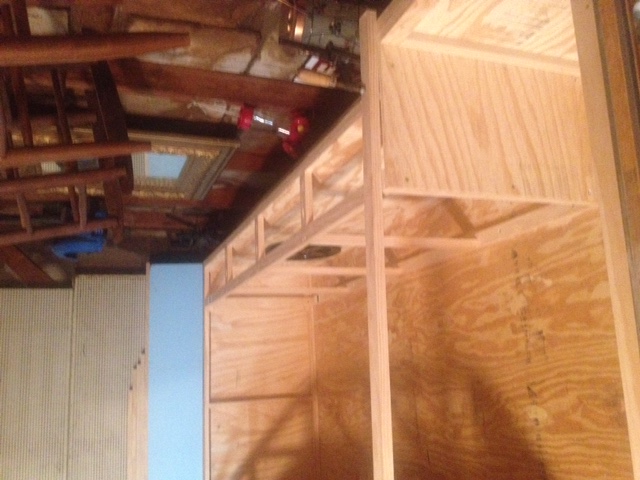

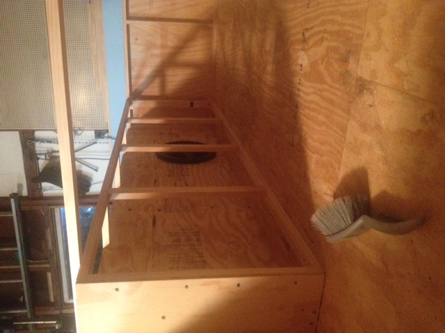

This last weekend I was able to frame out shall we say bed cabinets. They are 7 " wide and will be parallel to the 2 beds. The plan today is to have the wings extend out 12" past the base. Add the 7 " cabinets and a folding wind to complete the 30" bed leaves a little over a foot between the 2 beds. Not a lot of room, but enough to shimmy to the facilities.
The top will most likely be modeled after the truck camper/topper foam build by: viewtopic.php?f=55&t=64361 but without the cab over. Still need to work out the lifting mechanism, but all in good time.
The last picture is my chair hoarding. We recently downsized and our old house gobbled up my creations without issue. Our new house is a bit smaller and now the chairs have to reside in the workshop.
As always open to any advice and suggestions. rod
