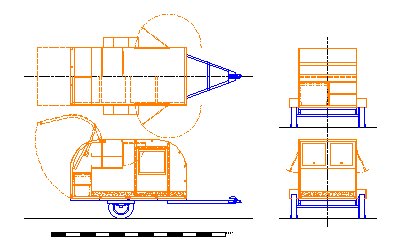

Postby greygoos » Thu Jun 30, 2016 7:45 pm
Started on a Rimple design.

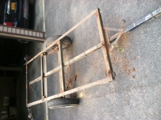

Postby greygoos » Thu Jun 30, 2016 8:00 pm
Progress is very slow due to other commitments. Will post as I go.Here is the trailer frame stripped and waiting for roll on bed liner.

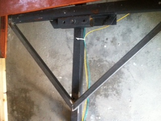

Postby greygoos » Thu Jun 30, 2016 8:08 pm
First coat of bedliner and A frame welded to tongue

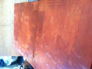

Postby greygoos » Thu Jun 30, 2016 8:09 pm
Here is deck upside down with 2 coats of the mix, 1 coat of 30 year deck stain and all the joints and edges fiberglassed. I ma using 3/4 plywood for the deck. Used butt joints as I cant handle a 5 X 10 sheet of ply.

Postby greygoos » Sun Jul 24, 2016 7:09 am
Deck upside down with Crack Filler. I am told it is better suited for road debris than roofing tar and I already had some. I am not advocating its use over roofing tar, whatever works for you is great. So the deck has 1 coat of deck stain, 2 coats of the mix, all the seams and edges are fiberglassed, and has asphalt coating. Talk about belt and suspenders!
new black.JPG (40.02 KiB) Viewed 1683 times

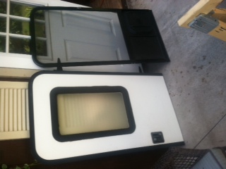

Re: Foam Rimple "Greygoos"
Postby greygoos » Thu Jul 28, 2016 9:27 pm
Cut down a door and door screen from an old camper today to fit my build. I purchased the door and 2 exit windows during the planning stage for 50.00.
greygoos
