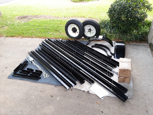

Two weeks ago I ordered the trailer kit and this morning I stopped by my friendly neighborhood NTE location and picked it up. It came in three boxes, two long narrow ones and another one for the tires, hitch, attachment hardware. None of them were light but I managed to get them into the truck and headed on home.
Since the two long boxes were both somewhat torn up I decided to open everything up and check all the parts against the parts list. Everyone does that, right? Well, everything appears to be there although one of the cross rails was slightly bent.
Since I had everything all spread out in the driveway anyways I might as well get started and see just how bad the directions really are. I've read several comments about these kit assembly instructions. The writer obviously assumed an experienced audience and the drawings are a little small but I think I am doing okay until I notice that I am assembling it right side up instead of upside down as they show in the picture but failed to mention in the text. Hmm. Side rails and five cross rails and it is already too heavy to flip over on my own. Now where did I put that teenage son of mine. Okay, now I can continue. BTW - that slightly bent cross rail (you can see it in the picture) was successfully beaten back into shape with a rubber mallet. I will leave all the bolts loose until I get the floor built so I can be sure everything is nice and square.
Lessons learned today:
1. Assemble the trailer on a soft surface, like the lawn, so it does not get all scratched up as you drag the pieces around.
2. Nuts, bolts, and washers are hard to find if you drop them in the grass.
3. Have someone nearby to assist with moving heavy assemblies around.

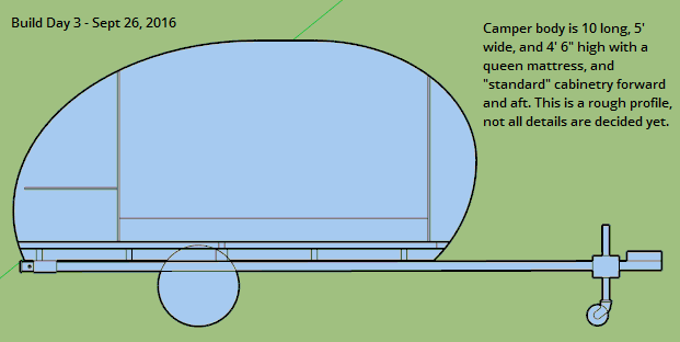

Wow! It's been a month since I last posted. Where has the time gone? Well, Learning Curve has progressed. On day 2 I finished assembling the trailer frame. On day 3 I got all the lights wired up and I got it registered and titled.
While looking over the plans for the camper my wife asked about our ability to bring our bikes along on camping trips. I agreed that that would be a nice feature so before I have even cut the first piece of wood I have a project upgrade to work on.
The current NTE 5x8 trailer design has a v-shaped tongue that ties into the rectangular frame at the first and second cross frame members. Several builders here have mentioned that this seems a little weak and a little too flexible and our bike rack attaches via a 2" receiver hitch so I have decided to buy a 14' length of 2.5" square steel tube and run it the entire length of the frame from the rearmost cross member forward between the two angled pieces of the original tongue and out another 24" from the original hitch position. At the aft end of this long tube I will add a receiver hitch for the bike rack.
I drove the trailer down to NTE in Austin and picked up a 6" length of receiver tube and a rotating caster wheel for the front of the trailer and then I drove to Metals4U and got some steel tubing for the rest of this upgrade. My neighbor has agreed to assist with welding the receiver tube to the 14' tube then I'll either drill some holes in this assembly and bolt it onto the trailer frame or we will weld it on. I haven't decided yet which way I will go for attachment.

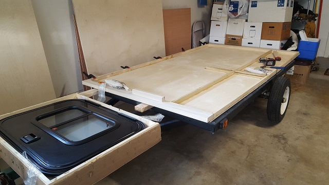

Today I actually worked on the build! I laid a couple 2x4's down on the frame and the laid out the bottom of the floor panel and the framing for the foam sandwich.

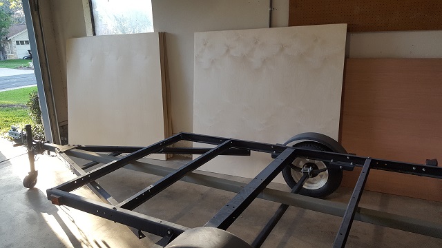

Today was Mother's Day so I didn't get too much done today. I did drill out some cavities on the underside of the floor so that it would rest flat on the trailer frame with the bolted-together frame's bolt heads recessed into the floor. I also started gluing up the frame layer between the floor's top and bottom. The top and bottom layers are both 1/2" baltic birch plywood and the frame will be 3/4" by 1.5" poplar on edge with 1.5" XPS foam filling the cavities for insulation. I have decided to use epoxy for almost all my gluing on the project. It is more expensive but also can be used for more, if not all, of the bonded joints I need to make as well as being used on the fiberglass roof.

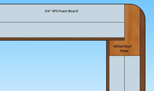

This is why I call it a learning curve. I'll make up for it by not having any ply in the roof, well, just a single layer of 1/8" for a headliner, covered by foam and fiberglass.

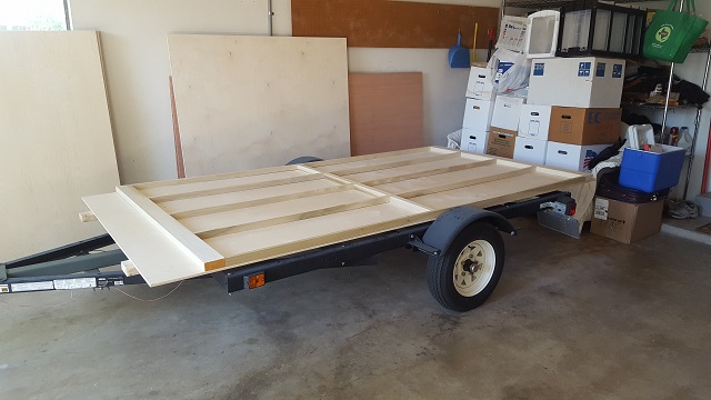

I put in about an hour on LC after work day and got a few more of the floor inner frame pieces epoxied into place. I'm still looking for some 4x8 sheets of 1.5" XPS for the insulation. If I don't find a local supplier soon I might have to buy some 1/2" sheets at Lowe's or HD and layer them in just to keep making forward progress on the floor.

Woo hoo! The doors from Challenger Door Co. arrived today! After gazing fondly upon them for a bit I managed to get another hour in epoxying in some more of the floor framing.

Today I finished epoxying in the last of the floor's framing layer pieces and started cutting out and fitting in sheets of 3/4" XPS insulation.
I still have not found a local source for 1.5" thick XPS so I am using two layers of 3/4" thick panels from Lowe's. Unfortunately, the 3/4" panels are actually 0.8" thick so I will have to sand all the insulation panels down level with the poplar framing pieces before I can glue down the floor's top layer of plywood. That sucks but at least the XPS sands down fairly easily. Still, it will create quite a mess of XPS "dust". I think it is time to invest in a good filter/mask.
