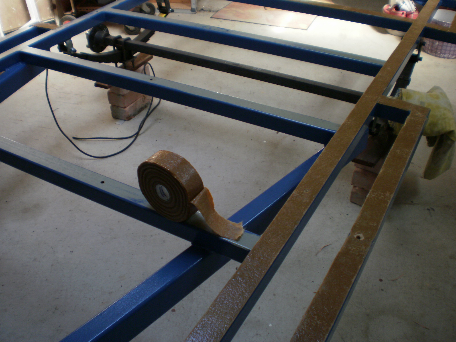

The trailer has been grit blasted to Class 2.5 and primed with an epoxy primer. I then top coated it with an oil based enamel.
I placed Denso tape over the trailer bearers and then laid a 0.42bmt galvanised sheet on top of the Denso. This is to provide a waterproof barrier to the underside of the trailer.

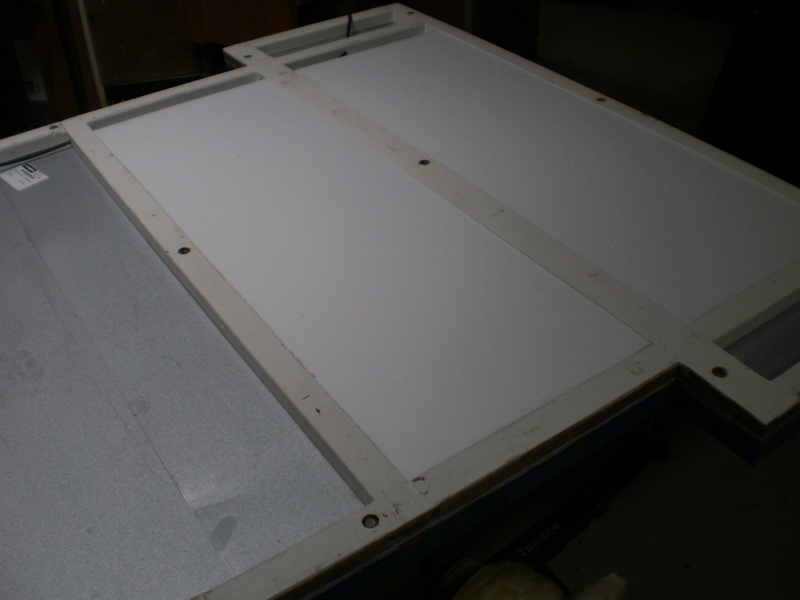

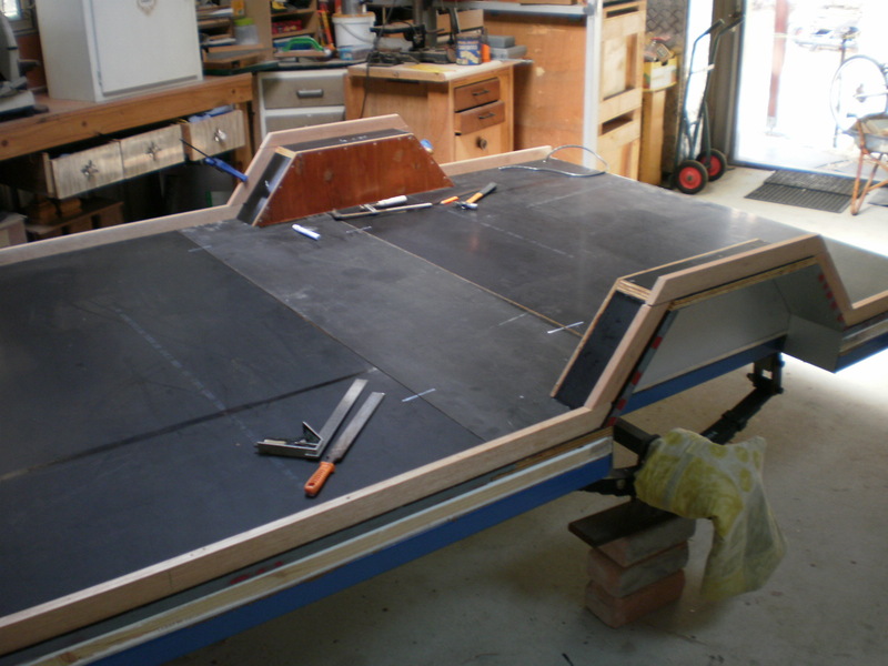

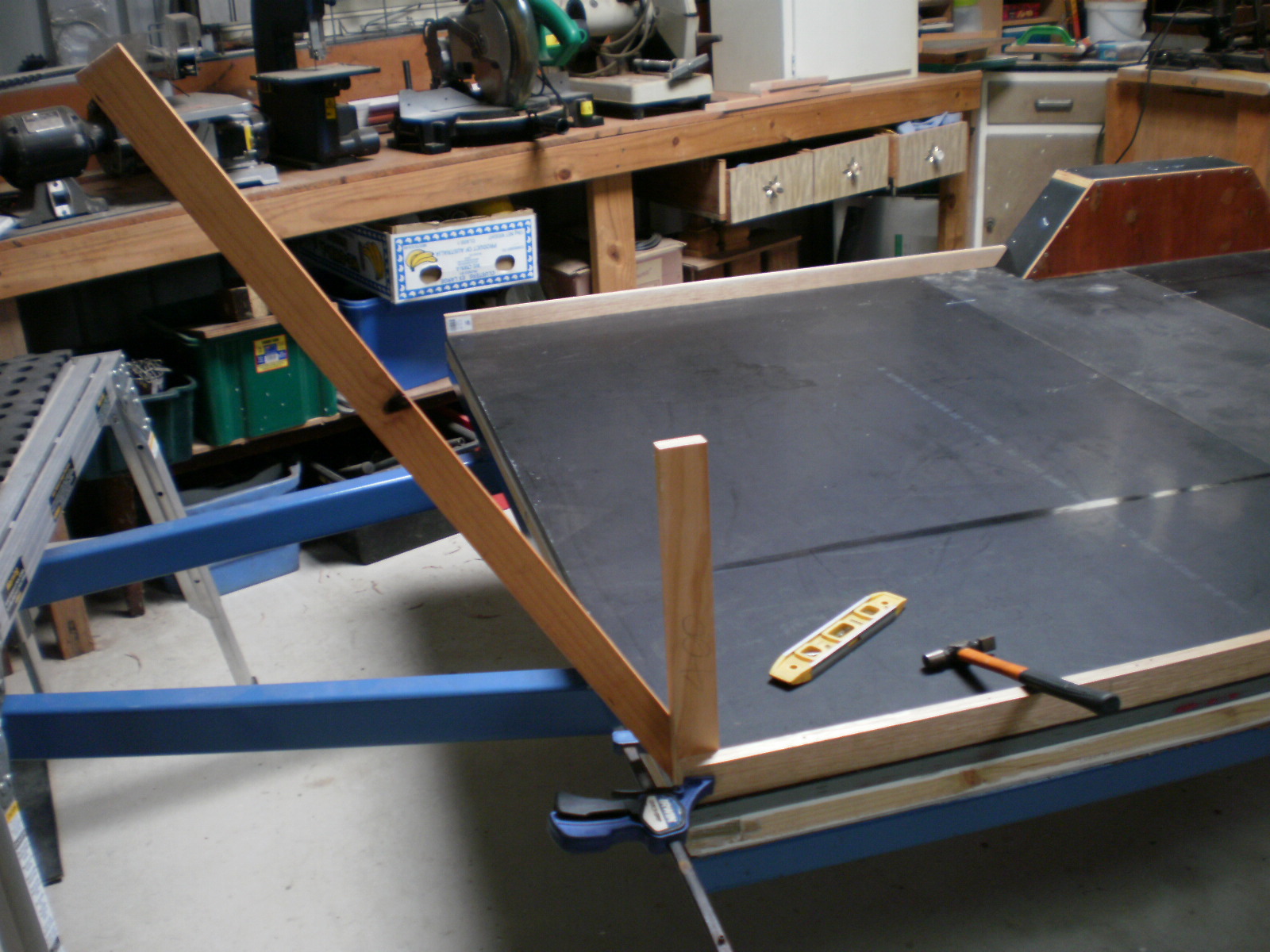

Next was a 35mm sub frame from CCA treated pine with polystyrene foam infill over the galvanised sheeting. Should be OK for insulation.
The floor is made from 17mm Formply (used for concrete formwork and has an impregnated paper surface to protect the ply). A bit heavy but it suited my purpose.

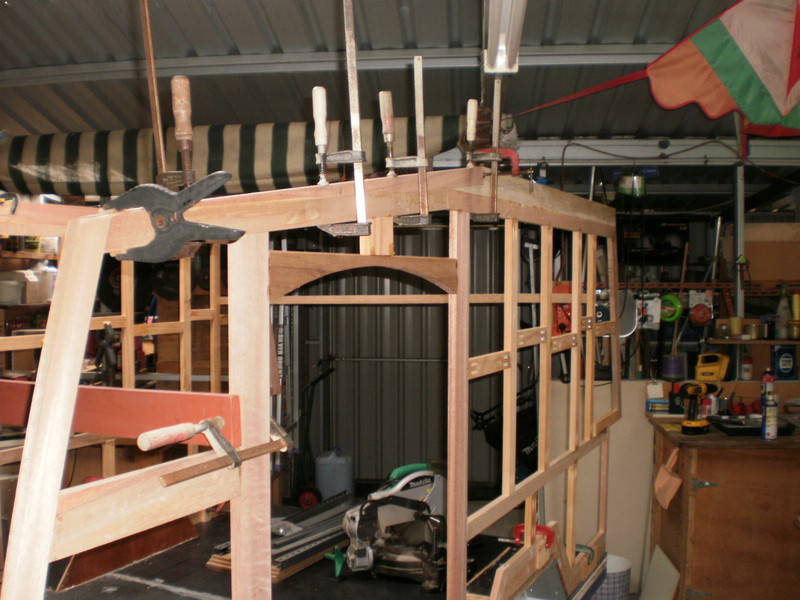

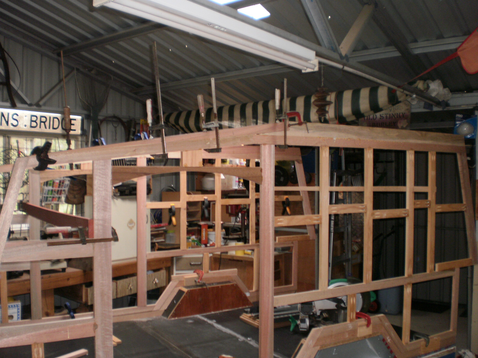

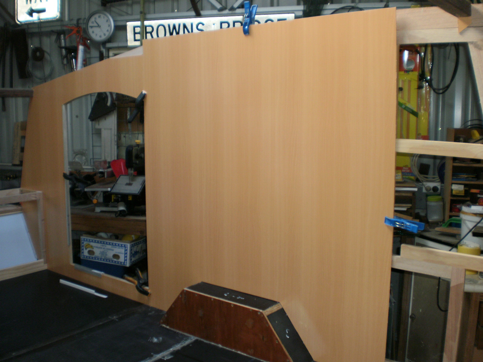

I then set about fabricating the walls from 42mm x 19mm timber. It was a mixture of pine and meranti, basically whatever I had lying around my shed. The profile has evolved over a few weeks. At first I thought it looked "squat" so I raised the height slightly and am now pleased with the overall look. I have purchased several sheets of "caravan ply" which has a veneer similar to birch and was quite cheap at a salvage yard (AUD$12 per sheet). I am using it for the interior lining. The exterior will be clad with 6mm marine ply.

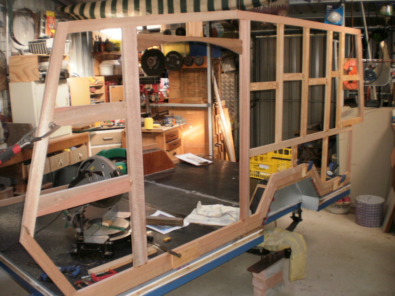

The side profile after a few modifications
Interior lining commenced
The bulkhead wall has been installed and the front window placed for a photo.

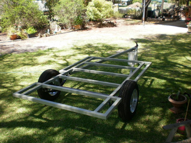

I worked out a floor plan for my requirements and then designed a trailer to suit the floor plan. You can't go wrong using 50 x 3mm SHS for the frame and then a 75 x 50 x 4mm SHS for the drawbar. That will give you plenty of strength. Also talk to the fabricator as they have plenty of experience as well as engineering expertise to keep you on the right track.

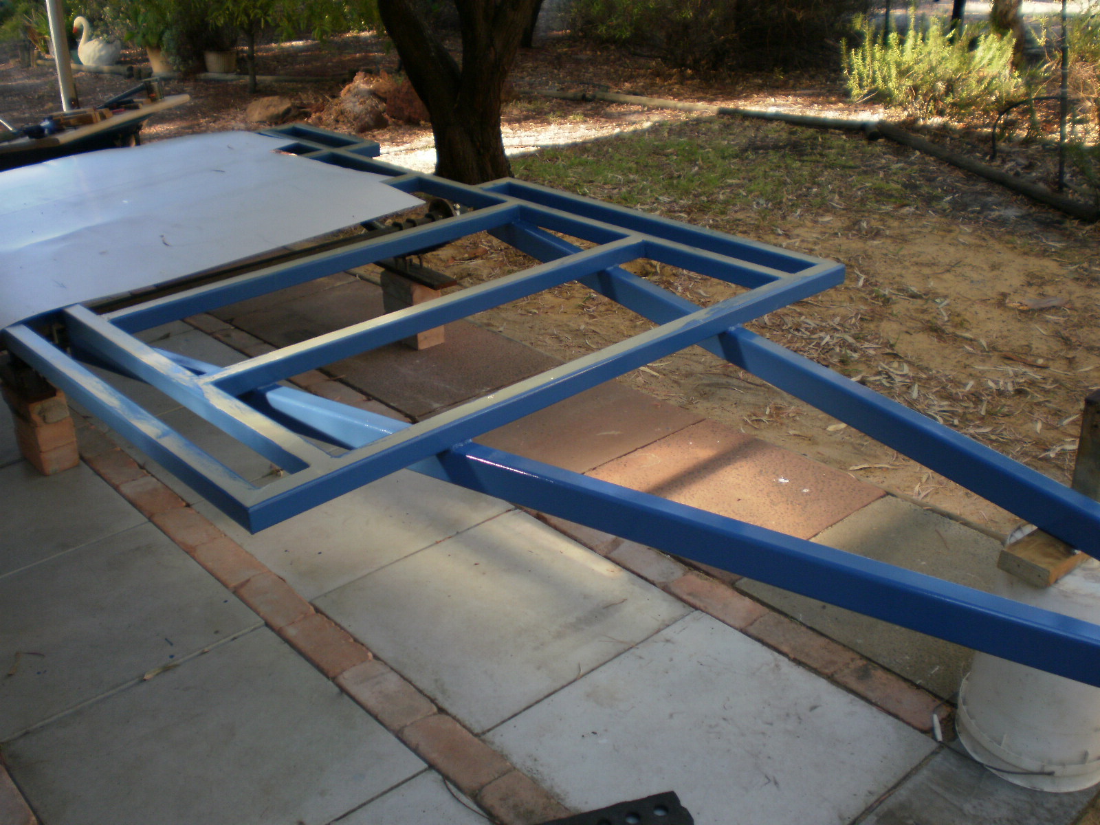

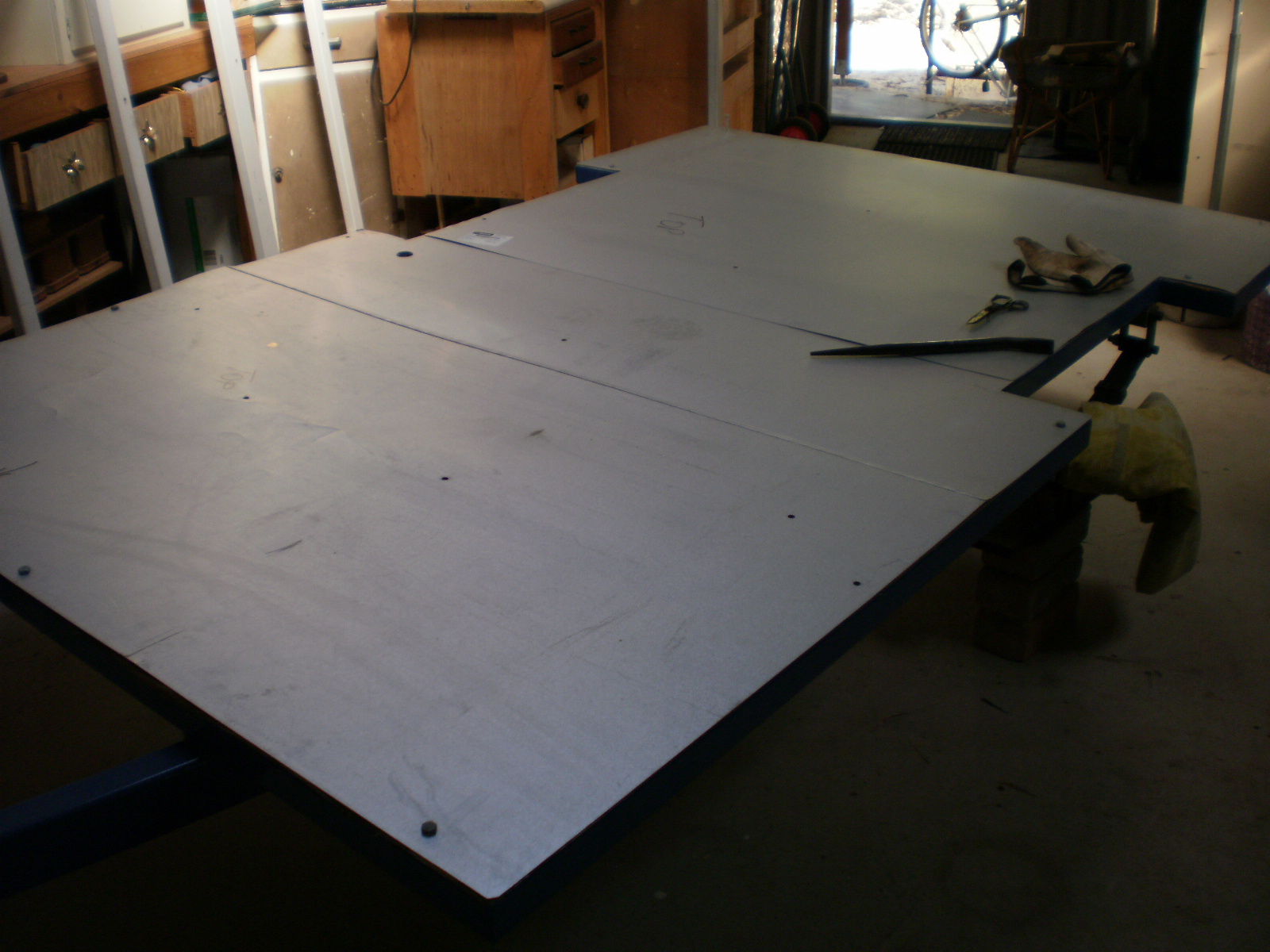

Trailer, as fabricated

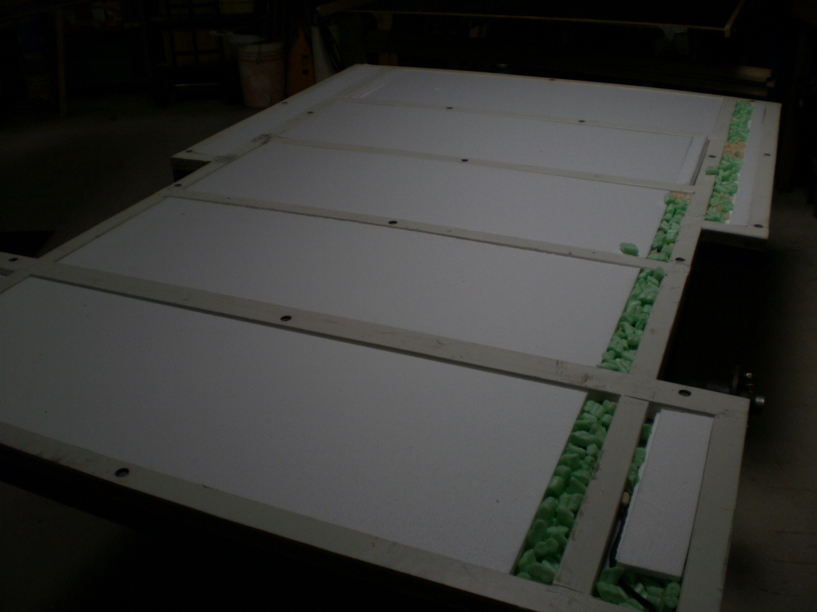

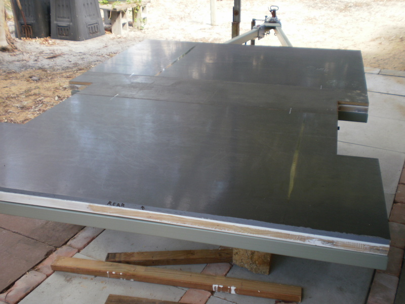

Underside sheet metal skin, floor frame and 40mm polystyrene insulation
Floor made from 17mm form ply

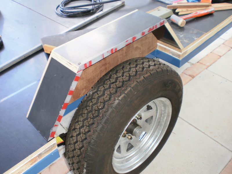

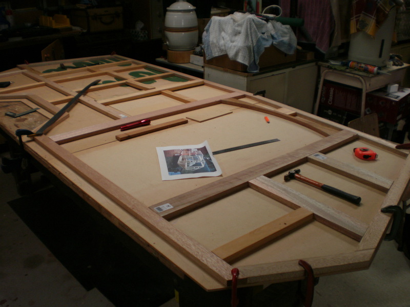

Wheel arches

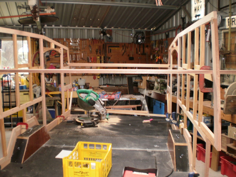

Commencing the wall frames
Laying out wall frames

Install the wall frames
Wall frames set
The trailer appeared to be too "squat" so I added 90mm to the top of the walls
