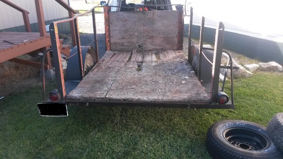

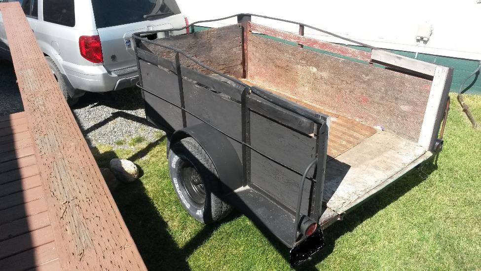

Anyway, on to pictures of the trailer so far.
Here's the starting point.
Sideboards removed. Isn't that a nice floor?

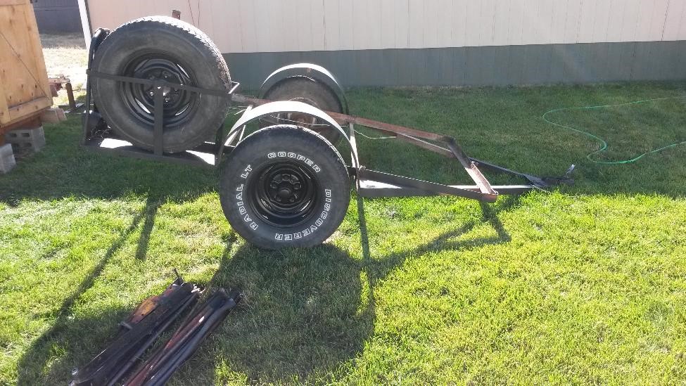

Side frame gone.
