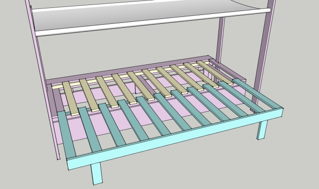

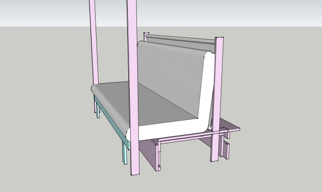

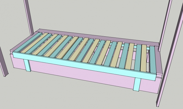

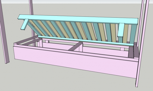

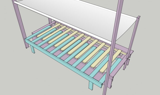

What I've come up with can be a full time twin, full time double, a bench, or a futon depending on what I anticipate my needs to be for an individual trip, all with access to storage below and a sleep or storage loft. I'll build with foam where appropriate to save on weight and beef it up with 2x4s where needed, the Sketchup doesn't show final lumber dimensions. I got the idea for this from a DIY RV website.
The slats pulled out to fit a full size mattress, hammock loft shown in place.
The slats pushed back to fit a twin size mattress, hammock loft shown in place.

Hinged storage access.
The futon takes shape when the front hammock pole is put into a 3rd set of brackets near the top of the bed frame to form a back rest.

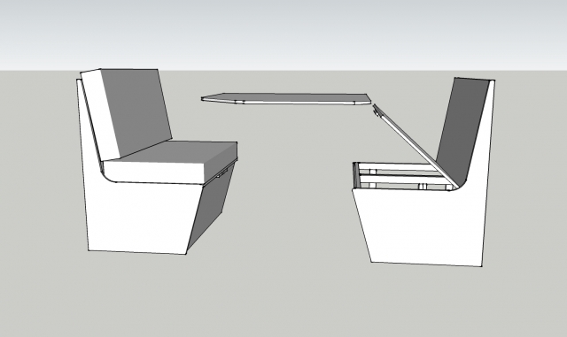

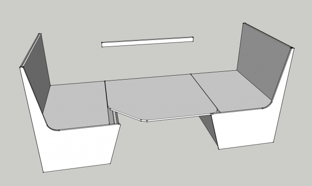

Here's a couple pictures of the berth design. I saw this online somewhere and adapted for my build.
In dinette mode showing storage access. I will use an RV table support; didn't draw it for my plans, that's pretty straightforward so no need.
In bed mode, sans cushions. There will be hinges between the top of the back rest and the wall and hinges between the back rest and the seat bottom to allow the whole thing to slide back and the table to drop down and fill in the gap.
And that's it for sleeping, I'll be able to sleep 3-4 people.
